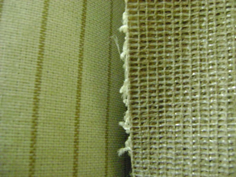

Regardless of style and color invest in a good backing and a quality padding. The backing is what gives the carpet the dimensional stability and holds stretch. A good backign will have a high pick count. In other words the smaller the gaps between the crisscrossing wires the better. Avoid the felt back carpets. These were designed to benefet the installer only and usually hide a low pick back.
Here is an example of a low pick back on the right and a Karastan high pick back on the left:
