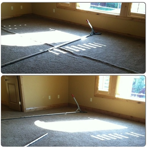

I wonder if it would work on wrinkles like this:

That's the kind of re-stretch we all love, Charlie! And the answer is yes, it works great on jobs like that and in half the time. For instance, an average house that used to take Mario 4 hours to do the whole job, start to finish, now takes him about 1 1/2 hours. And Mario is 70 years old! We have never had a recall yet!
