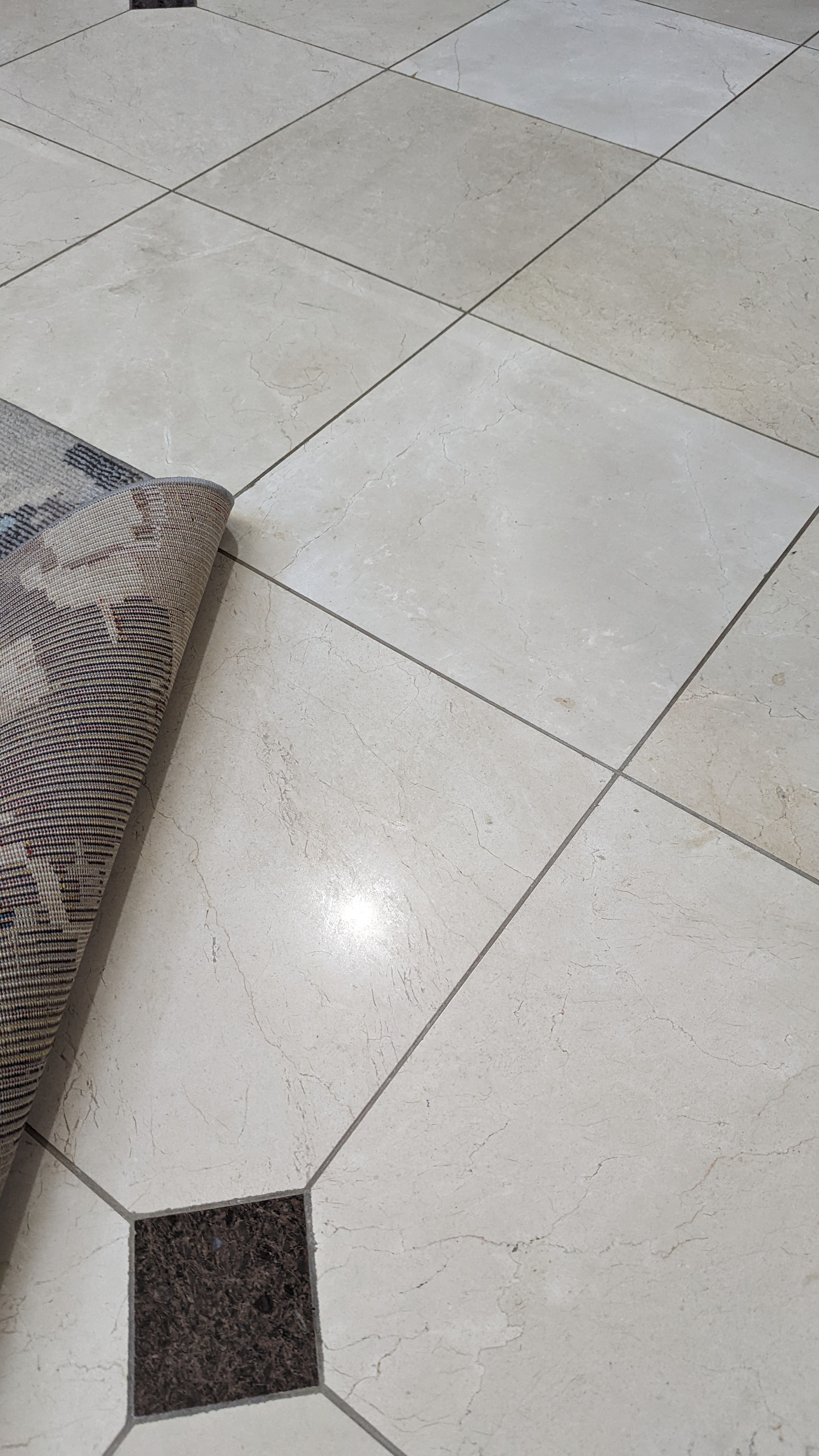

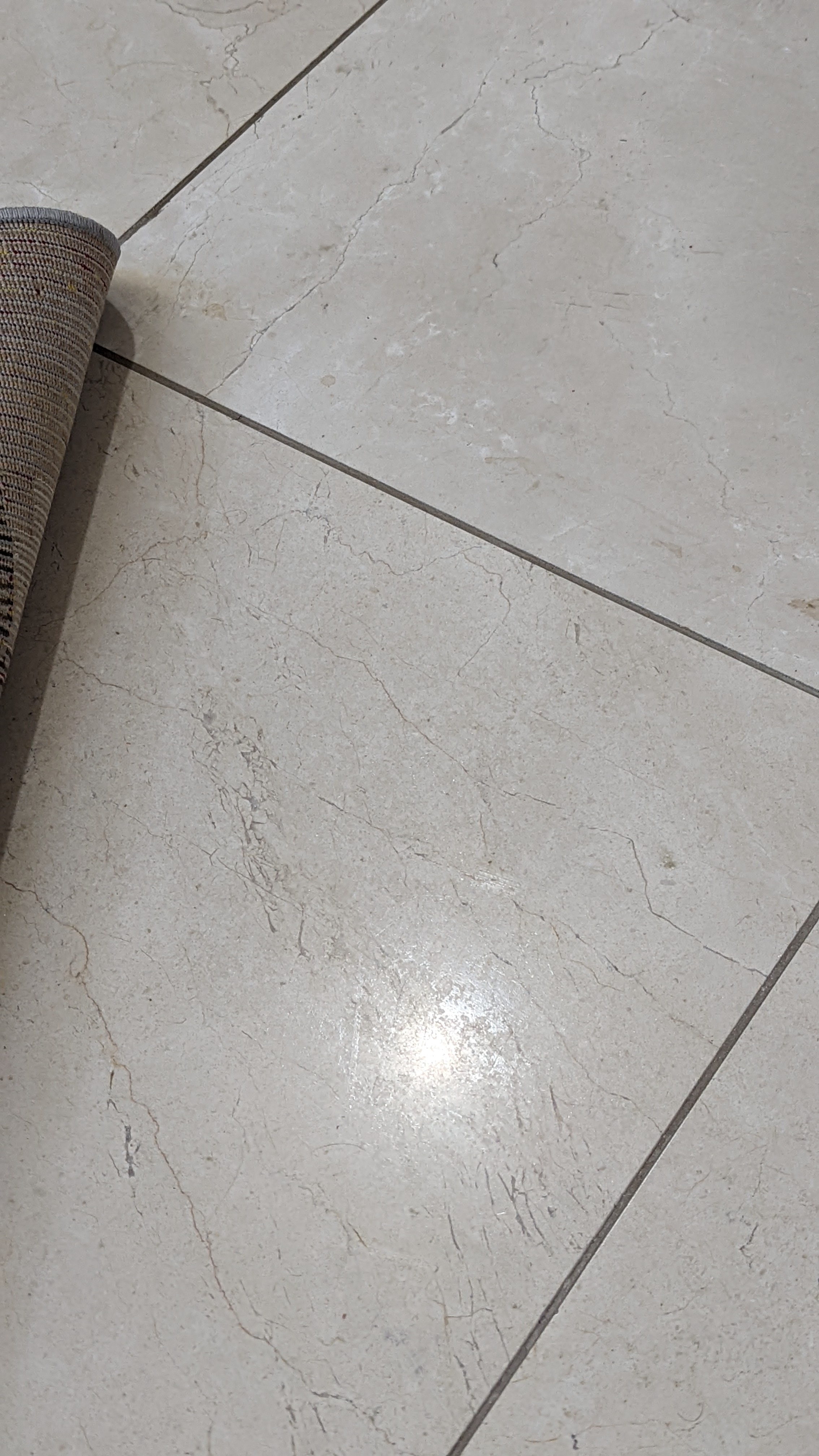

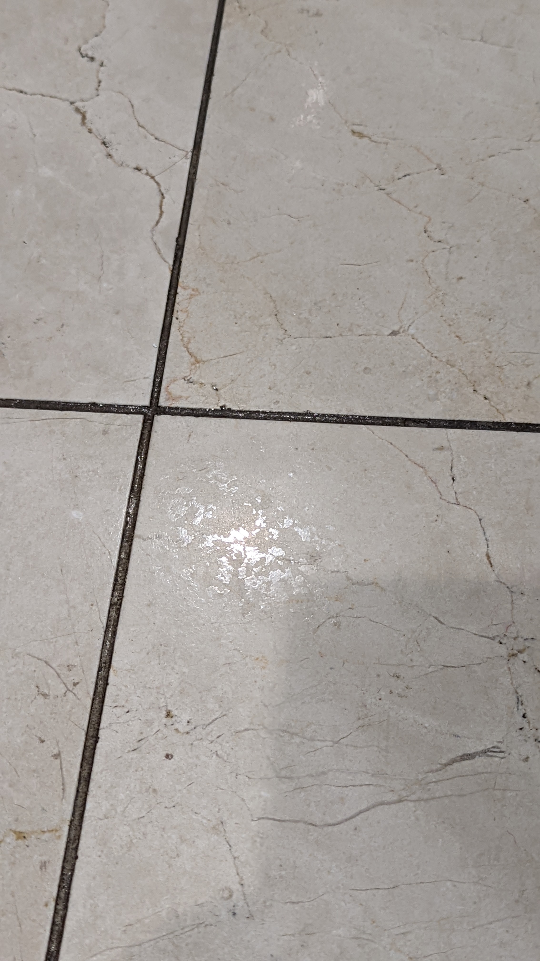

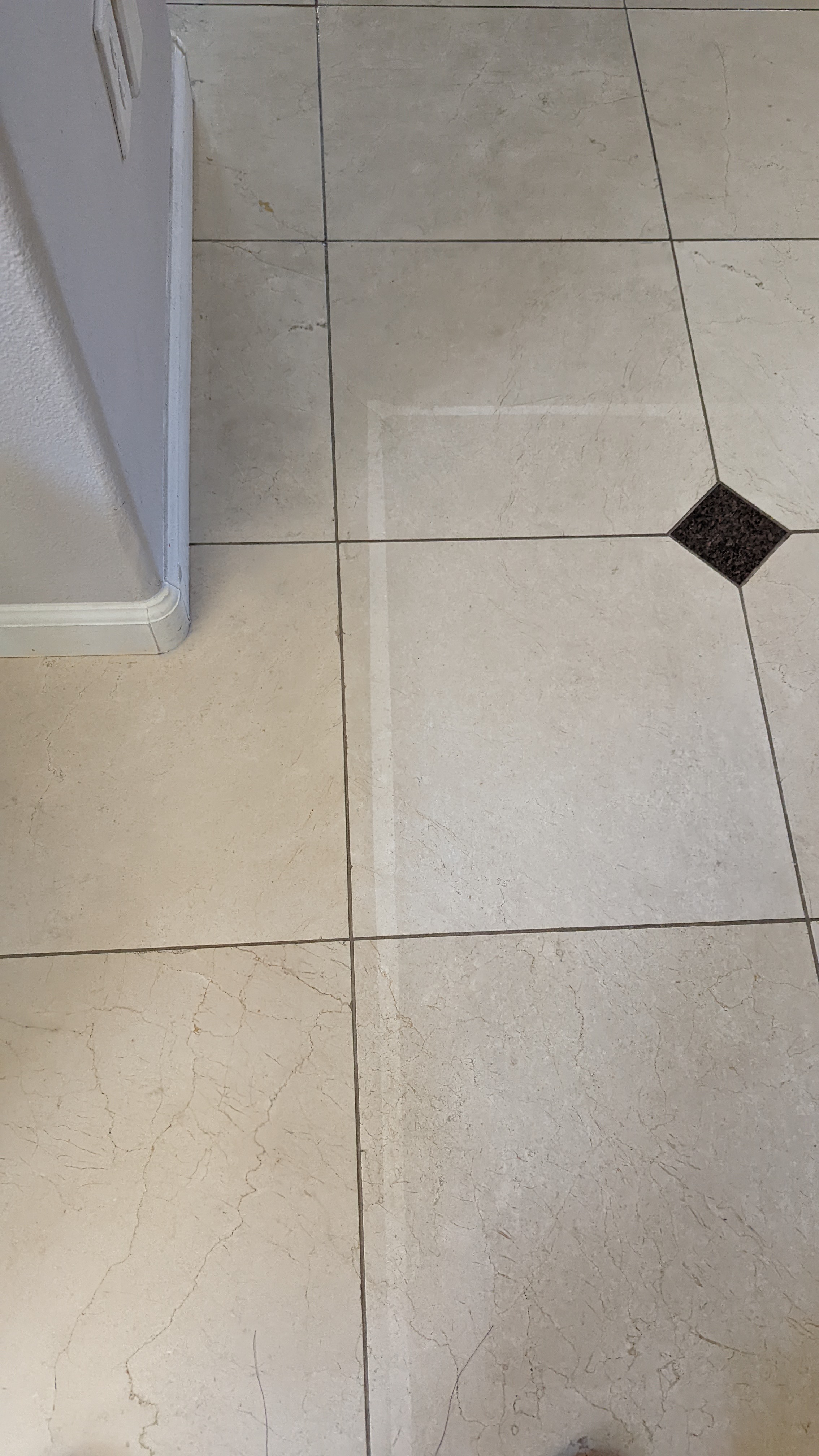

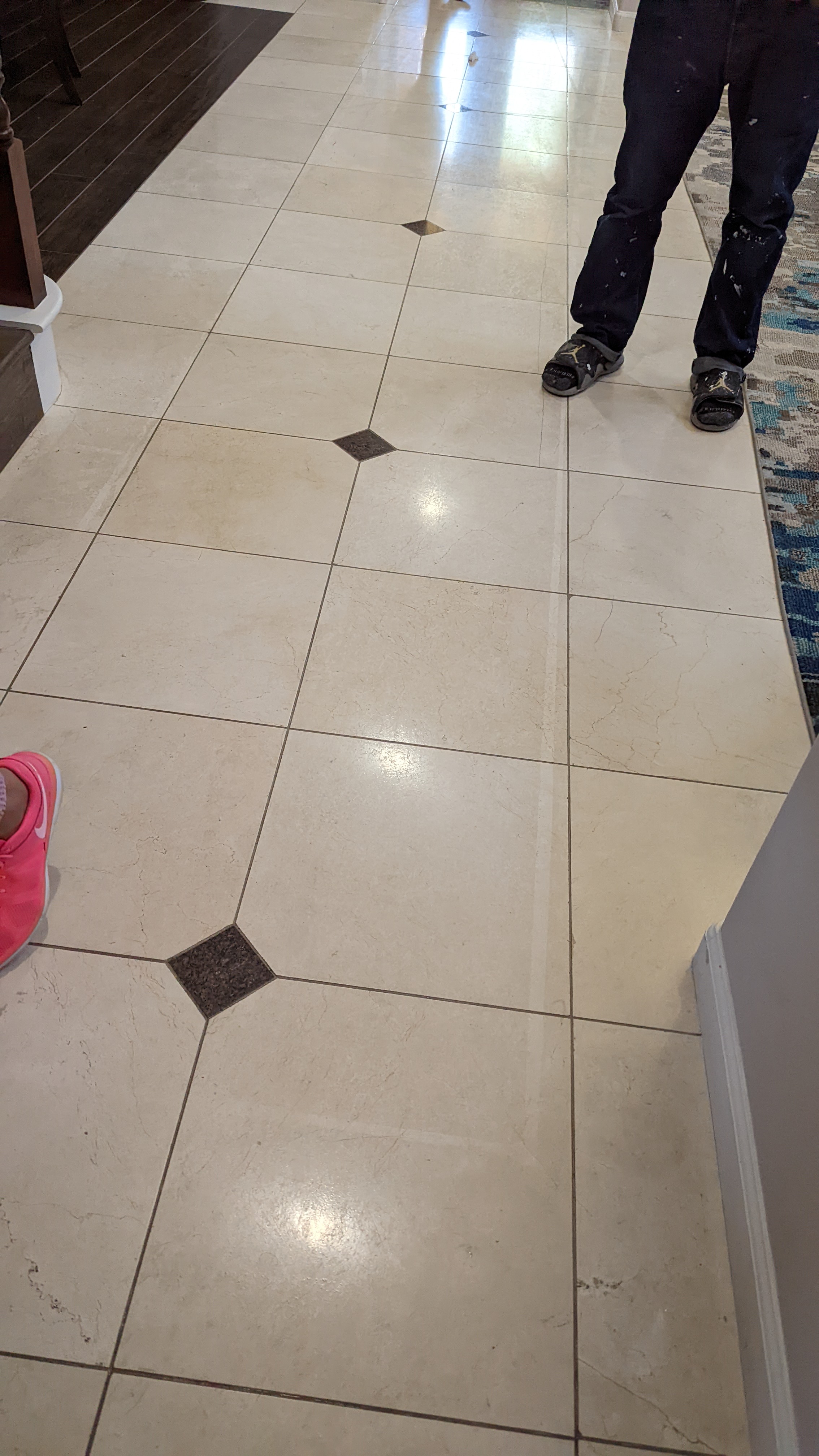

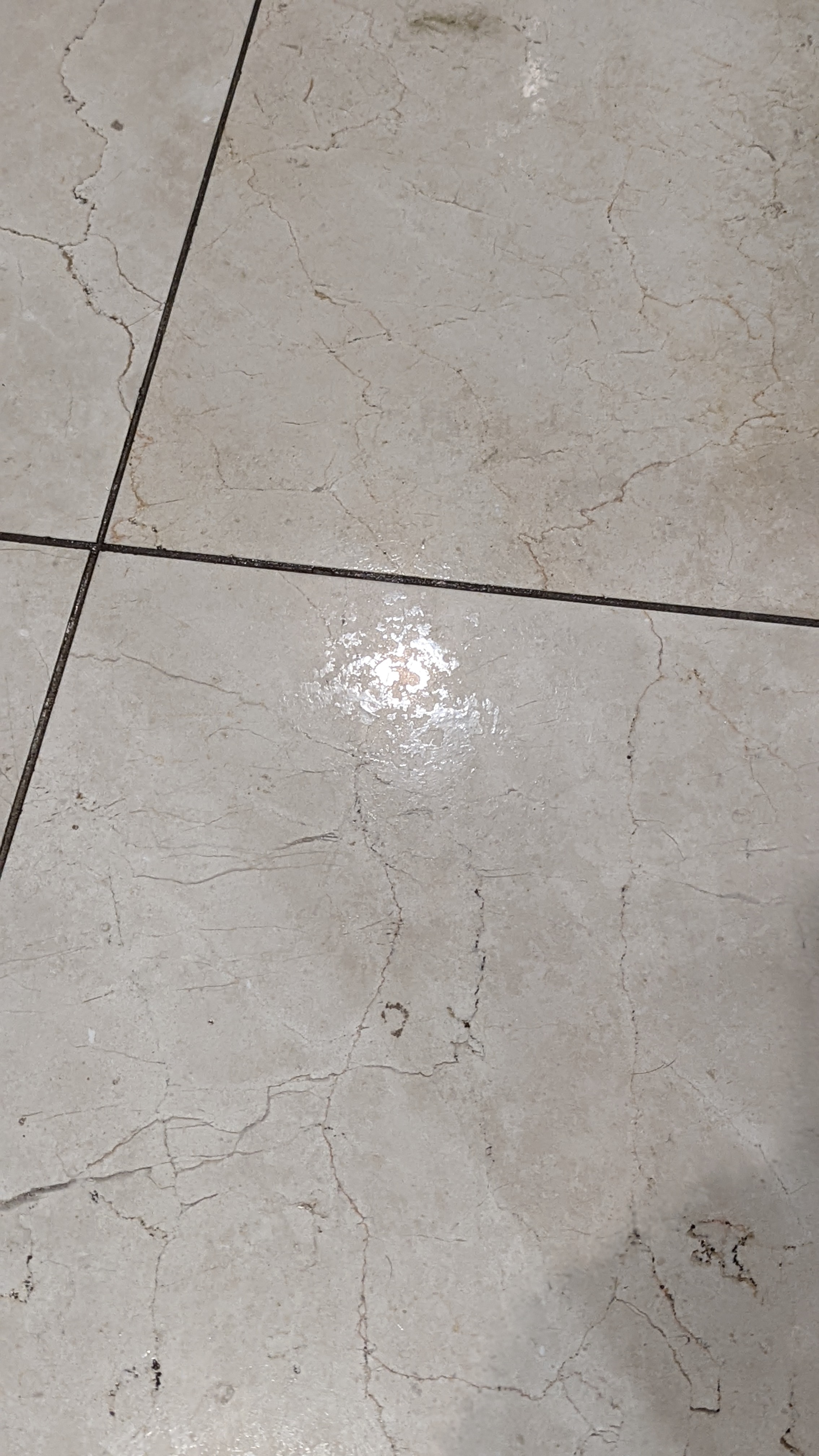

Had a bathroom remodel company put tape on marble to secure the protective cover.
There was a topical that peeled off when they did clean up.
You could see peel all over the floor.
I said it all needed to be stripped and recoated.
But it looked like it was failing all over the home owner was super pissed said I was stupid it wasn't marble.
And wanted the company to fix it.
I put a little stripper and it came off.
I walked out was tempted to sock a liar in the face.
