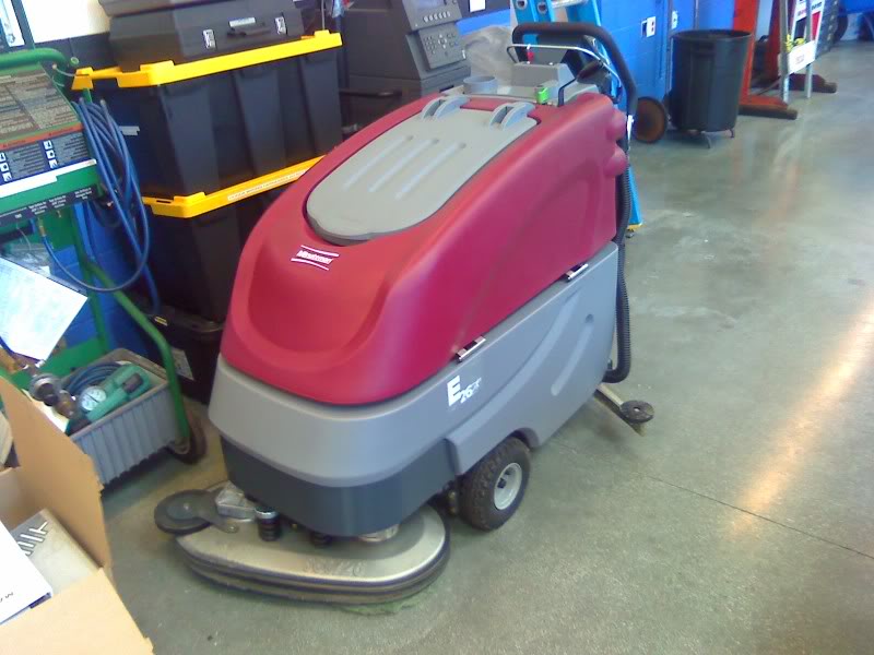

What can you Janitors tell me about this machine?
116,117
I have a Auto Dealership that bought one to maintain their new tile floors.
Will it work on grout that's normally recessed?
