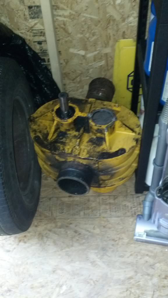

OG 6008 blower is done.
Lower seal popped out when greasing the bitch today.
and now the shaft has some wiggle in it.
My N#$@** rigged bearing fix held but I think it's time to put in the virgin blower.
Lunchpail to the rescue.
what is it with these POS Vortexes?

My thoughts on the short life of V blowers.
Talking to AT today, they said the manufacturer thinks 6000 hours is about all to be expected considering the design and use.
On the 6008 series Vs they were designed ( almost looks intentionally :shock: ) to drip grease from the shaft side down on to the lower PTO shaft pulley. Most V newbs thinks it's loose belts causing them to slip as the grease is so little you can't see it,, so the belt get over tightened. If you find the boards and read about the issue or have a good eye than you put hoses on the weep holes and channel to grease elsewhere and slacken the belts. Overly tight belts lead to short bearing life
Most V owners run there blower over 15 inches of lift so the unit runs hotter....Not good for the blower..

116,017
my new blower was built with the pulley shaft on the right side so it will have to be flipped upside down.
Now I'll be greasing the bearings from the out side in, if that makes sense...
should help keep the non drive side bearing in place, if greasing was what caused the last one to start moving off the shaft.
