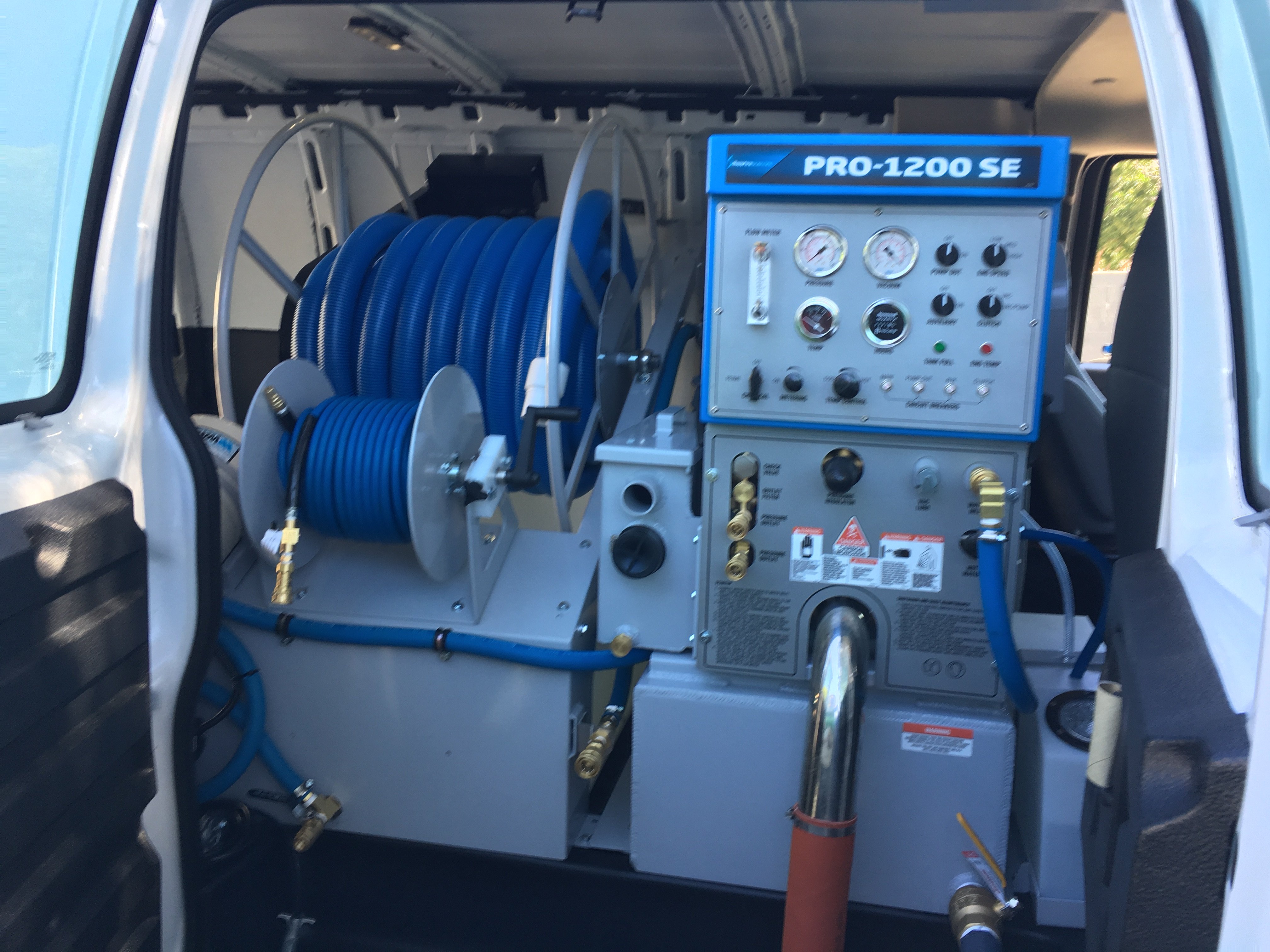

I drain my machine and went to move my pro1200 2016 24k Miles van and it won’t start!
So I go and fill a gas can and come home and add 2.5 gal of gas and nothing dead turns over no ignition.
I’m feeling my fuel pump went out! @Nomad74 you bastard!
I call AAA and get ready to tow her to the dealership and get Saigered in the Butt! AkA Christined!
I go out one more time and it starts!
Wife says take it it when it slow, I’m worried if it does it again!
Why oh why did it not start???
The check
Engine lights been on say replace gas cap!
I did and it’s still on, I figure it’s sucking air somewhere.
Oh the joy of carpet cleaning!
I do love my direct drive!
Pray I get it to the shop before anything bad happens!
The check
