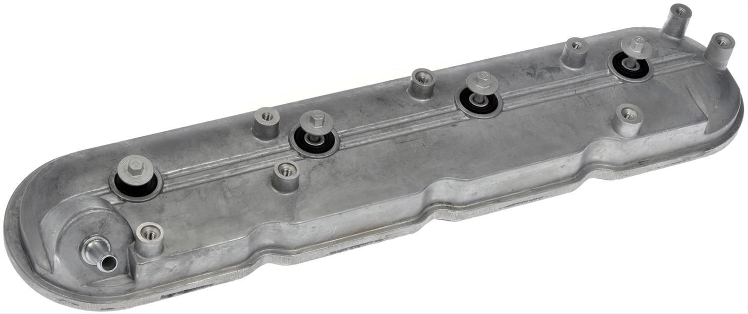

9,552
I remember reading you flying off the handles regarding spark plug's for the PC Everest 650..
The valve cover is a bit over priced fwiw..
I'm just being a jackass and glad you're back up and running sMatty boy!

14,079
dude, I still get hot when I think of what they charged me for those spark plugs
