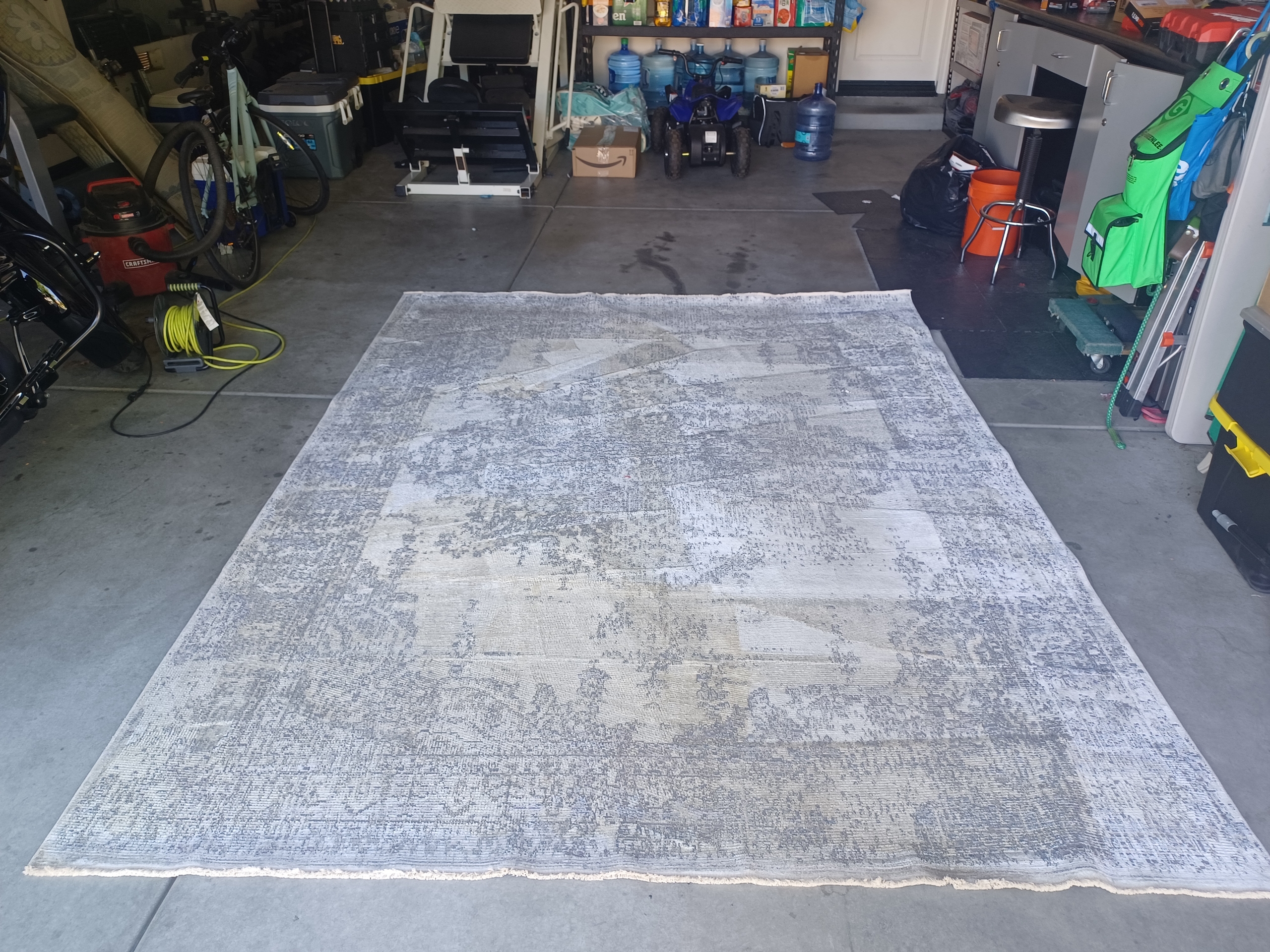

We ruined this rug
Mr Brightside
May 4, 2019
908
Southern Cali
Jay Wags
6,972
San Francisco, CA.
IMO It's not ruined.- We clean them often.
apply brown-out treatment, aka Coffee remover aka Haitian cotton cleaner. Dwell until browning disappears. rinse again with less water and Remove ALL the water. speed dry with fans, hot room, dehues.
