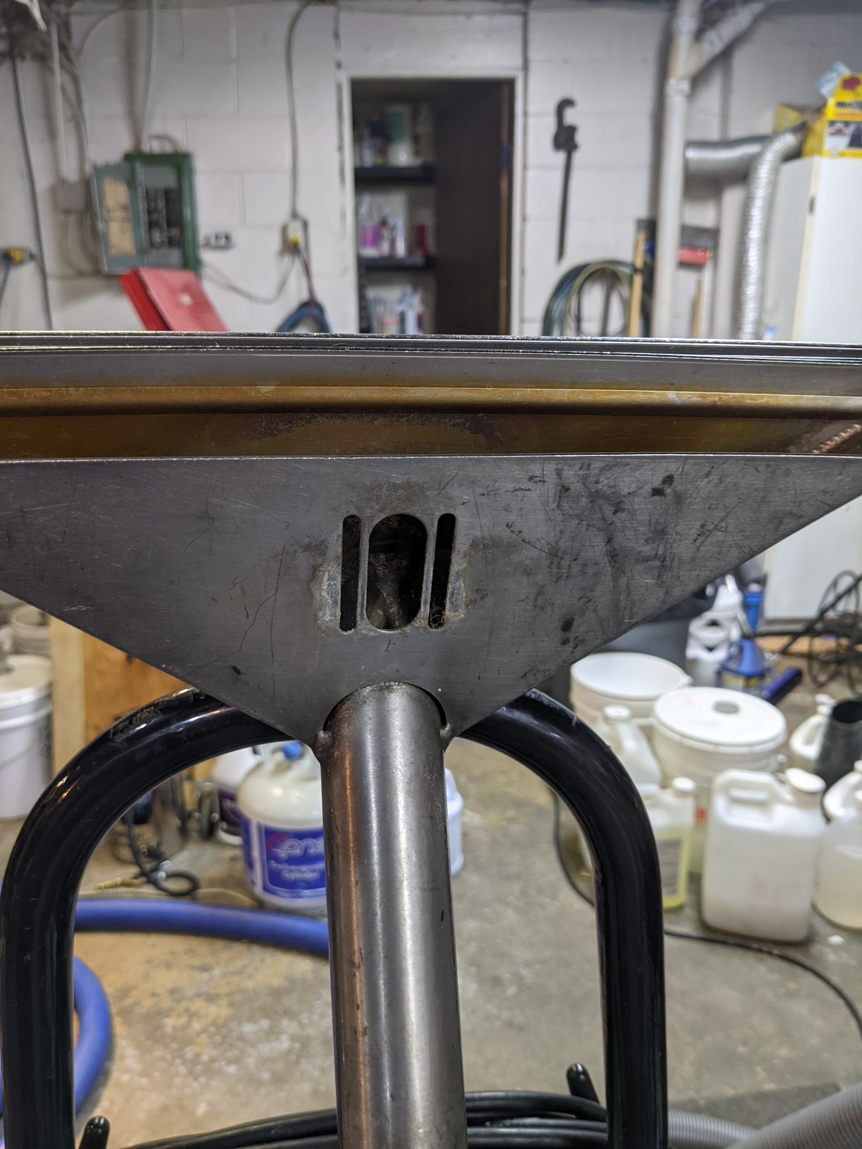

I'm not sure how it correlates to a t or v jet but I remember it putting out what seemed a lot of water. There is some adjustment on the steamway wand to raise or lower the jet. Probably easier to find a jet locally but I could mail you this one. It is brass so probably worn out.

is that like a trick question?
flood jets (FJ) are heavy in the center (from my experience)
..more pressure/more water/more impact.
too...the jet is prettydamnclose to fiber
the slotted thingie on the wand head allows adjustment up or down jet height if needed
(for angle of spray)
I'm told the stock FJ is equivalent to 07 flow
it's a good flush wand, but TEE and VEE jets are simply a better mousetrap than FJ

the floodjet flow twice that of a similarily marked t and v. A 3 flow on the flood jet would be equal to a 6 flow on a t or v jet. On the steamway wand, the single flood jet would cause streaking issues. @doylebloss

Depends on the pressure and the height of the jet from the carpet, I would think. I have had 2 steamway wands and never noticed streaking. The angle of spray is supposed to be aprox 130 degrees. A partially clogged or worn jet will cause streaking.

With the back shield on the steamway wand you cant see the spray pattern.
