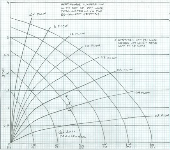

14,197
14,197
Don’t listen to those meatheads above. Just follow the chart to the specs on your water pump on how much gpm it can put out
Reactions: FyreLyter
14,197
I need you all to help me understand "flow" as it relates to carpet wands. I understand that higher flow results in more water, but how much. When you say "my wand is 9 flow" what do you mean?
Can you tell use what machine you’re using on that wand?
(corrected for friction loss by Dan G)

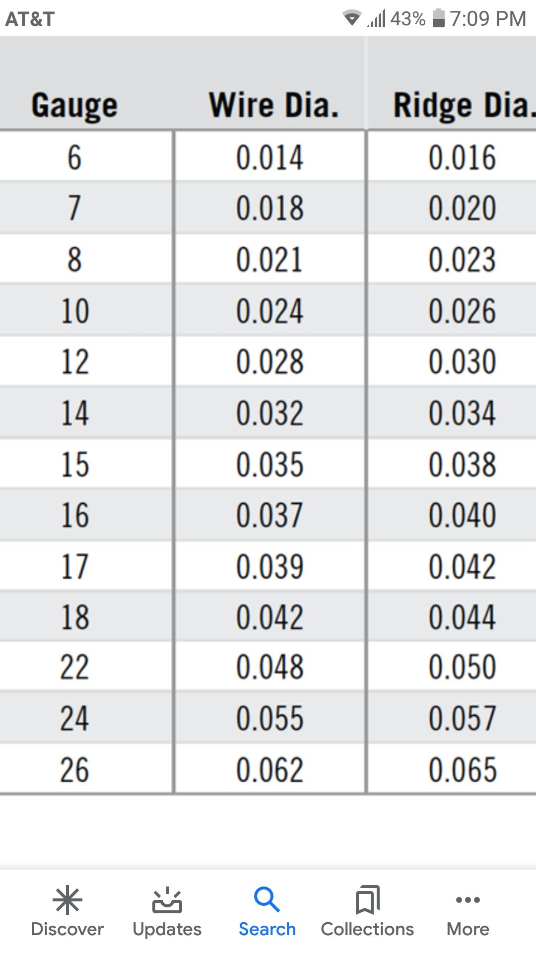

Coming from the machining industry I agree with Ron.
A 11003 is a .030 opening. The 110 is the angle. You can't get a .030 tip cleaner in .015 opening. Different pumps will produce different flow rates at equal psi. At least in my experience.
Think of using an electric sprayer compared to your truckmount. The smaller the pump the less water you get through the same orifice.
It's about the back pressure.
Reactions: steve_64
