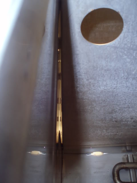

After 4 years It developed a fresh tank drip.
See the crack?
I can't either, but its there

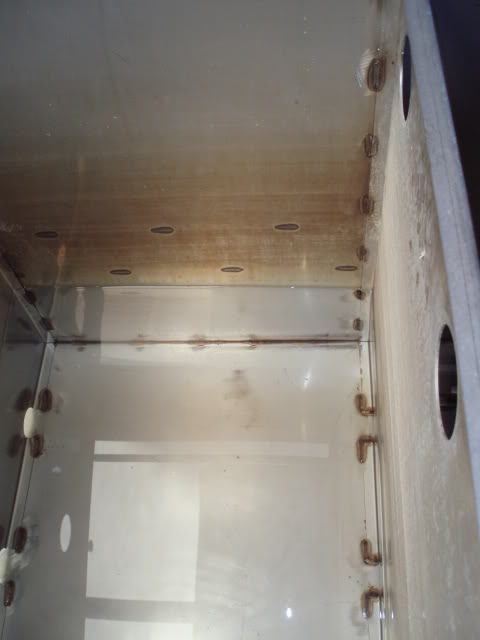

Both my baffle walls fell over in the first year on my Aero Tech built tank. I had a local welder re tack them in. the sides worked loose but the top and bottom welds are holding. AT had nothing on the bottom holding the walls down. :shock:

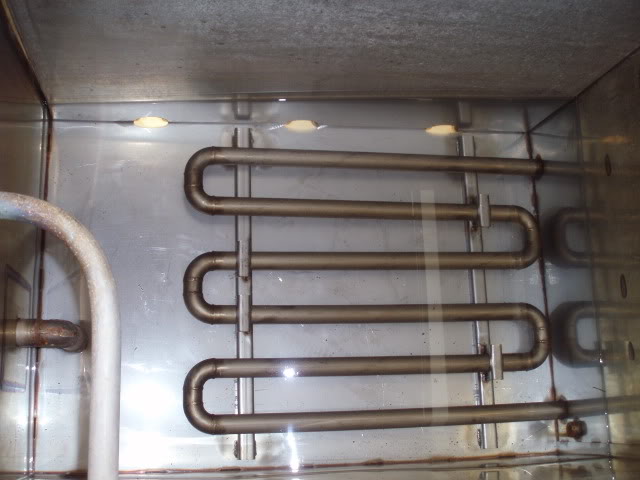

HX pipe from the radiator

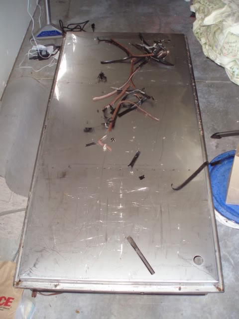

Redoing the lid gasket while I'm in there.

I had Nordik1 install that HX pipe Vince.

I have no float. That particular float was found in pieces in the bottom of my tank. I now have a brass one, just like the one Jim showed, but I have not put it in yet.
