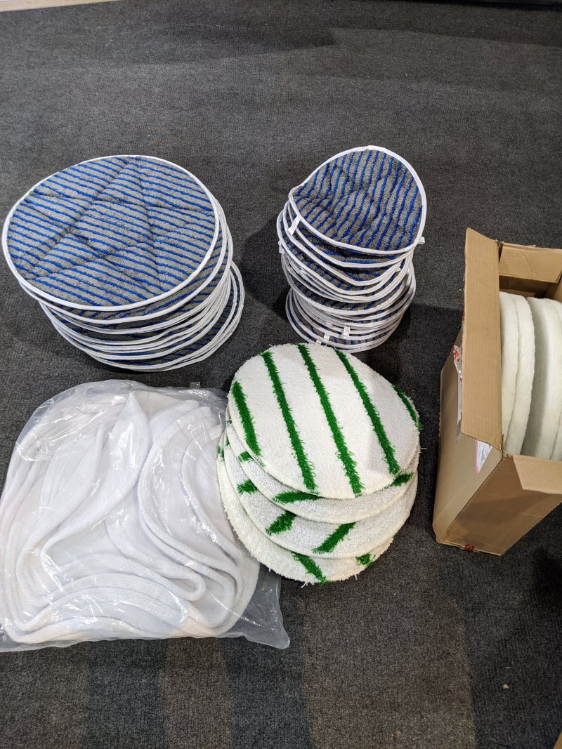

Sounds good to me. Just got my order of pads, encap here we come.
