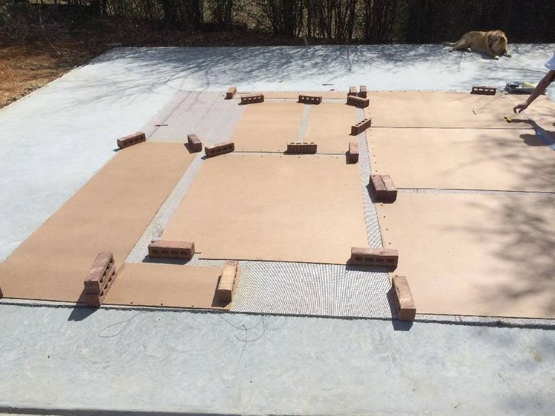

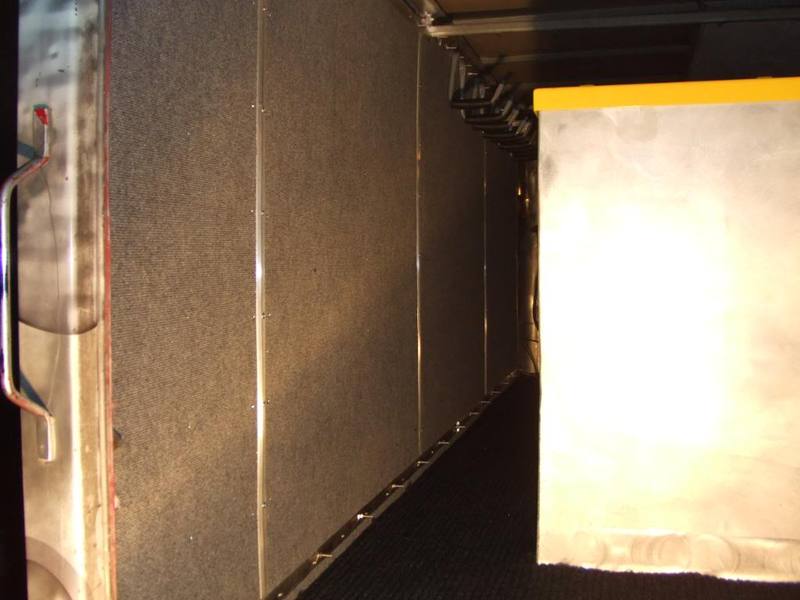

We use half inch insulation mounted on the wall studs then assemble a marine carpet epoxied to a Masonite board measured and cut for all exterior walls.
Hang on wall studs adding all the hangers or track system and your done. But it does take all day to do all of the walls.

I thought of Masonite as well. Marine carpet is a good idea. I may copy you on this. And you got it done before the song was over - impressive.
