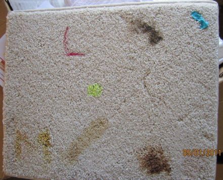

DuPont actually did the first "disperse dye" stain removal using an oxidizer accelerated by a strong UV light.
We also used the process at a spotting contest in Wichita Falls last summer.
~18 Contestants tried to remove furniture polish, mustard and other difficult stains for donated cases of Chemspec products.
This is what the stained carpet looked like (furn.stain bottom right):

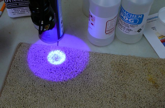

Here was a carpet cleaner using our UV light:

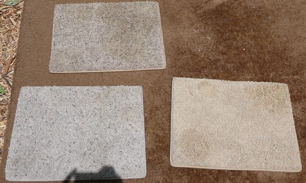

Here the bottom two were the winners who removed every stain with little distortion:
They both used the UV lights `5 min. to completely remove the dark furniture stain & mustard.
