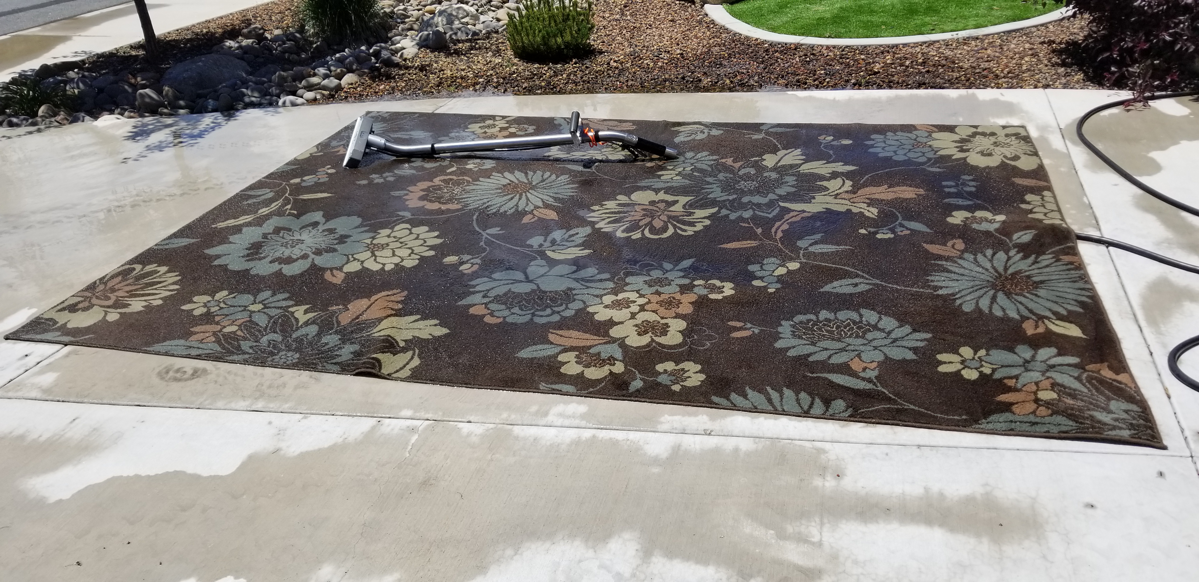

Im testing his theory today on our Pepper soaked olefin woven.
Flush flush flush..
Push the brown water off until clear..
Extract...
dry with fans and the sun...
Lay a hose under it and rinse. If you don't have a scrapper use you glided wand to squeegee it off. Better yet flip it over soap it up use your CRB then preasure wash the back to push/rinse through then do the front use caution with the pressure though.
Roll it around a pipe, tie it, stand it up have a beer/fruity margarita you rug fag, then extract the bottom foot or so of water.
115,939
Did that for over an hour wit the wand.. Water was that delicious golden brown in more than half the area..
Smelled great when cool and wet but had a slight pee smell when it dried so I doused it with a smelly good quat and dried again.
Back in use now.
tossed the Nomuv...it was the funk.
Back in use now.
Wash it again. Still has pee in it. why mask it?
If it's like a situation we've all been in with the rug in the driveway...he masked it because he's already been screwing with it for 2hours and he has 3 more jobs to go after that job. Animals are probably gonna get right back on that rug, so masking it is smart for business reasons and common sense. It's an "on site" cleaning, not a pickup and delivery cleaning
