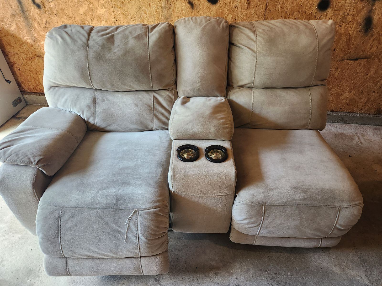

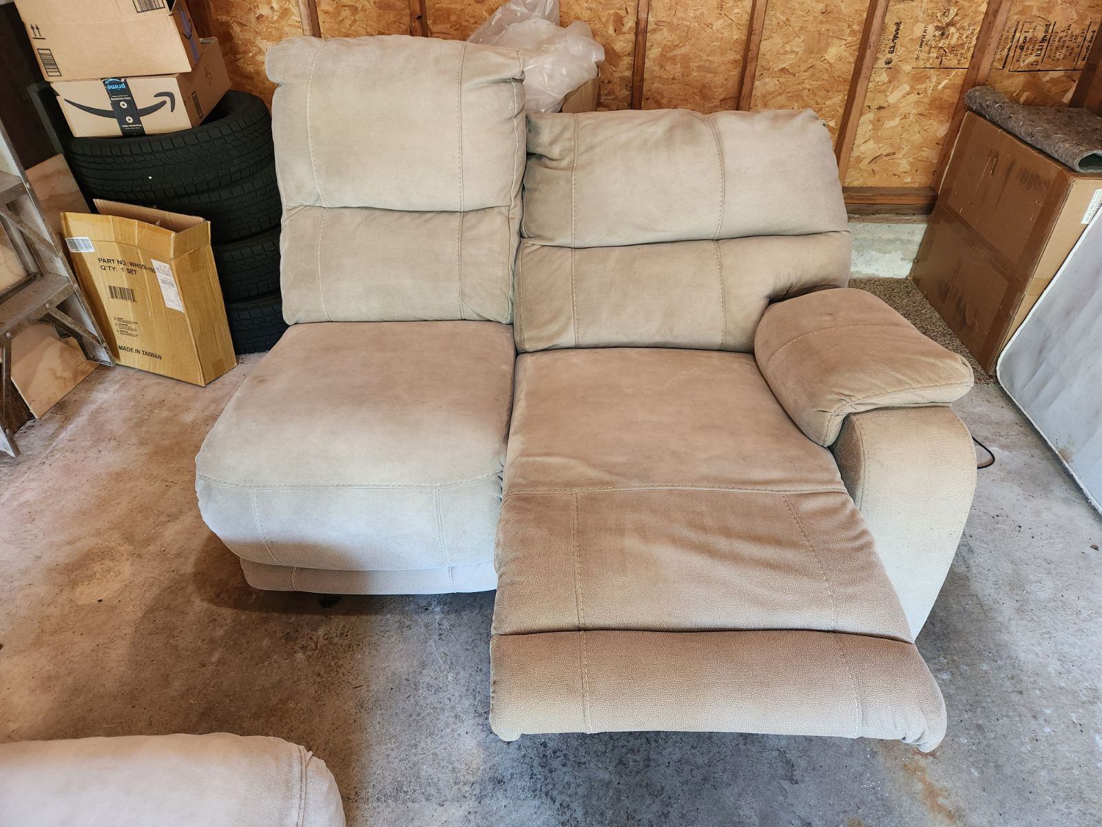

This is a synthetic sectional I cleaned a few weeks ago that was trashed. Used Bio-Break at 9.5pH, went over the entire thing twice with preconditioning, agitating, and extracting. Tried spotting the heavily soiled areas with volatile solvent, encap ds, degreaser, and peroxide at different stages and the soil hardly budged. Used an orbital buffer with cotton towels at the end. To me the result looked like shite. Almost offered to have cleaned it for free but the customer was surprisingly happy. Made an improvement for sure but I thought it sucked.
In the future I'll assess it during pre-inspection more honestly, get the customers approval or disapproval to clean it knowing the results will likely be poor, and not anxiously hope to myself that I can pull off a miracle while cleaning it. The whole thing was sad and frustrating. Sorry bout the before and after pics being different pieces of the sectional but they all looked similar to one another before as they also did afterwards. My photo expert is getting better at consistent before and after photos...
And to boot I left lines with my uph tool that Jim saved my arse and helped me correct before we wrapped up. Hadn't experienced that previously. Hopefully after this Fabric Pro workshop it never happens again. What a trip.

Thanks. Funny it's the same exact color of Avenge Pro too. I never thought about using a spotter as a prespray. Why not though. I suppose with dilution ratios adjusted that's true for many things.

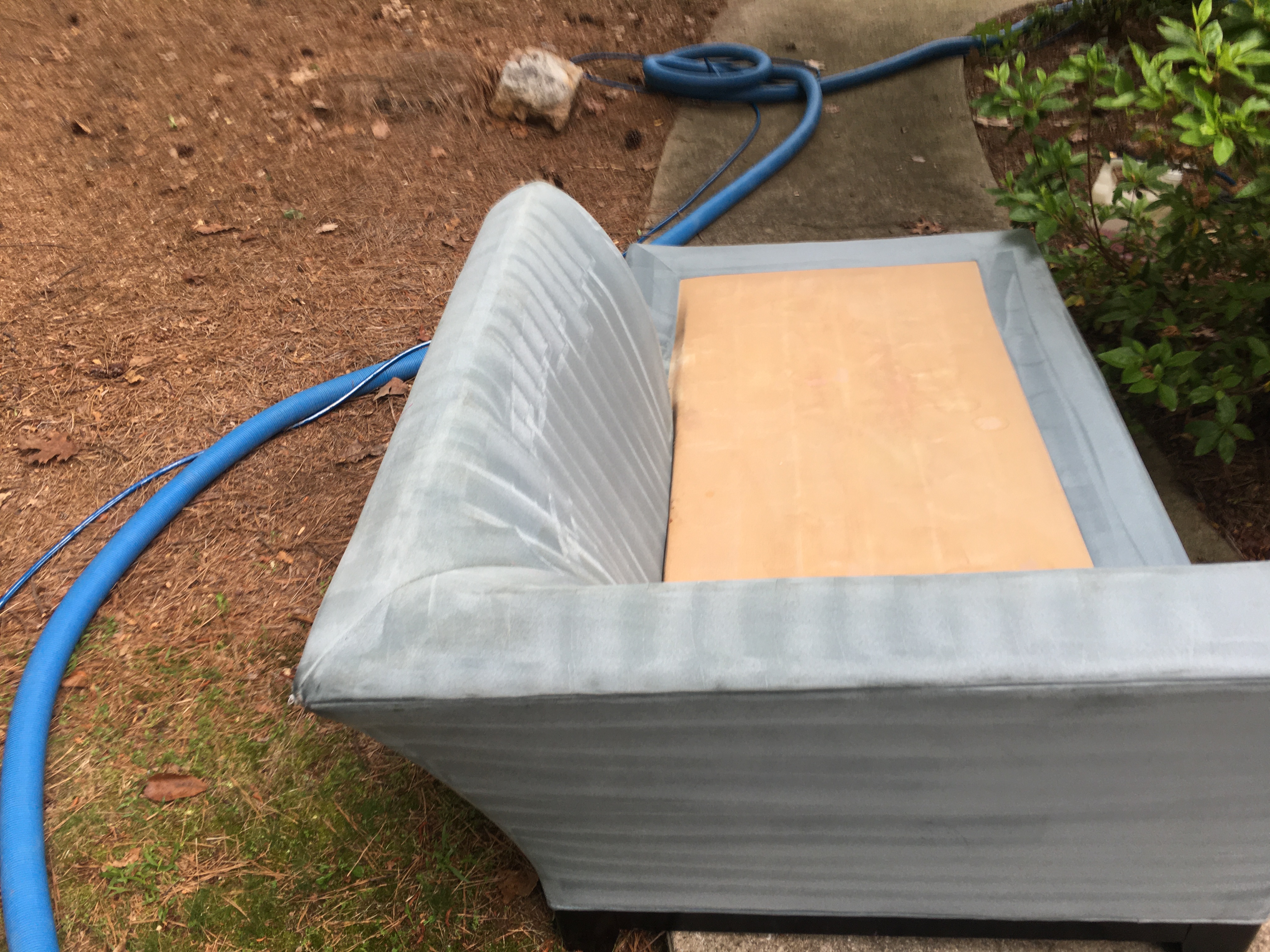

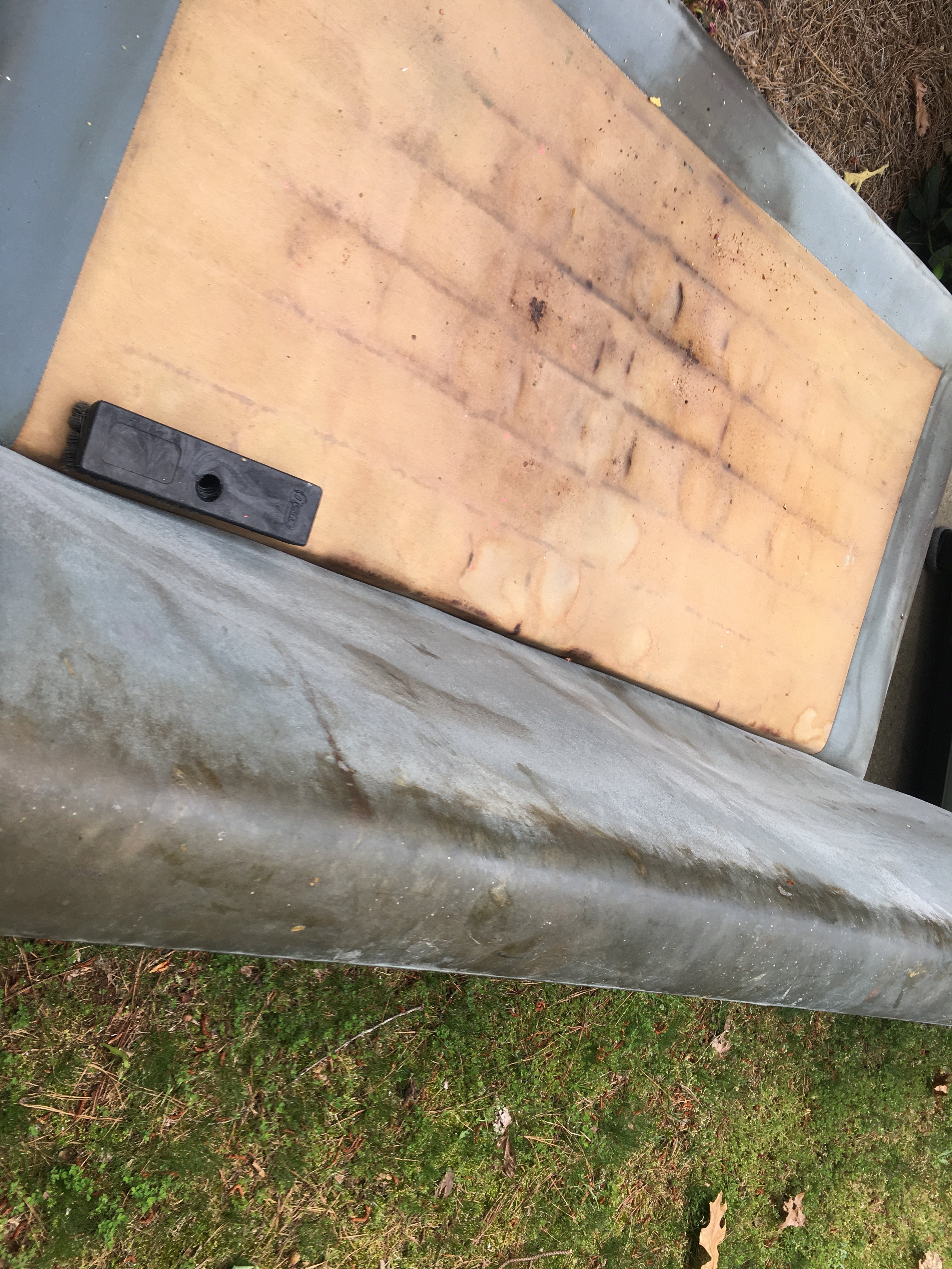

Sometimes the carpet treatment is needed and you just have to break the rules to get the results you need, depending on what type of fiber you’re cleaning
When there’s more oils, you need more surfactants. And when more surfactants are needed, you need more water to allow the surfactants to work. Notice the couch I cleaned here was moved out in their yard for that reason

Holy guacamole man those are INCREDIBLE results. Amazing work man. I'm slowly learning how to safely push the boundaries to do this caliber of work. Bravo dude...

Is that velvet? Did you have some texture restoration work to do after cleaning?
