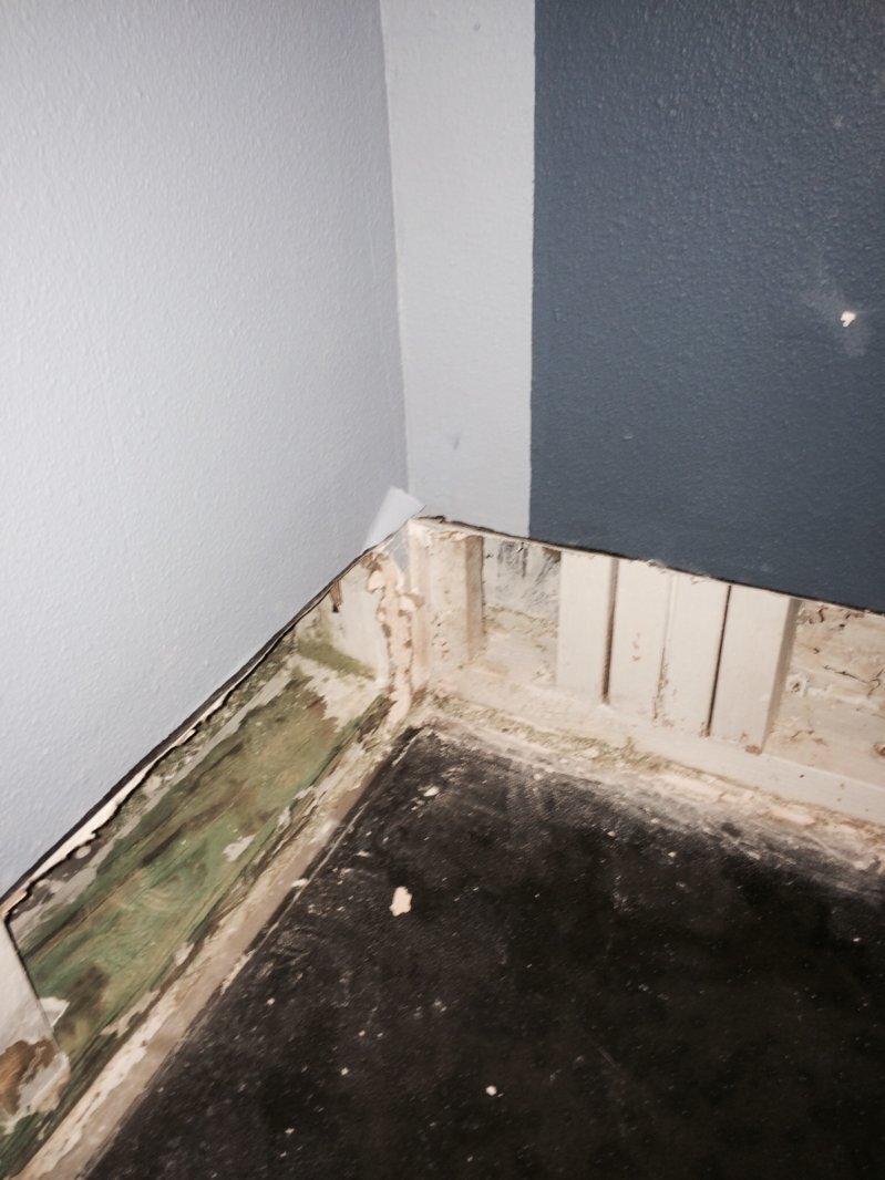

Im not sure the technical term. I think technically its a bottom plate as a sill plate refers to something that has an open cavity underneath. This board is flush into the concrete slab floor and there is nothing behind it except the foundation of the house. This picture is of the same board along the same foundation wall in the water closet. This area did not have mold remediation. The framework and foundation is identical to the ones on the bedroom that share the foundation wall and bottom frame board. The only difference is the walls in the bedrooms have insulation and sheetrock. The sheetrock has been cut all the way to the wet insulation and all wet stuff has been romved. Plenty of air flow.

The board in the picture was treated/coated with something. That board is now reading 8%. That same type board in the bedroom where the mold was previously has the same green thing on it but was also painted white. The studs going up are also painted white. We decided today that there must be some type of moisture barrier in the paint/finish that was holding moisture. We used a wire brush on an angle grinder to remove the white paint/green stuff in a small area. The wood beneath that was still pinning out all the way. So we determined that it was not a false positive. We grinded the white paint off of the studs running up the wall in a few test areas and there was no "green stuff" there and the wood beneath the paint was dry. So the wet area was only along this bottom board that had "green stuff" then painted white. We grinded it off enough to hopefully let it breathe and dry quickly. We had never seen this before and neither had the adjuster. Just wanted to put this out there for everyone so they could add it to their notebook. I originally thought it was moisture from slab or not enough airflow or dripping moisture from the pool above/behind foundation. Im pretty sure we are spot on now but will confirm tomorrow.

Do you think its false reading if I grinded down to what is for sure wood? I took my test area down about an inch just to confirm that it wasnt still touching some sealer and giving false positive. But if they put something that penetrates wood with metals or something then I could be off.

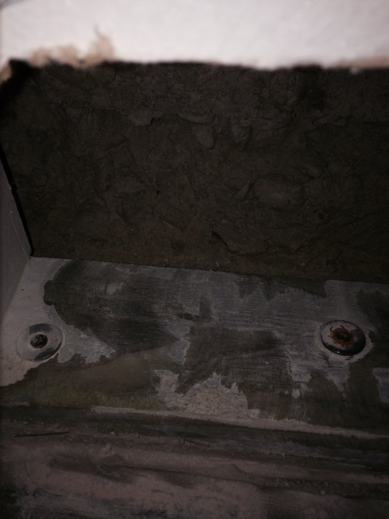

The pressure treated base plate in this picture appears to be saturated. The slab and adjoining wall also visually appear to be wet or have a high moisture content. If this slab floor sat in water for three days I seriously doubt it is back to normal moisture content. The base plate is in contact with the slab, and if the slab has an elevated moisture content so will the plate. How did you check the slab moisture content? If the slab is the problem which I suspect it is you should use slow airflow (to ensure you don't choke off the cappillary action) and employ a desiccant to achieve the lowest possible GPP. As mentioned the smallest possible containment area around the affected material will be a big benefit. Based on the assumption above, even with slow airflow, low GPP, and containment it could take a number of days if not longer to achieve normal moisture content levels in the slab and thus the base plate. Always hard to say for sure without all the facts and more info, but based on the info presented this would be the most logical explanation.

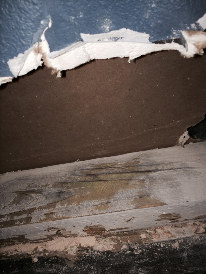

The picture I posted was from day 1 when the guys were extracting water. The board in the picture is also not the one giving me problems. It was just the only picture I had on my phone. All of those bottom boards running against the slab have some green stuff sprayed on them previously. The bottom boards behind the bedroom walls had the green stuff and then white paint on top of the green stuff. That combination created a very thich texture almost like gum and was holding the moisture in the board. The bottom boards that just had green were drying and the bottom boards that just had the white paint were drying fine as well.
I am heading back there shortly to confirm what I finally figured out. I will take some pictures so everyone can see what I am talking about. Hopefully this will help some people in the future. The adjuster was a seasoned adjuster dealing mostly with water damages and he said he had never seen it either. I also spoke with some friends in the business and they had not seen this.

Just checked it and moisture is coming down quickly since I sanded the goop off. Down to 25-35% already so should be dry soon.

The bottom pic is a good one to see the difference. Wall on left has the green AND white. Wall on left is just the white paint.
