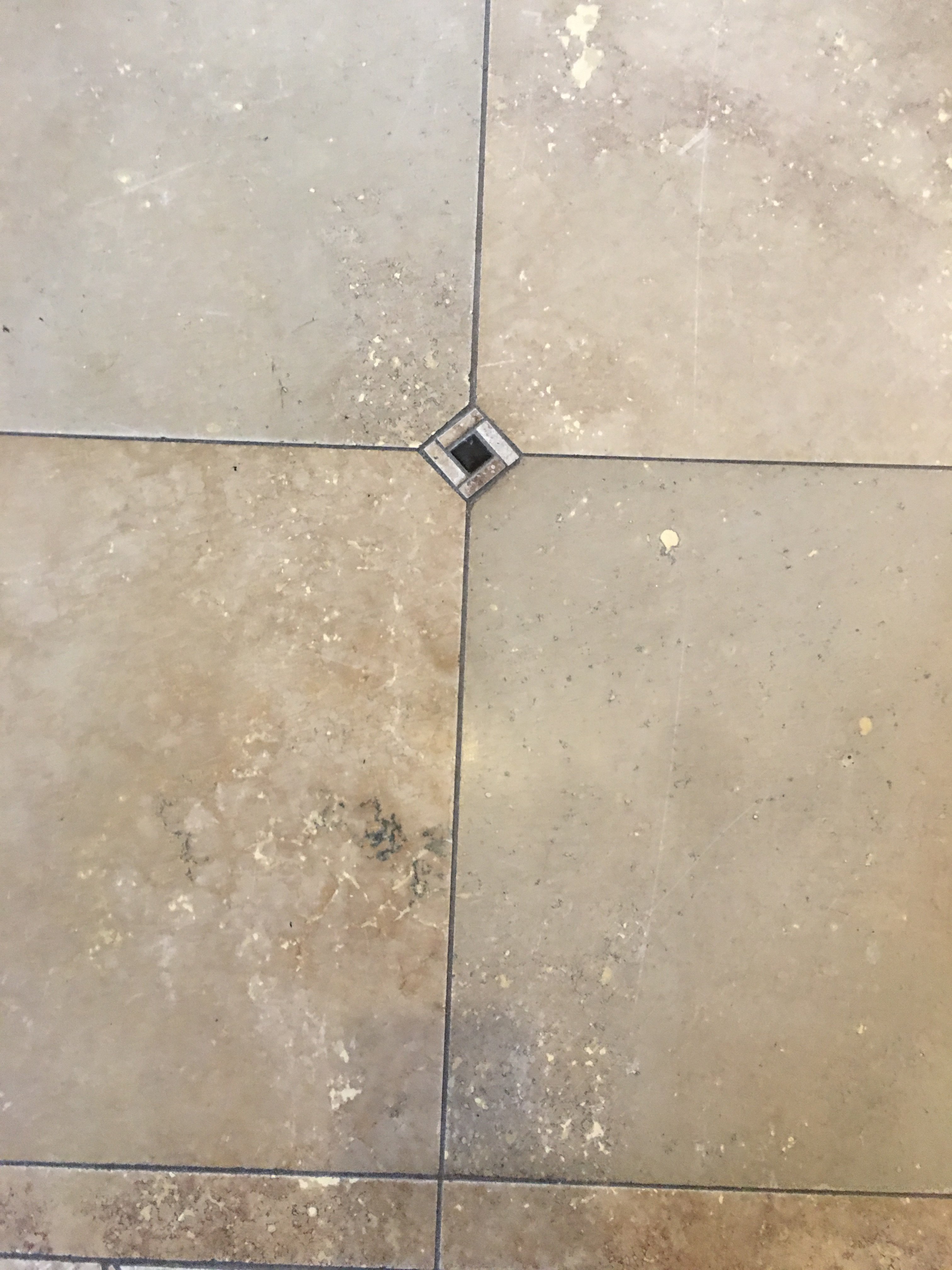

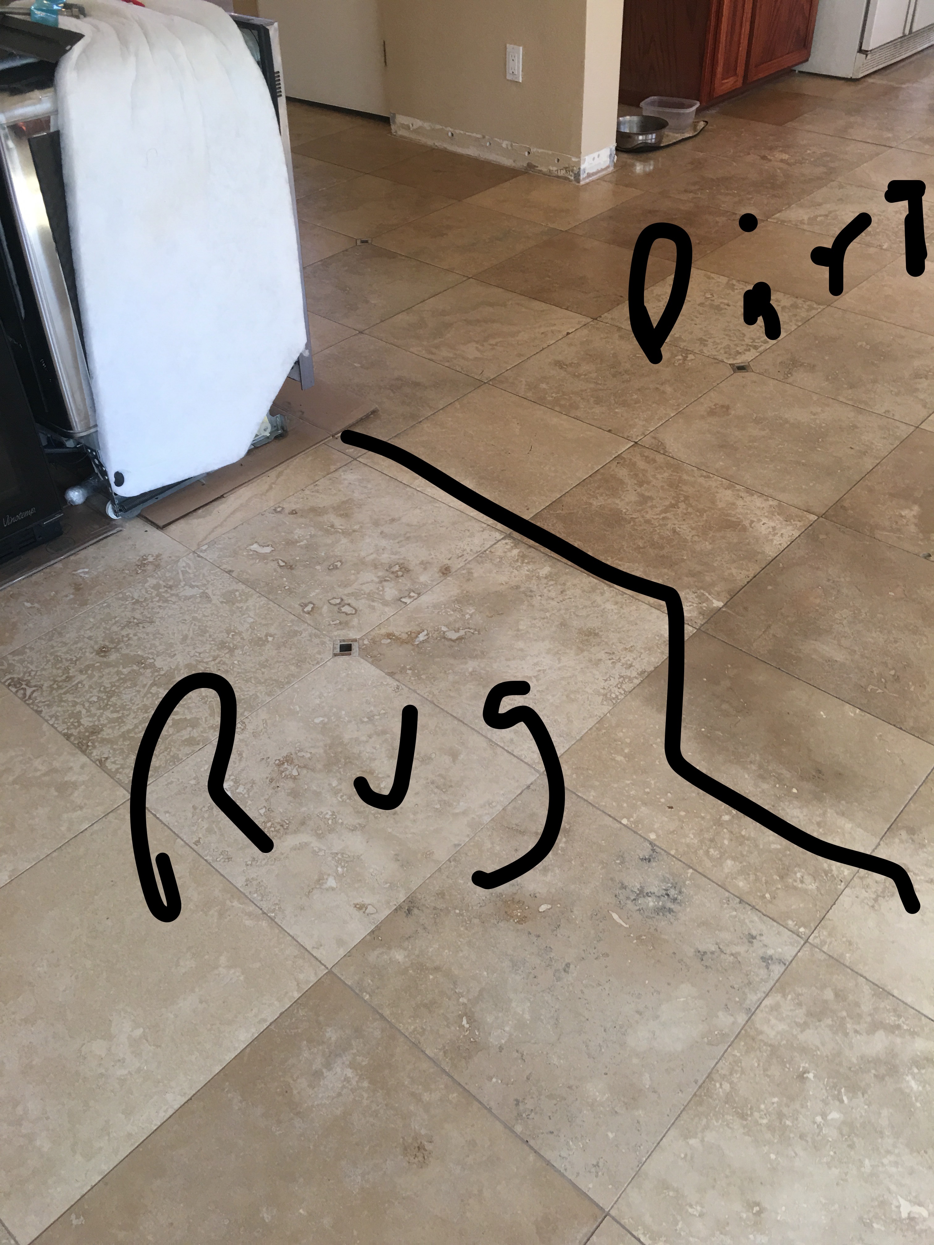

Lady calls and had a flood, everything is dry.
She got a contractor to come in a quote her for new floors, but she wants to try and save money.
The lighter darker area is where a rug was

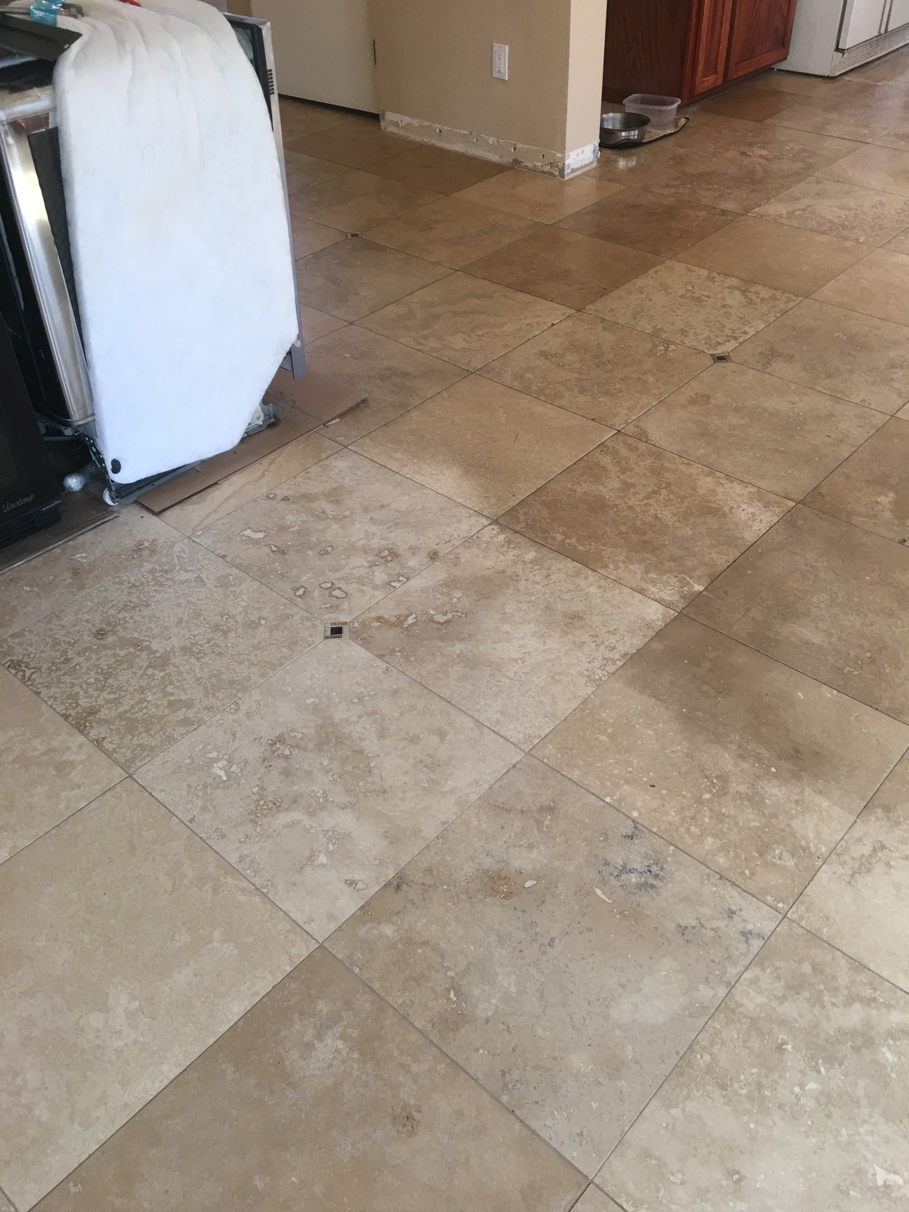

There also a topical on the flooring to.

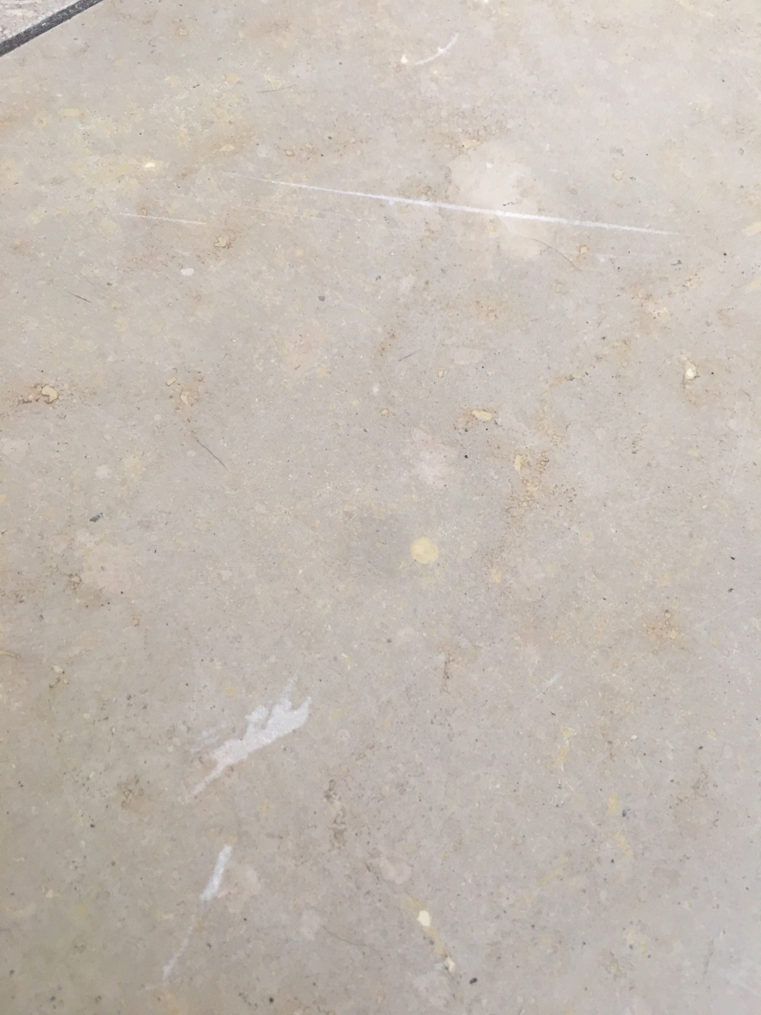

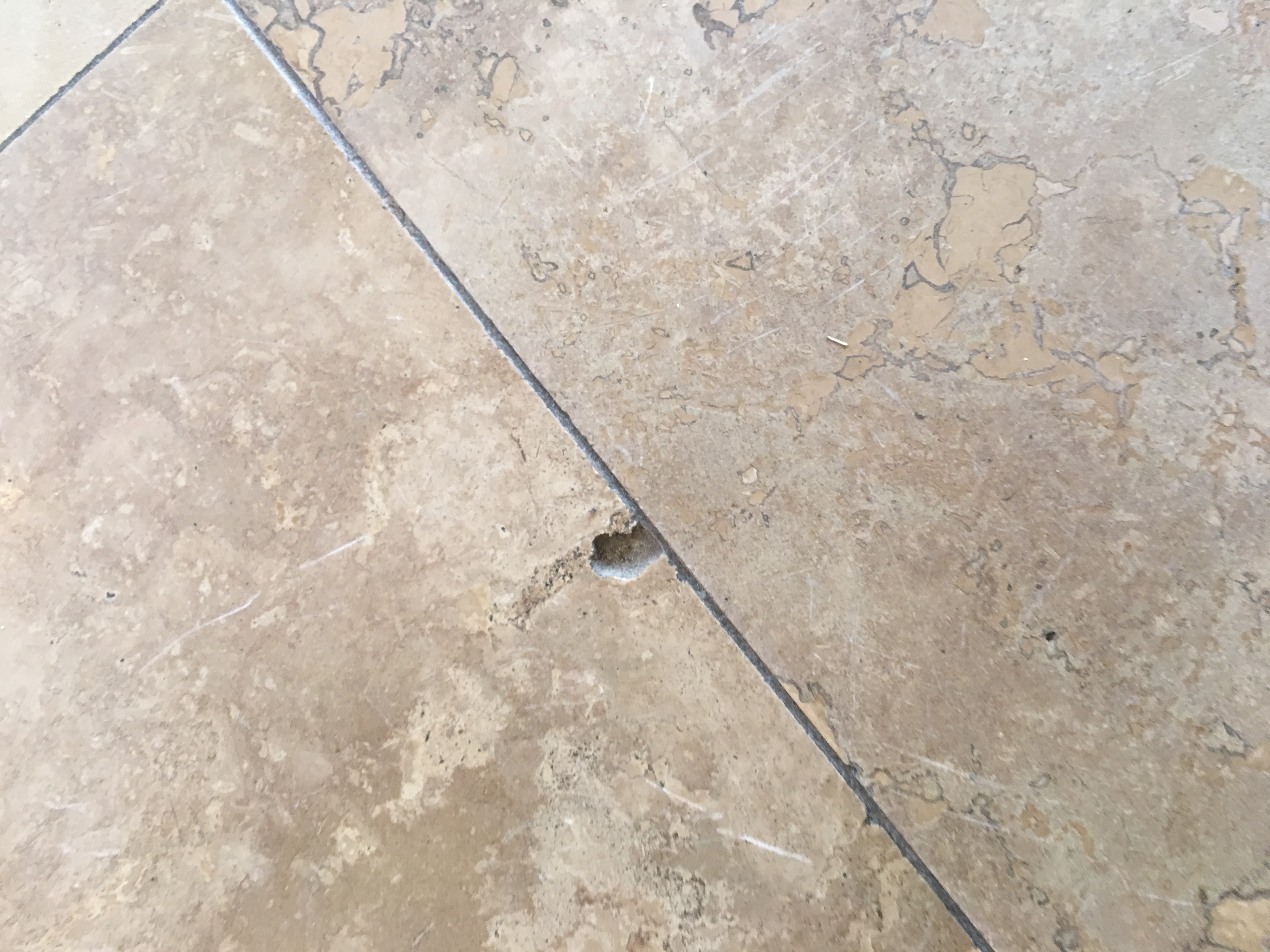

This last picture is where a scratched with
My finger nail and topical peaked off.

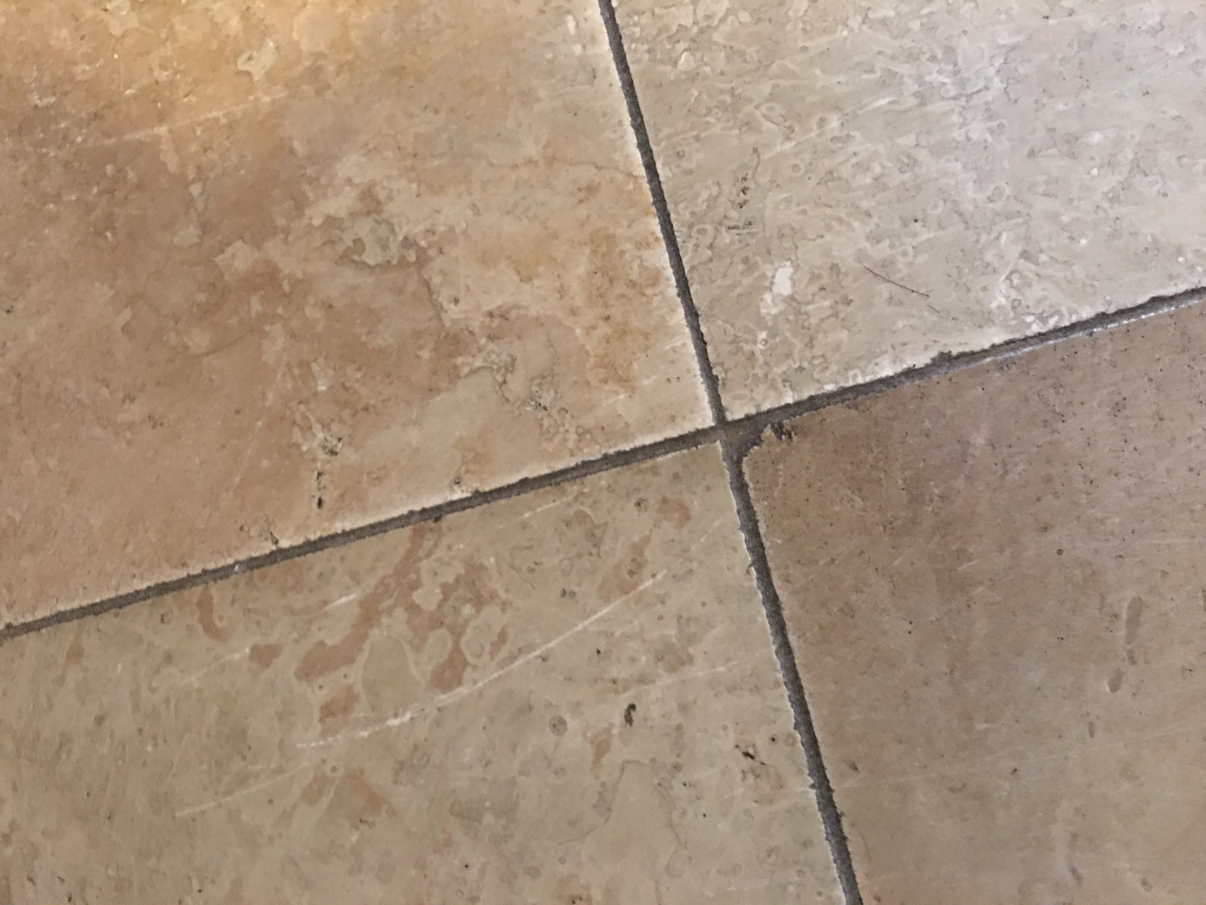

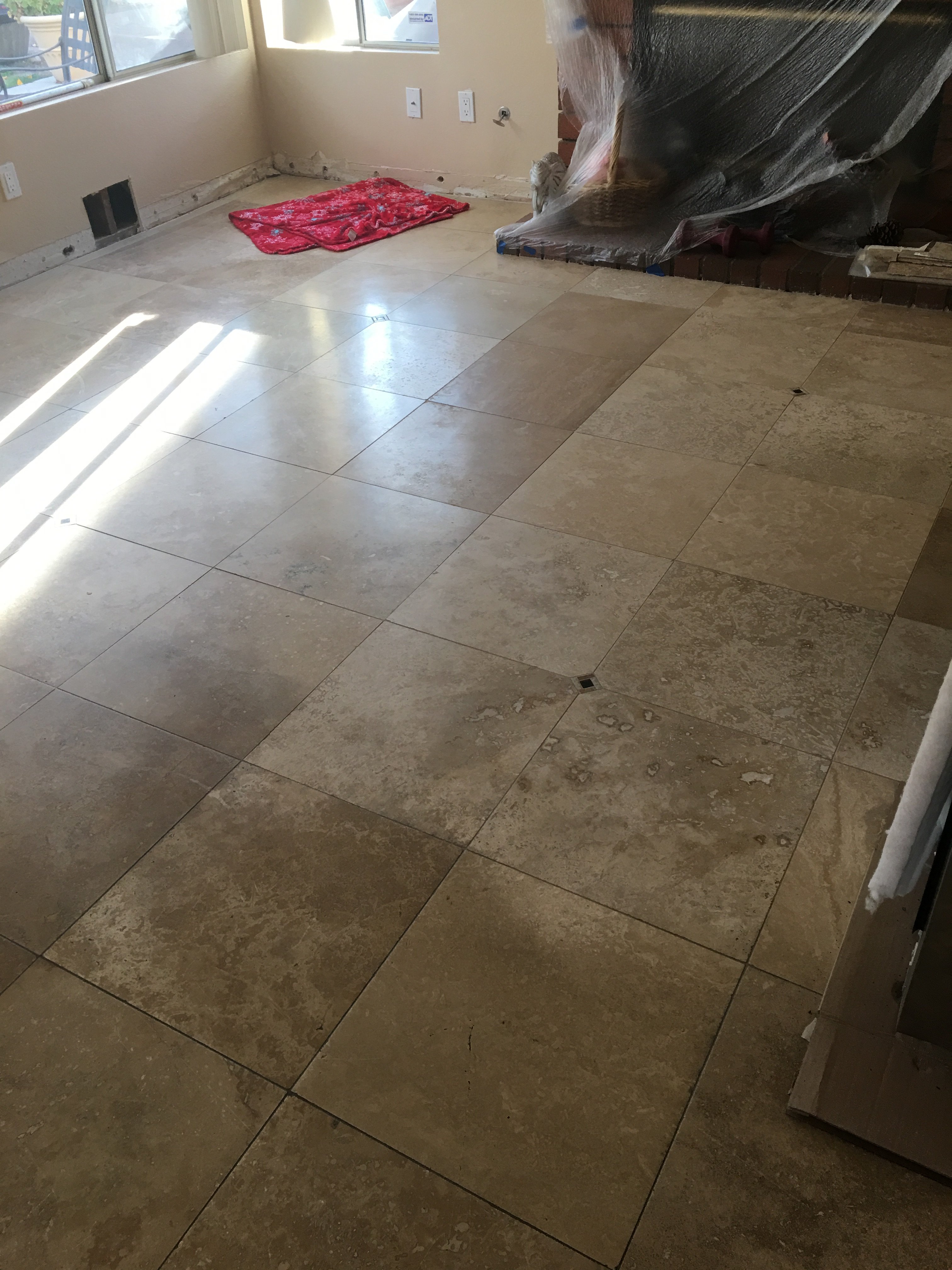

The floor needs repairs and repairs and has scratches that are deeper then the topical.
I believe she wants it clean and honed and polished about 600 sq ft. It would need traverfill in some areas.
Not sure about all the chips and cracks.

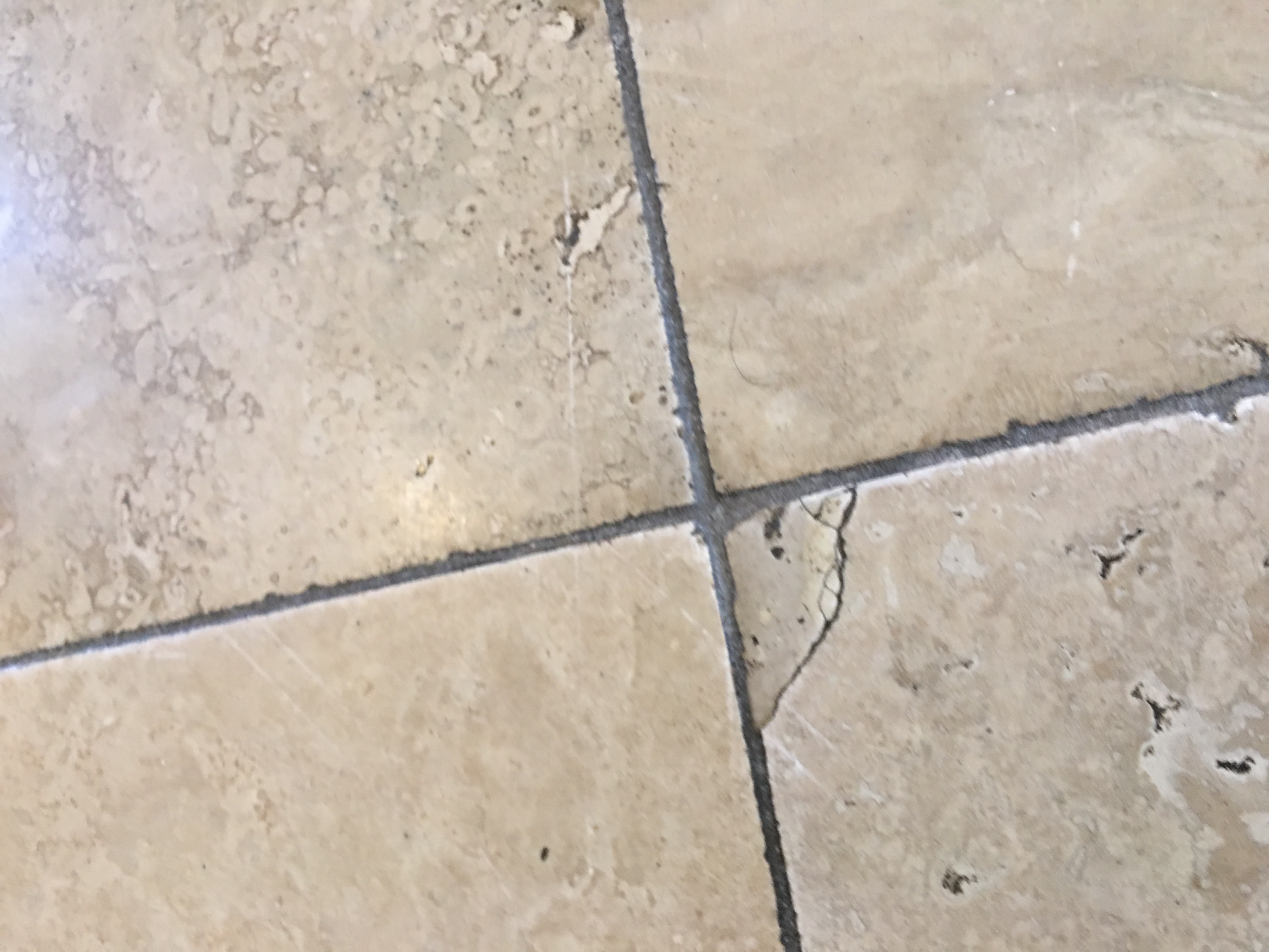

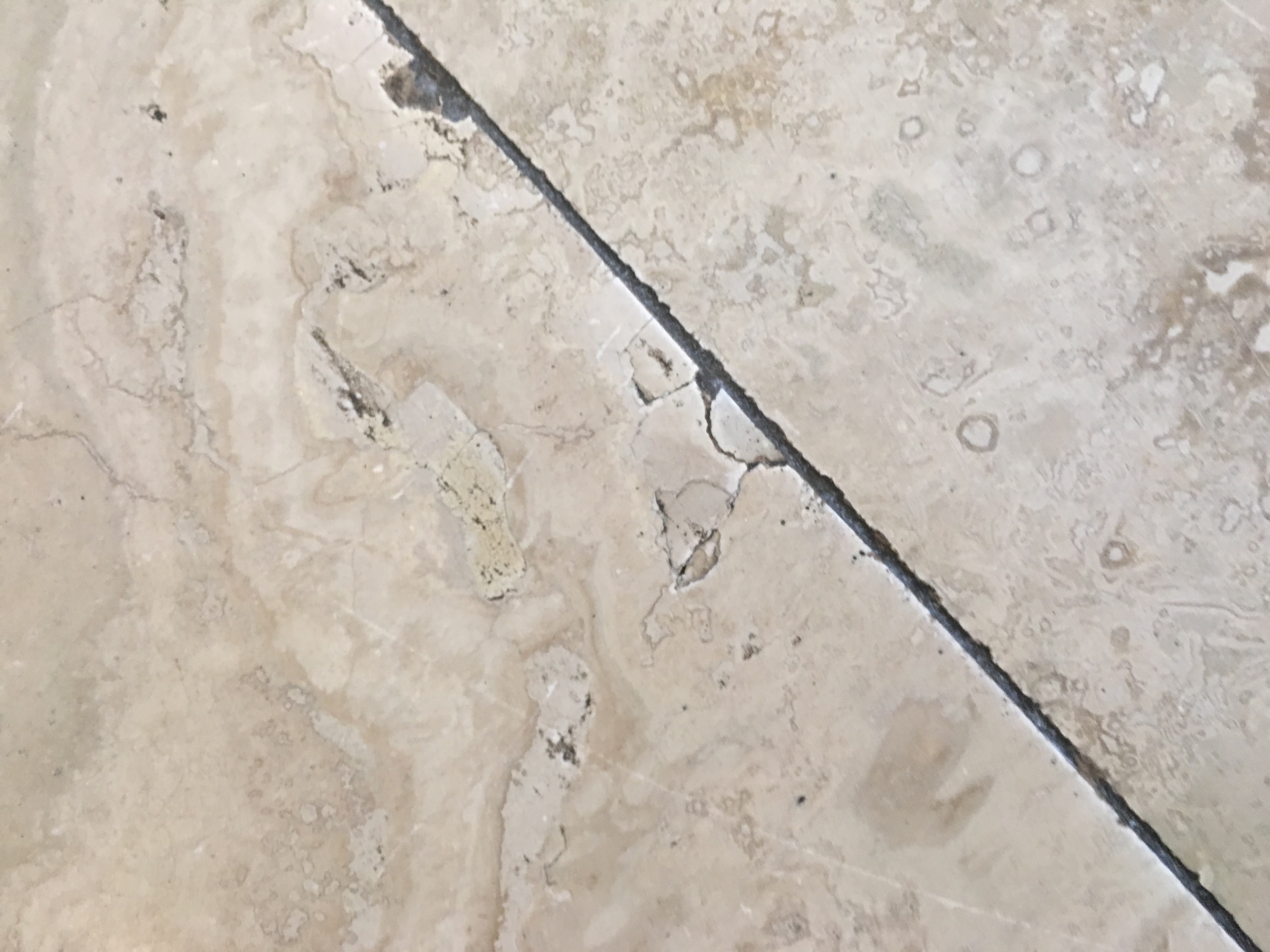

11,297
The whitish area are peel one of those I scratched with my thumb and it peeled off.

I'd love to have this job. Seariously. Lots of money to be made there. If it's peeling off with your fingernail...some heavy alkaline solution and a turbo and brushring might be enough to get it off. You might have to do it twice. Then see what the stone looks like under there. Then hone and polish. Ypu'll be doing even better if you can figure out how much they quoted for replacement.

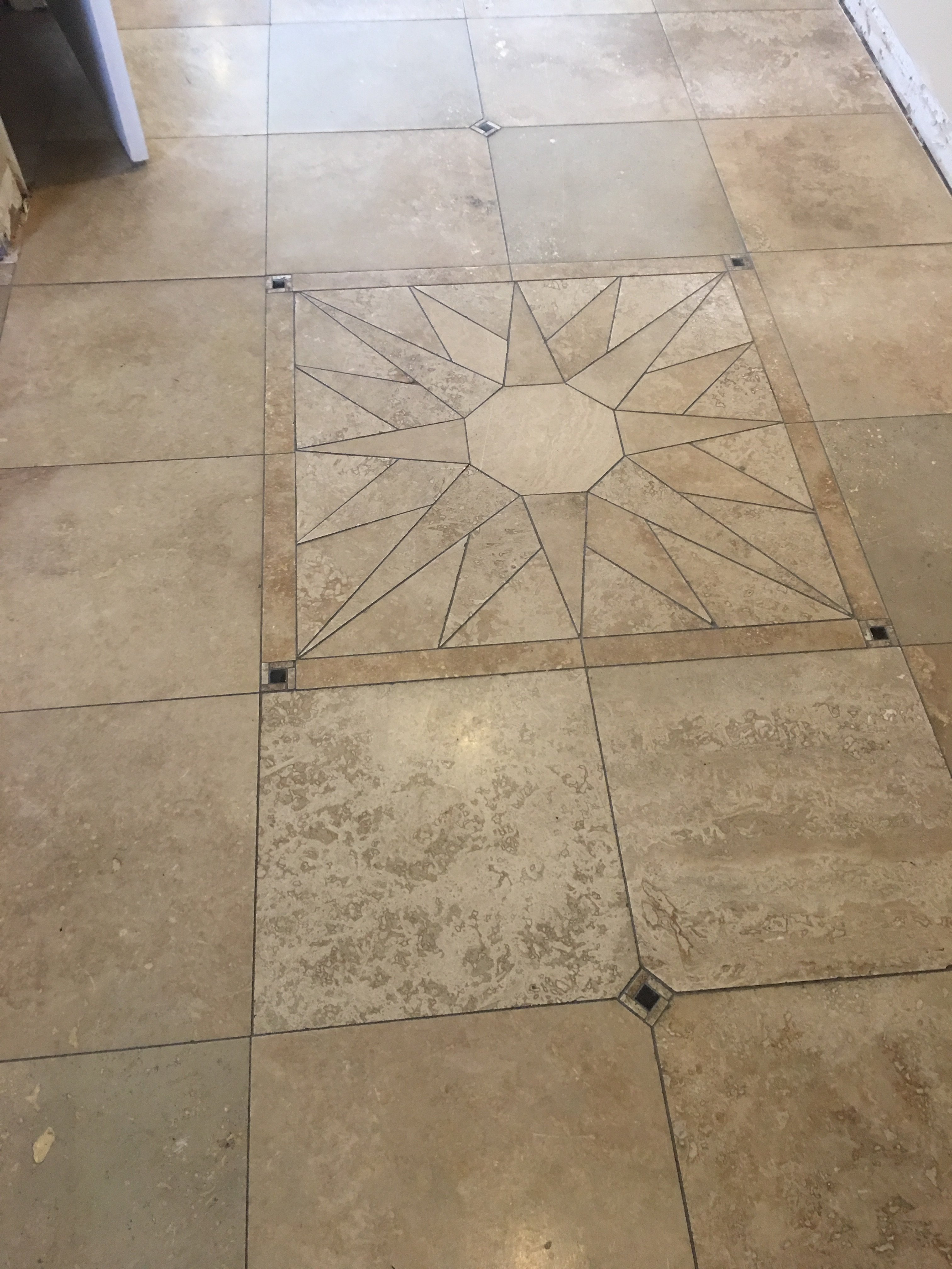

The 220 is not a stripping pad, doing so would ruin it, loading it up with dry polymer. The inlays are going to ruin DIP pads too I'm betting unless gone around and done by hand. No thanks.

1. Strip/extract
2. Very strong alkaline, truckmount the shit out of it to clean the holes and pits
3. Fill and detail holes
4. 220-400 resin
5. Bonastre Yellow DIP with extra weight on the machine. This is bump up the finish and help get rid of picture framing
6. Now you can either jump right to powder polish for a nice presentable finish, or go 800-1800 resins, then powder polish for the best possible finish.
