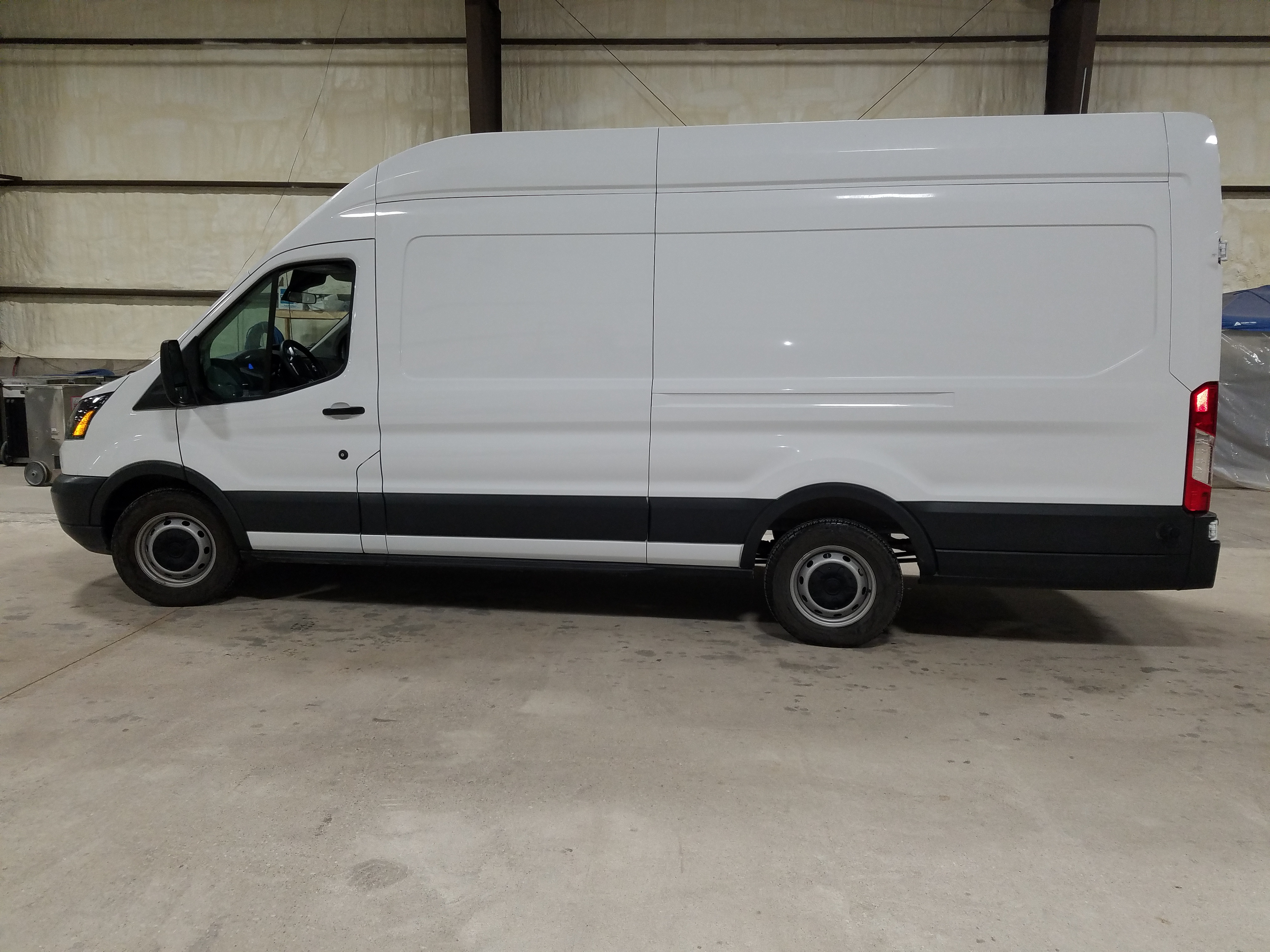

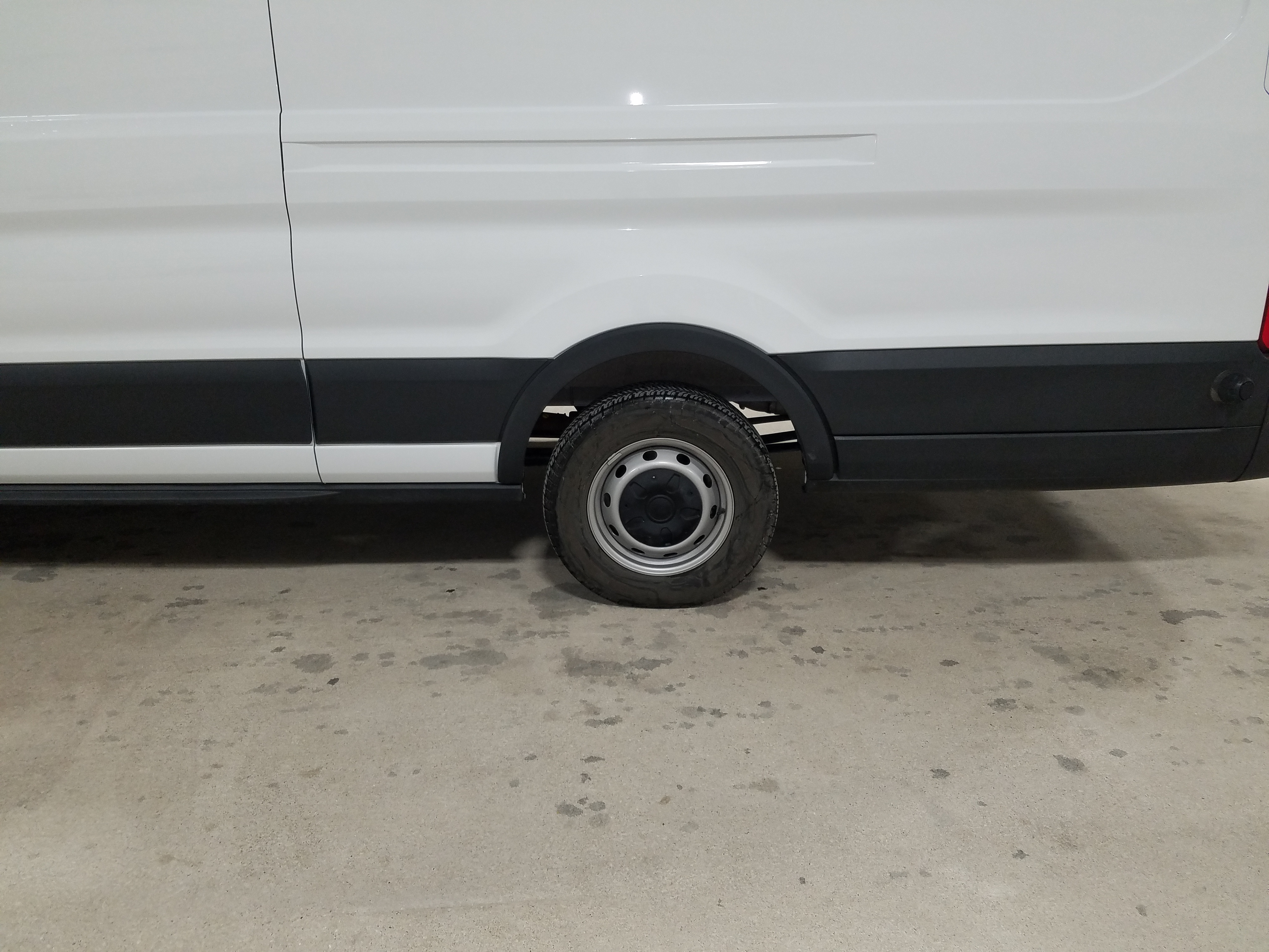

I have a little to much weight in the van and she is sagging pretty bad.

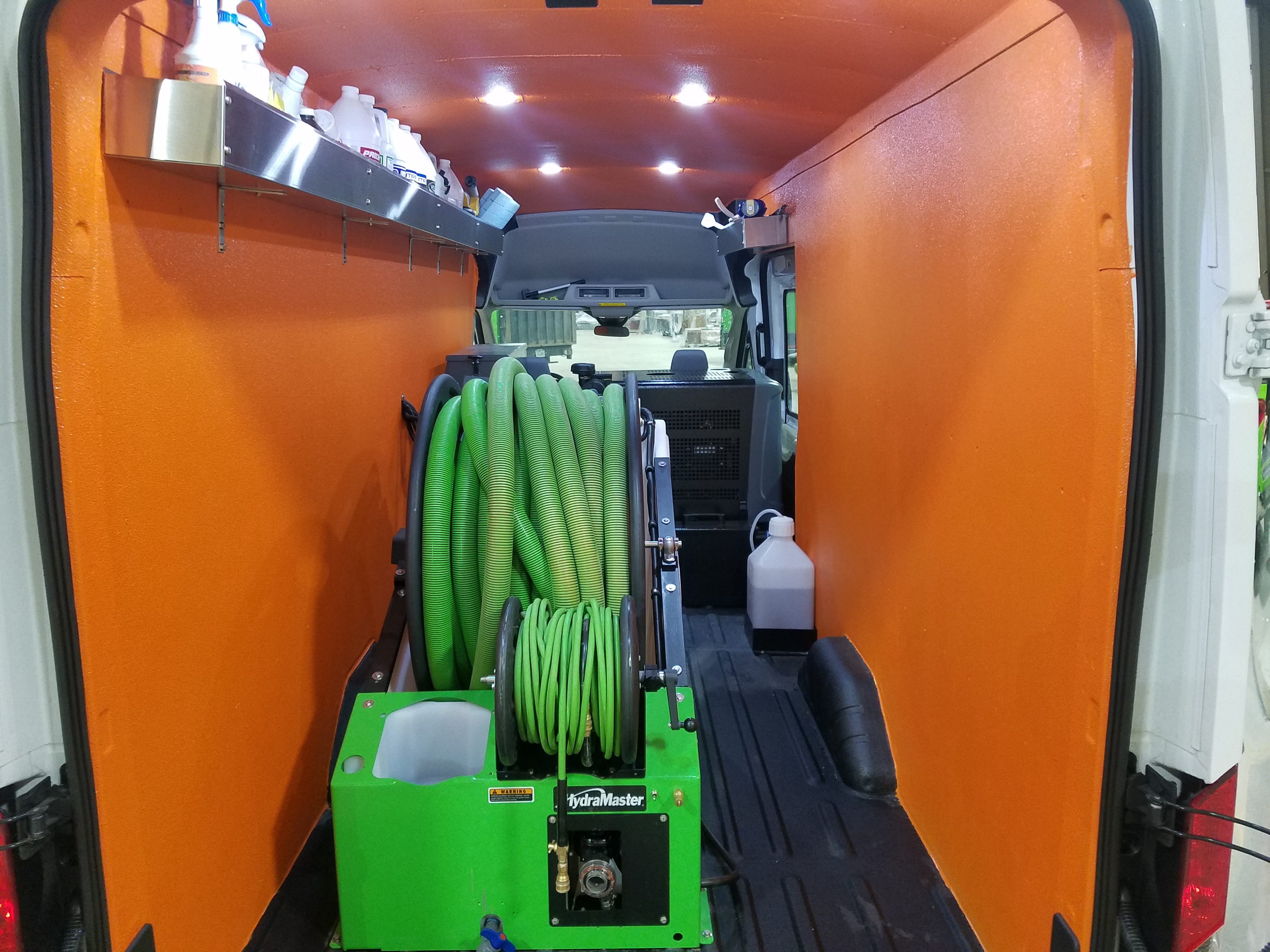

We did insulate and put 3/4 plywood on the walls and 1/2 inch on the ceiling. Also installed some shelves today.
Some weight there but I figured this 350 would handle it.
If I remember I will take a few pics tomorrow and show you this turd.

That heavy plywood seems like overkill but shouldn't be a problem weight wise. Perhaps you have broken a spring leaf? Is it an even sag or more on one side?
FB7777
Too late now, but it appears all the water weight is resting on the rear axle
Side mount probably would have eliminated the sag
On my original 1988 Ford Econoline 150 I had a spring company add a couple leafs. No idea if it's possible or how it would effect the ride

Can you move the water tank back to sit right over the axle or move it to go out the side door? With just your tank and hoses you have half of your payload sitting behind the rear axle. If you ever get the van swerving the back end will come around on you and flip it. That is why they outlawed schools from using the Ford extended vans to carry students.

The water tank will come back a foot or so. We have plans to move it and look at some suspension options but I'm thinking were gonna have to move it into a box truck.
I'm sure we can get the van to stop squatting but the safety issue will not get resolved.
The van is gonna have to sit for a few weeks before I can do anything with it as I have a lot of stuff going on. If any of you folks have any other ideas don't be shy.......

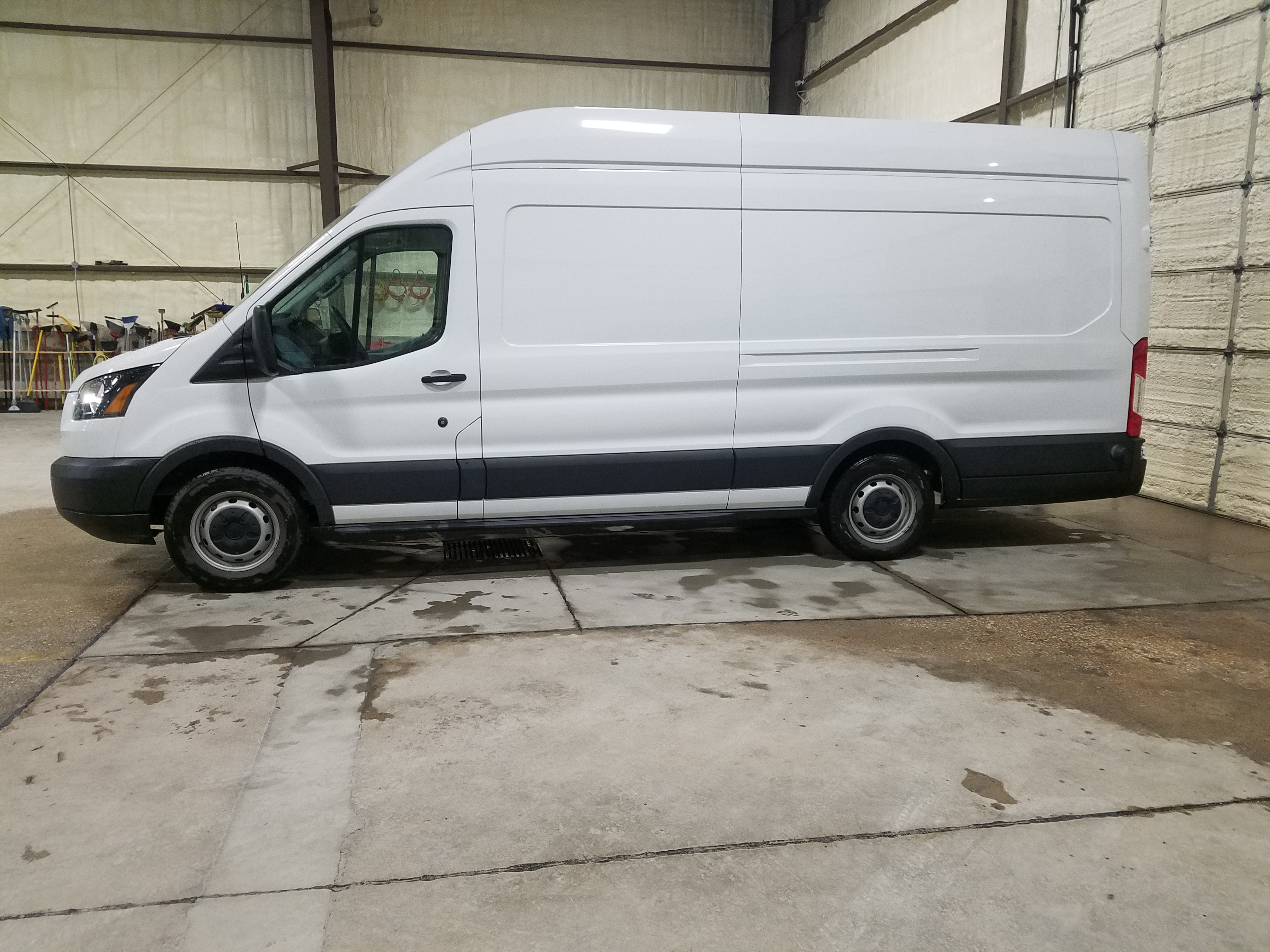

Ended up putting bigger springs in. Much better, I think it's sitting about where it was stock and this pic is with 120 gallons in there.
Still gonna remove the Hydra Cradle. Taking up way to much space, I can't get all my stuff in there.

OEM tires are cheap. Get some larger wheels with slightly lower profile tires rated for more weight. The sidewall flex makes them feel horrible stock. Squirly from that. Also as recommended air bags are your friend. The more weight you can move up to distribute between both axles the better. Also if you wont use the spare tire then ditch it. Most people around their service area might just call AAA. Seems like a small thing but 50lbs behind the rear axle makes a difference.
