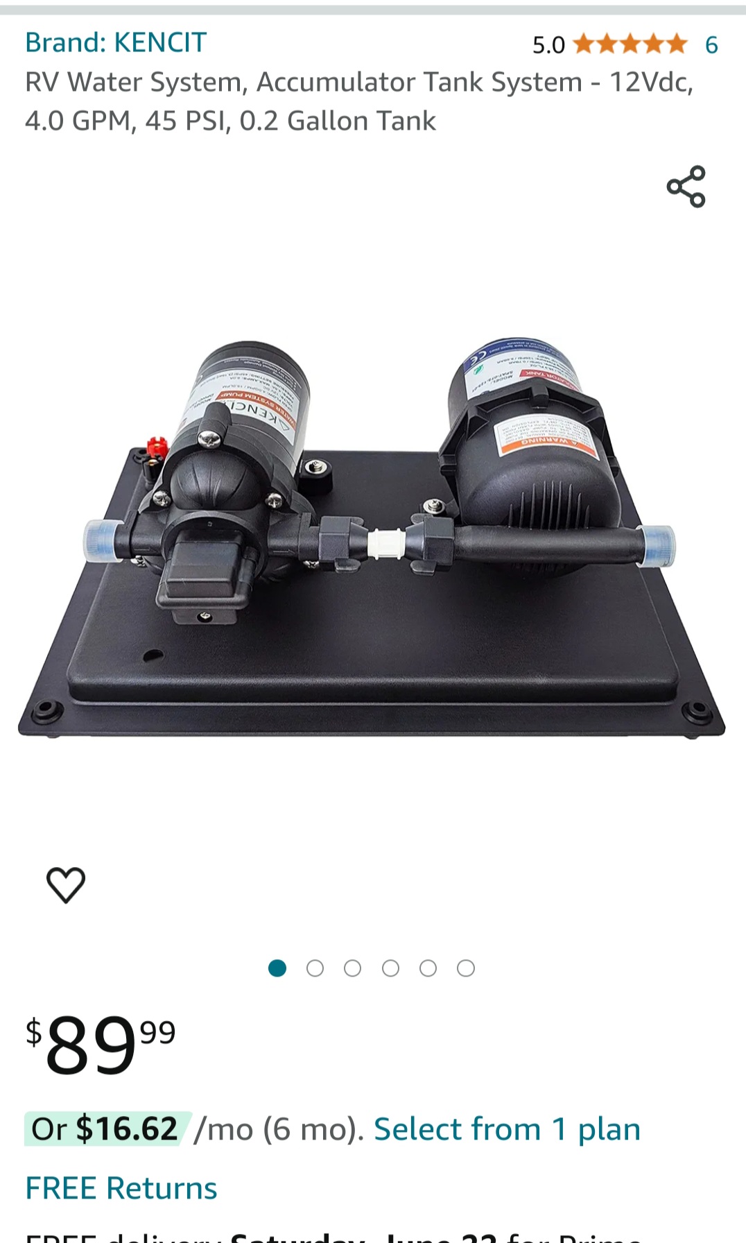

Swani
@KevinD recommended this one to me and it has been working great. Right now it sits right next to my machine with no issues.
Reactions: Papa John
14,630
I've never understood the need for those bladder tanks. My transfer pump is right next to my 100gallon supply tank and doesn't need that little bladder tank.
Can someone help me understand the difference between the 2 setups?
