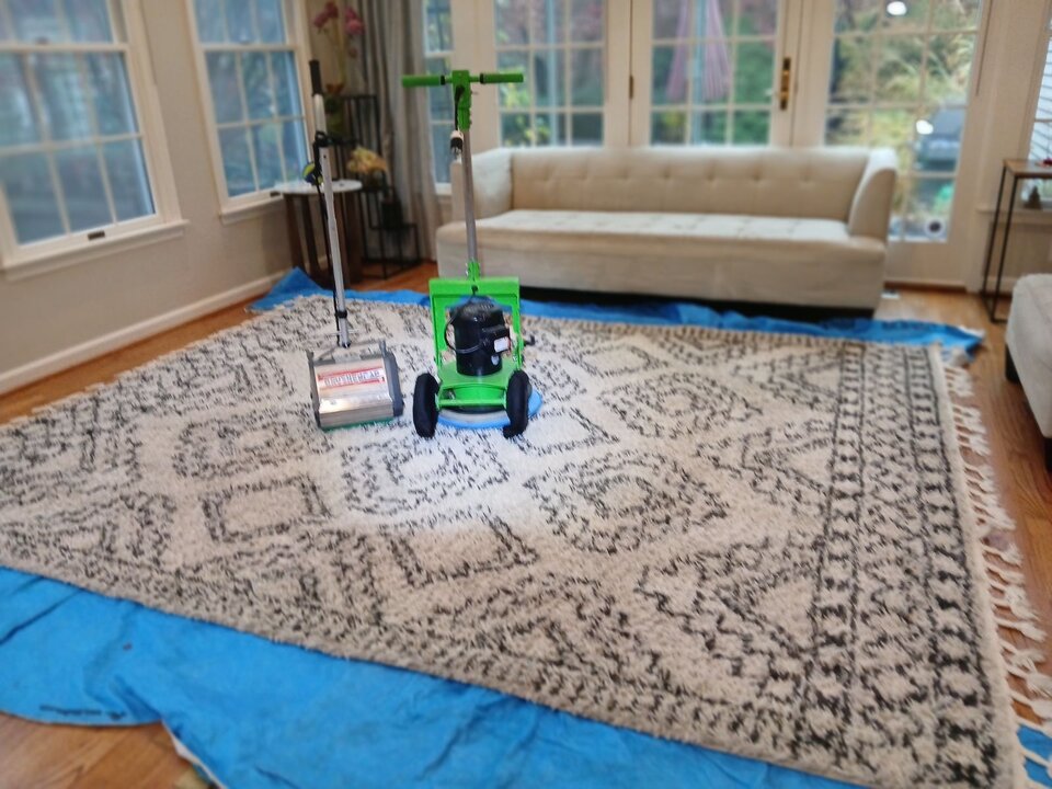

Yes Odyssey is very easy to use and easy going up and down stairs
Before you go into customers house make sure you practice on your carpet
It does have some vibration so you need to be careful around walls shelves and tables
Some bonnets grab carpet more than others and can cause more vibration
Make sure you use a good sprayer and put down enough solution to clean and lubricate fibers. Not enough solution can cause bonnet to grab carpet and cause more vibration
I don't like 10'' CRB's because they are too light to scrub with and too slow but for Area Rugs and to groom carpet after cleaning they work perfectly
I used 10'' CRB to scrub and groom and light blue Microfiber Bonnet with Odyssey to extract on that Area Rug
