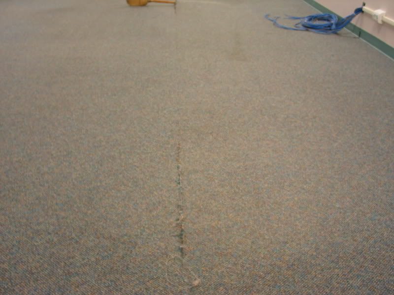

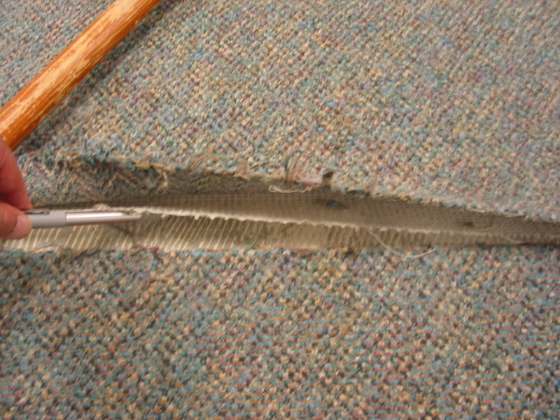

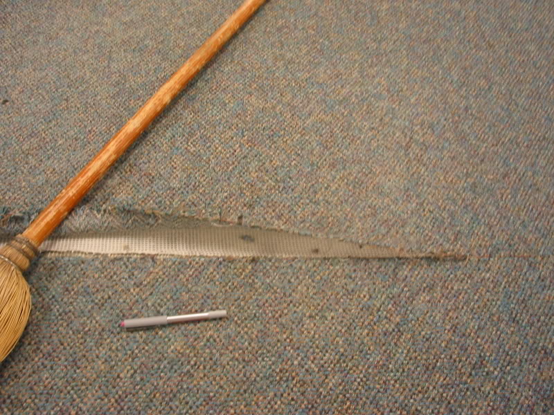

I have been asked to a repair bunch of commom carpet repairs in a 12,000 sq ft office.
This carpet is 5 yrs old or more & it appears to have had no maintenance.
There were no chair pads used and the original Installation ( direct glue down over concrete ) was done by hacks.
No seam sealing was used and so there is approx 106 feet of sprouts alongside a missing stitch row, like this.

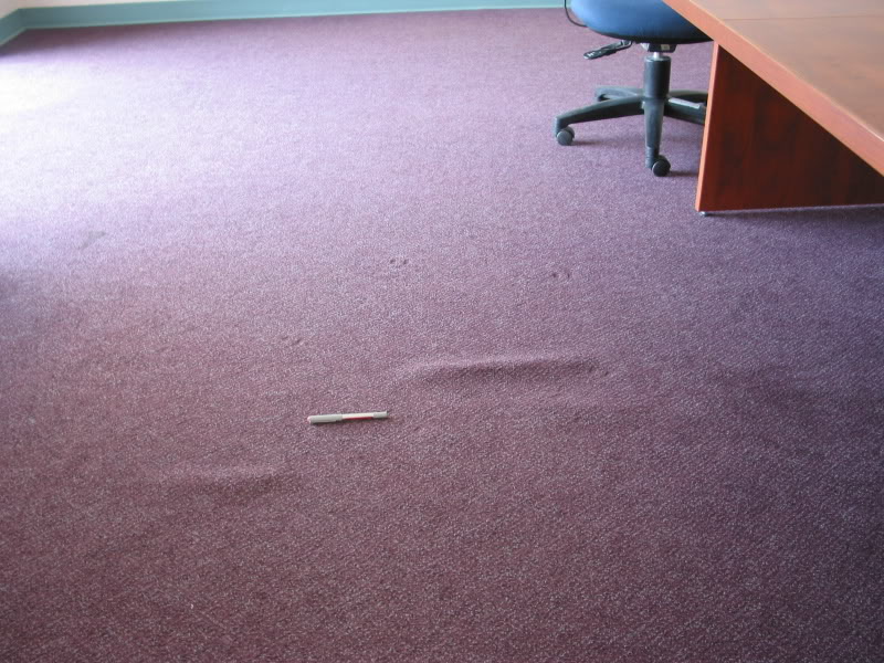

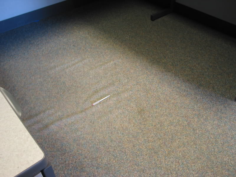

There are 5 rippled areas approx 12 inches long.
Under where the chairs were we have 14, approx 2 foot circles of delamination.
Some of these 14 areas were also beside those lousy unsealed edges resulting in delamination between the floor and the secondary as well as between the secondary and the primary backing.

Hah, Tony uses a STRAW BROOM.... HACK

Didn't know what I'd find 'til I got there and needed something to help me to take pics that illustrated the problems.
Only useable implement was that broom so quit ya whining !!

For the 5 rippled areas, I (without a syringe) would slit along a row and re laminate with latex glue, hot melt seam the cut and then weight.
For the 14 chair delamination areas, (as above I don't know) so maybe buy a big bore needle and inject section after section with latex and then weights. For the ones over joins, which I have repaired before, I'd screed latex into each side and the hot melt glue the seam and weight.

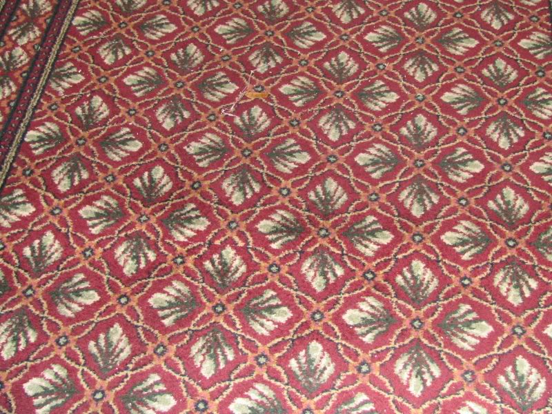

Hi Tony and all,
Pretty neat looking project to work on, too bad we could not do this as a field trip for all here, that would be pretty good to work on as a large team.

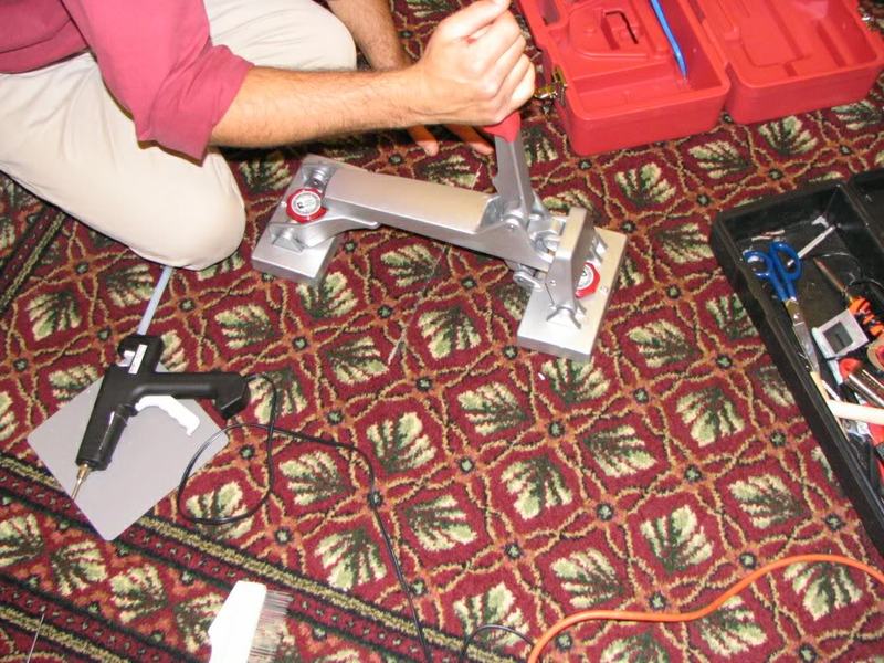

Many of the seams, as Harry and others have said, should be able to be pulled together with a mini stretcher and carefully work the edges, many times very rough edges can be made to look pretty good. The whole place looks pretty rough but then that is why they have someone like you caring for it.
Here is a partial clip of a 4 1/2 inch saddle donor piece I have to put into a 5 1/4 inch area and the donor piece was from a well used piece with a lot of badly frayed edges and I could not even trim them but had to work them in. The video is rather long showing the whole repair but hopefully this small portion will give a good idea of pulling the edges together and working with hot melt to seal. These two edges of the saddle also have Kool Glide tape underneath to fuse it all together when it is finished, hope it helps explain a little.
Stevea
Feb 3, 2007
436
Sorry, I did not mean to send the last post with out a little more explaining.
The mini stretcher allows one to work a portion of the seam, as you see in the video, then you move over and work the next 6-10 inches or so until the whole seam is completed. I hope that makes sense.

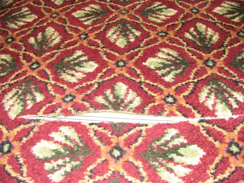

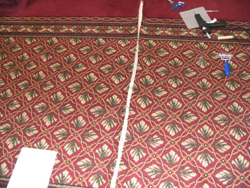

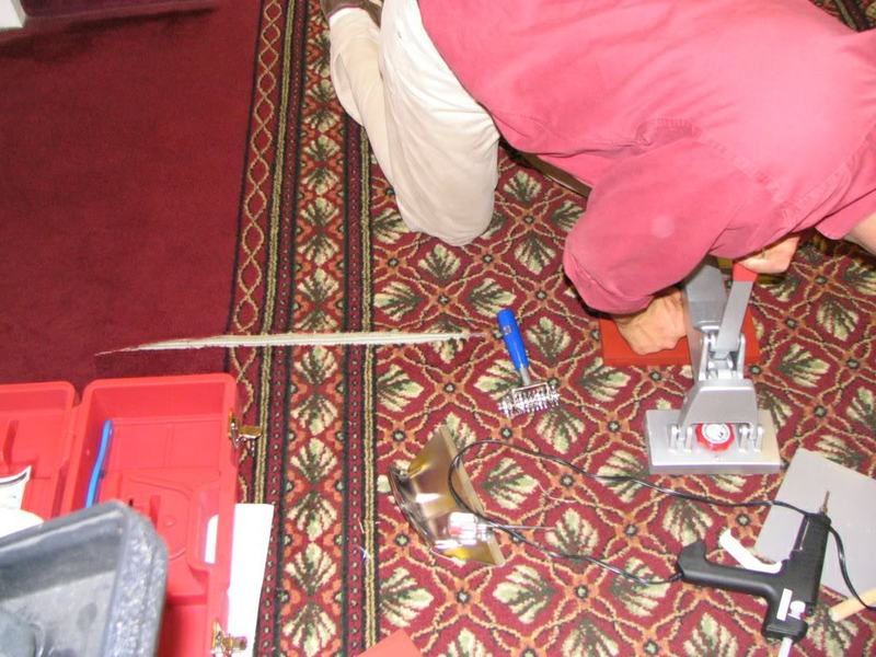

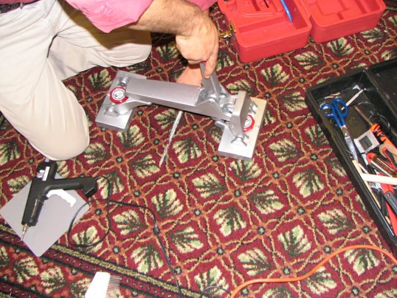

I agree, he will have to re-laminate, this can be done with Hot Melt; Bubble Glue or Latex. I personally like to use hot melt on smaller areas and Bubble Glue on larger areas.
On the seams, if it is possible to dis-engage from the floor, I would put the Double Sided Kool Glide tape down, re-laminate, clean up the edges and hot melt them and finish with Kool Glide. This will hold it in place very well and fuse everything together. I would definitely use the Kool Glide hot melt in my repairs, stuff is easy to use and work and holds fantastic.
Here is a damaged seam:
open the seam to put Kool Glide tape under, double sided tape
pulling together a portion and working that area
working another area
finishing
finished and repaired seam
A seam, even if it is frayed and angled, can still be manipulated to come out pretty good using this method. Working the seam a little at a time helps a lot. This is an area to think outside the box from what is normally done.

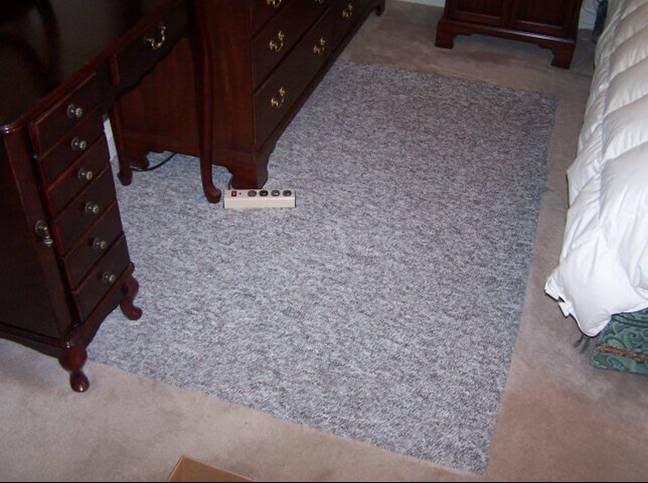

I thought it would be good to show some of the Repair Work Kris does, and his son. He shared these photos of a repair he did and I thought I would share them with this room, I think everyone will appreciate his skills and I hope he shares more with all of us here.
He had a client with a terrible 'patch' in a room, so he took several pieces of carpet and made a very large 'patch' and replaced the old bad patch. Looks pretty good but notice how he had to make a large piece by use of several smaller ones, the sewing of the backing and sealing and then how he used the Kool Glide to put it in place, quite a good job. His son is only about 12, I think, but obviously a good technician in the makings.
Hope you do not mind me sharing these with the room Kris.
Bad patch, watch the series of steps to repair
repair in progress; please click on photo to start slide show
before and after
Pretty nice job.
SA
