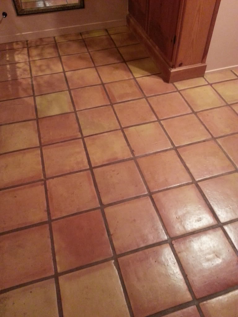

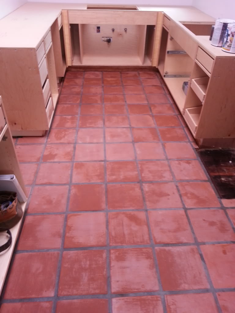

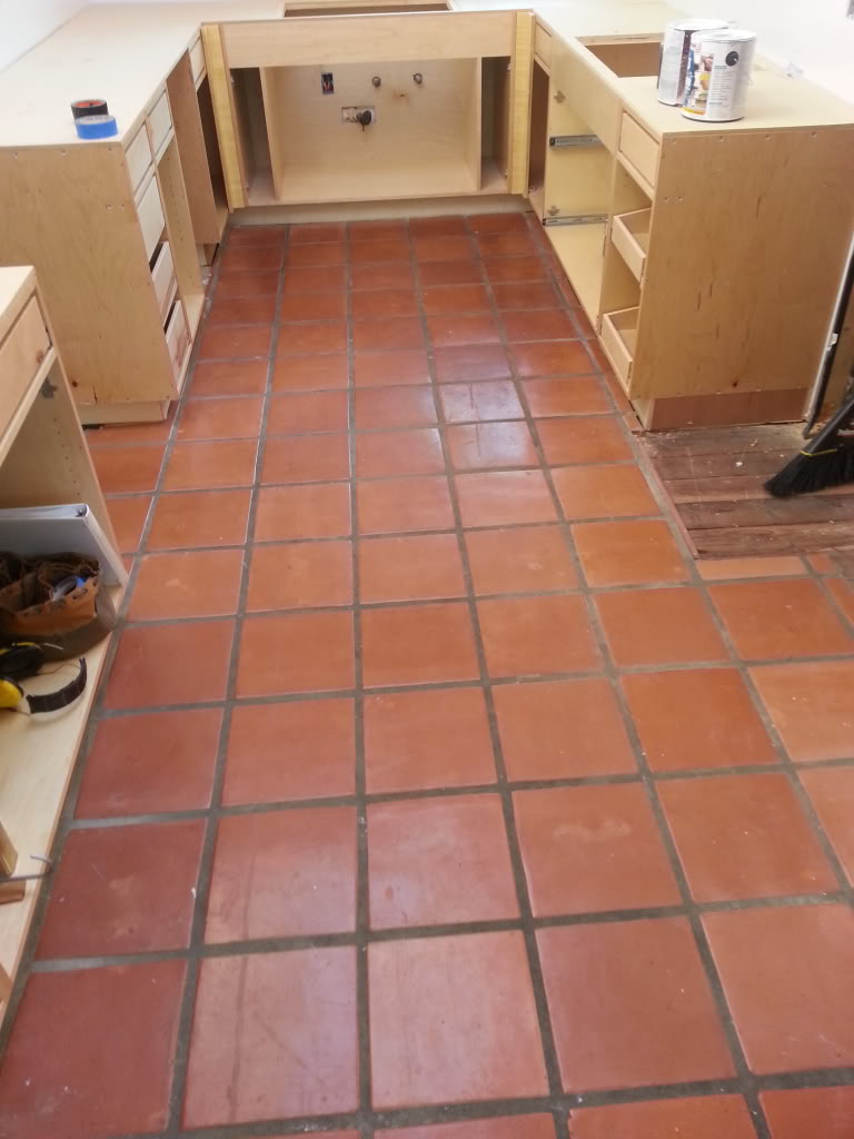

today's Saltillo Job
116,113
just these 70 or so feet took 2 hours to strip.

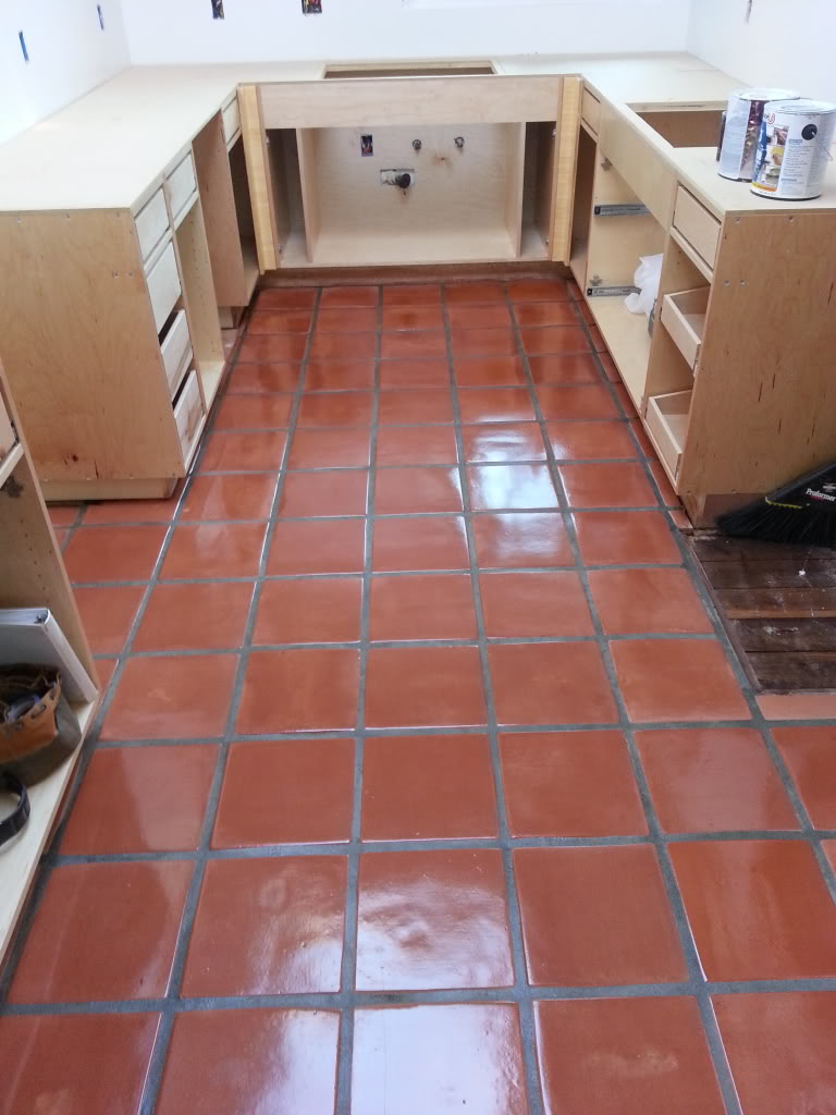

I'll go back tomorrow to apply 4 coats of wax/ finish
pretty much have to charge $10 a foot to make carpet money stripping Saltillo tiles.
20 plus year old floor, never dealt with..

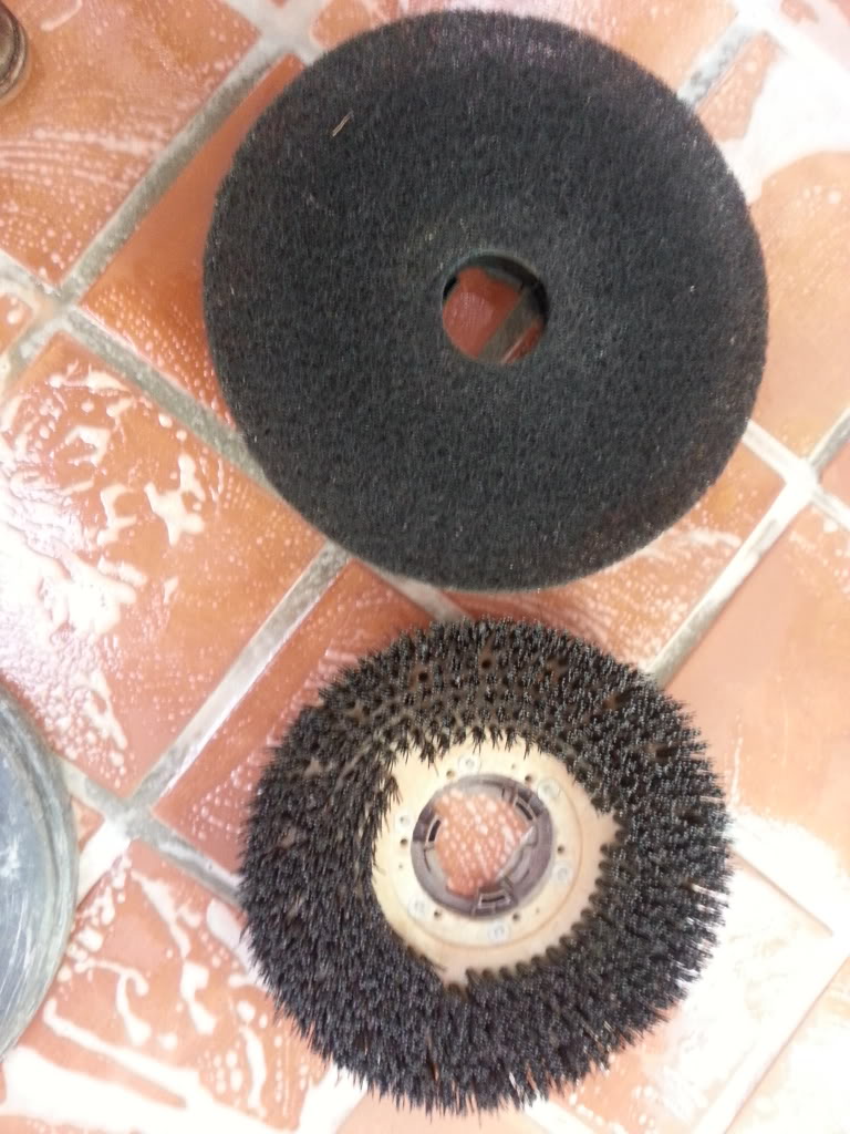

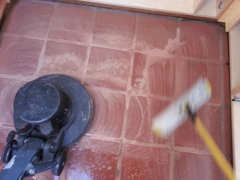

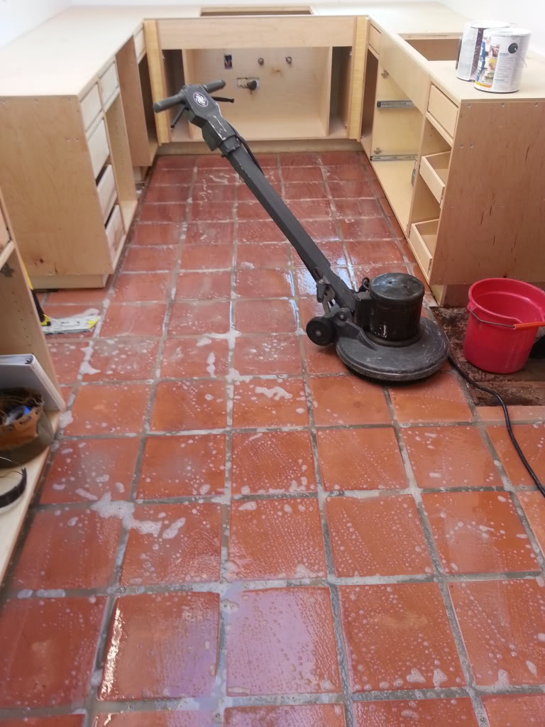

soaking in Zep stripper
Went over and over and over with a Malgrit brush and a black pad..

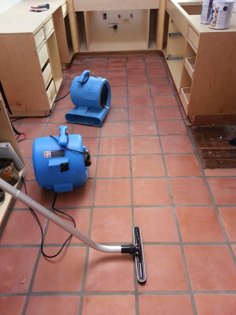

fully naked and drying..
more pics tomorrow..

flat mop it on Dave.
good finishes self level and dry in 10 to 15 minutes.
thats the easy part.
getting the old stuff off can be a nightmare, especially if different products were used over time. If some idiot put an epoxy or lacquer finish on it, run like hell.
strong stripper, scrub scrub scrub rinse repeat...
