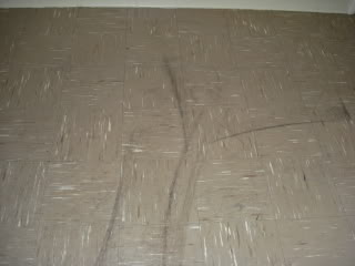

look at the pics guys...its a bit beat up, but it may be saved by a scrub and a recoat, if those black marks can scrub off...

You might be able to make it look ok with a scrub and recoat. A strip will get it as close to new as possible. If you choose to scrub and recoat, please don't bother with a red pad. As a tile newb, you will slit your wrist after the first hour.. You need a good strong alkaline cleaner, and a blue, green, or brown pad (depending on brand.) If you can remove the black marks, and make it look clean enough to please them with a scrub and recoat, a couple of coats of I-shine should make it look nice. I don't really have the time to go through the whole procedure for stripping right now, but I would be glad to walk you through it over the phone. You WILL want at least one helper for your first stripping job. At .65 psf we would make pretty good money. If they are empty, not a bunch of tiny rooms, and the base is rubber cove, it is pretty straight forward. If you can scrub and recoat for that price, you can really make some good easy money. The biggest thing is to NOT try to pick up the stripper slurry with a mop (lot's of old timers did/do that.) Your biggest problem will be getting the floor perfectly clean without a auto scrubber. The best way to make sure it is clean is to vac the stripper slurry up, flood with with a clear water rinse, then vac that up, then rinse with the mop. That will eliminate the hair and left over stripper boogers that a lot of people cover with floor finish..

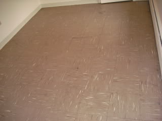

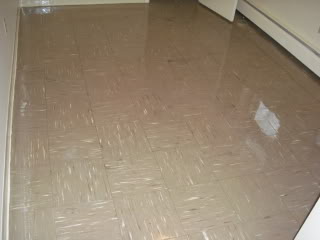

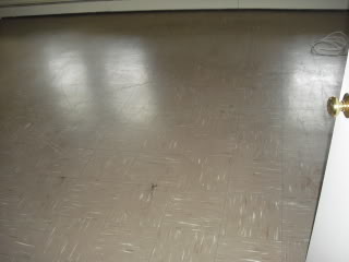

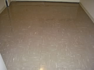

Went to the local Hillyard location who also helps to fix my TM issues. They rented me a 175 for $20. I bought a Doodle Bug, pads, Cleaner, finish mop and handle, blue floor pad and high solids finish. The total bill was $115 including rental. Job took 4 hours. 490 sqft. Job Gross $515. More than $1 per square. Customer was thrilled and offered me his other commercial business work.
I mixed 8 ounces to two gallons of water in my pump up. (Leaves me with 120 ounces of cleaner yet).
Stripped or cleaned with blue pad.
Vacced up slurry with shop vac.
Rinsed with clear cool water.
Dried it up, and rinsed again.
applied first coat of wax thin with finish mop.
Went and cleaned 1 room and stairs in neighboring town ($125)
Came back and applied 2nd coat.
Dried with air mover tilted up, so as not to create ripples in the finish.
Applied 3rd coat and finished.

BEFORE
AFTER
BEFORE
AFTER

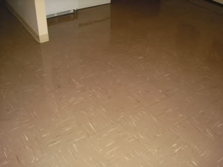

We never spin buff. Always strip and reapply wax. We use nothing but a good quality wax and stripper and f those pads. We spend the money and use a bristle pad for stripping.
Before
After
