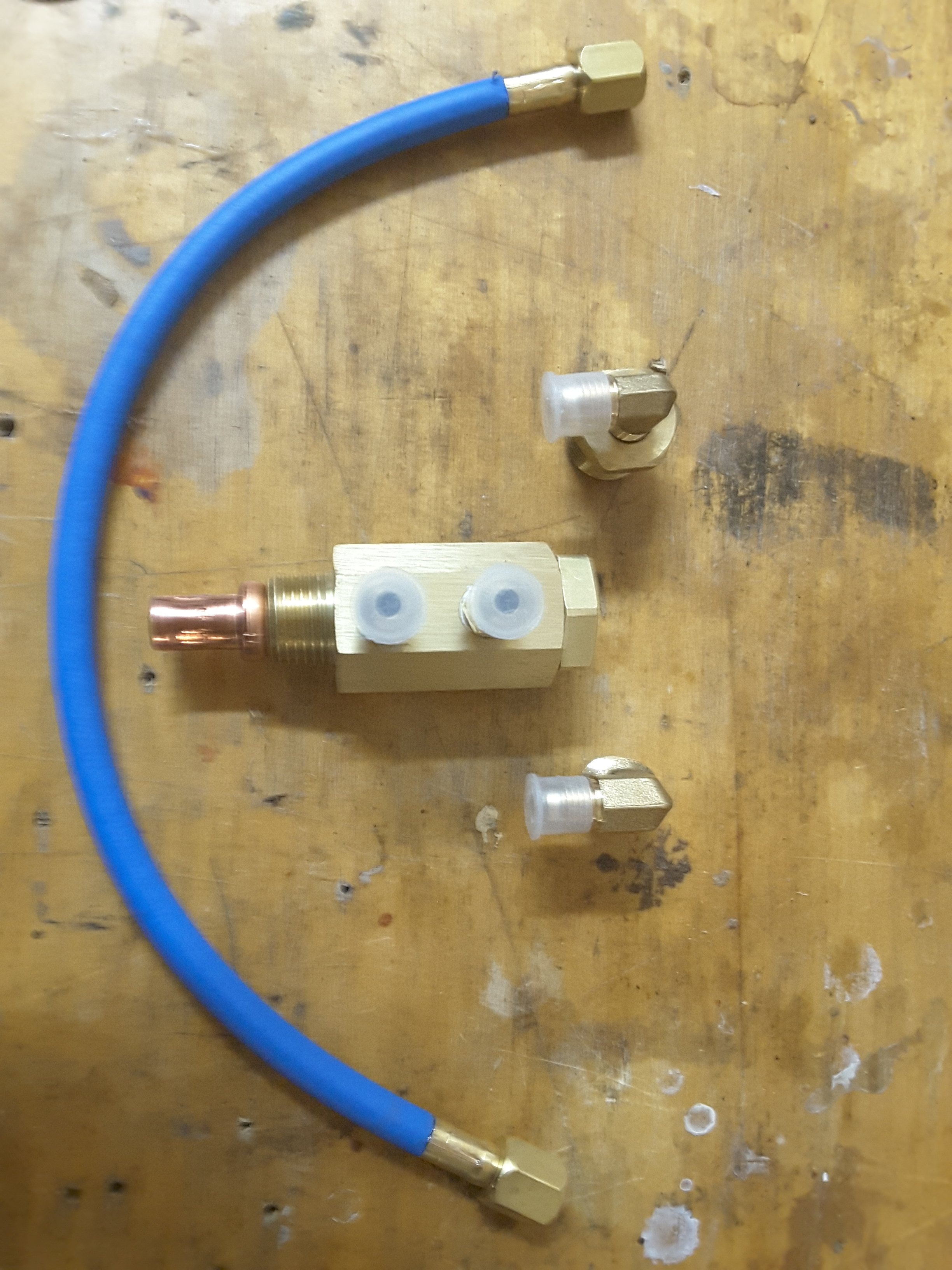

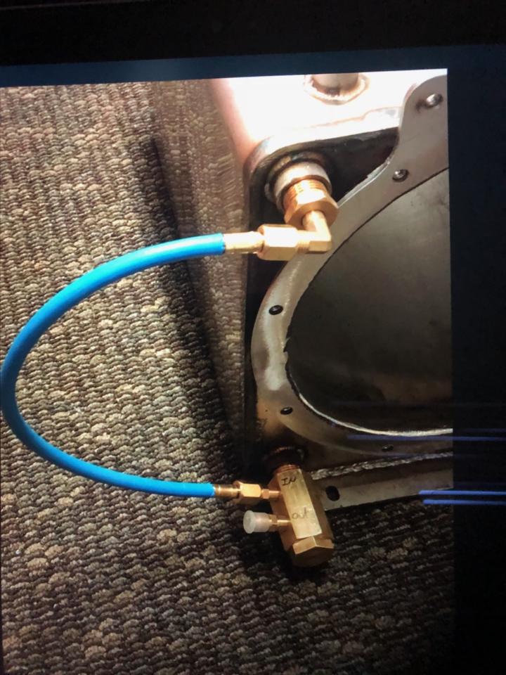

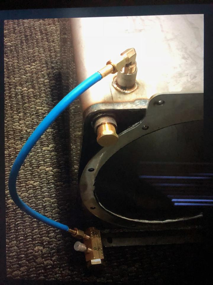

This replaces the Parker wax valve that randomly dumps hot water into your waste tank.
Excessive hot water from inside the box, as well as steam, taken from the top as seen in the photos, are now routed to the waste tank.
This new system is proving to be much more consistent and reliable.

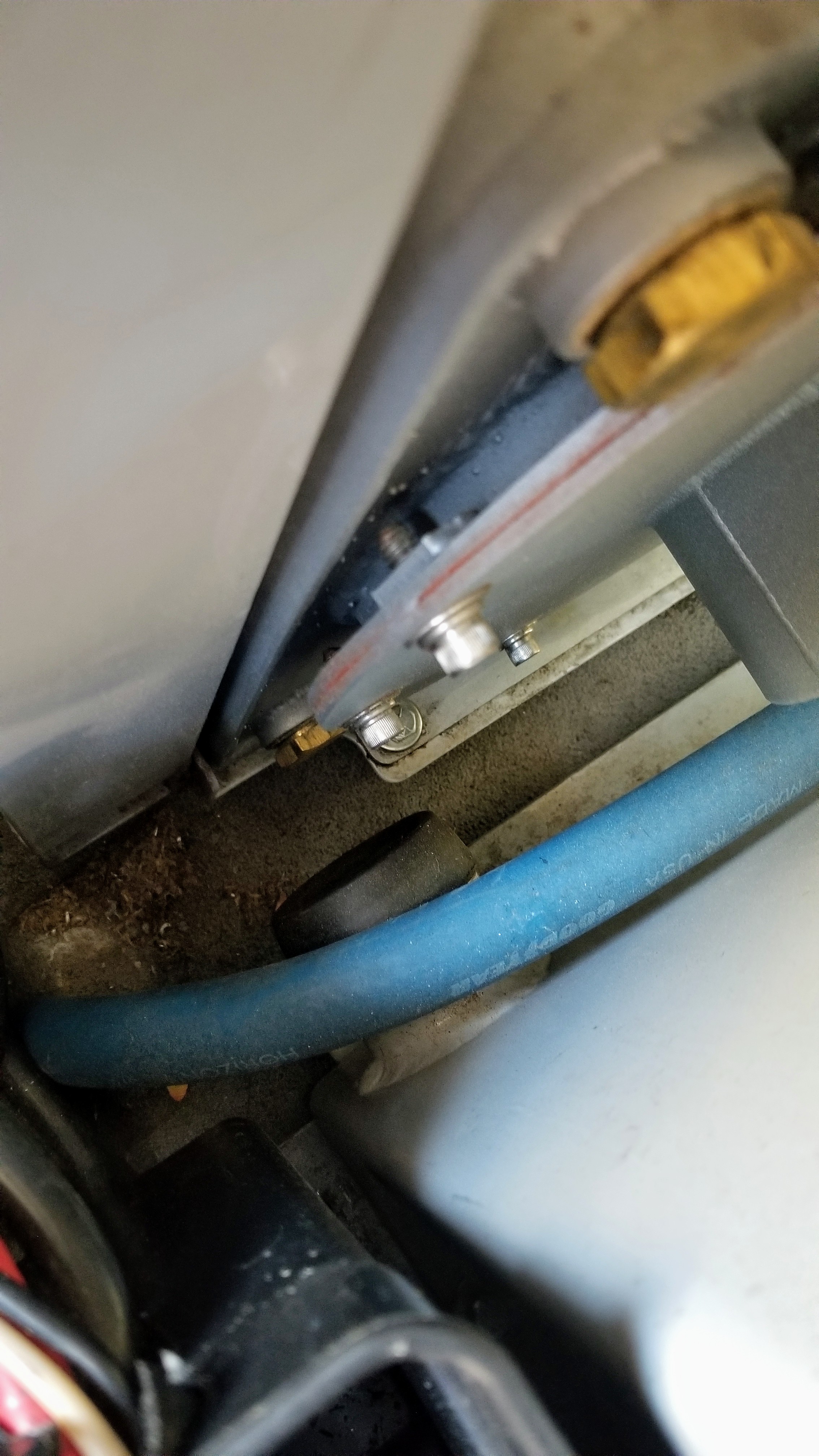

I don't see the point in that valve. I used a steam release valve for a hot water heating system.
