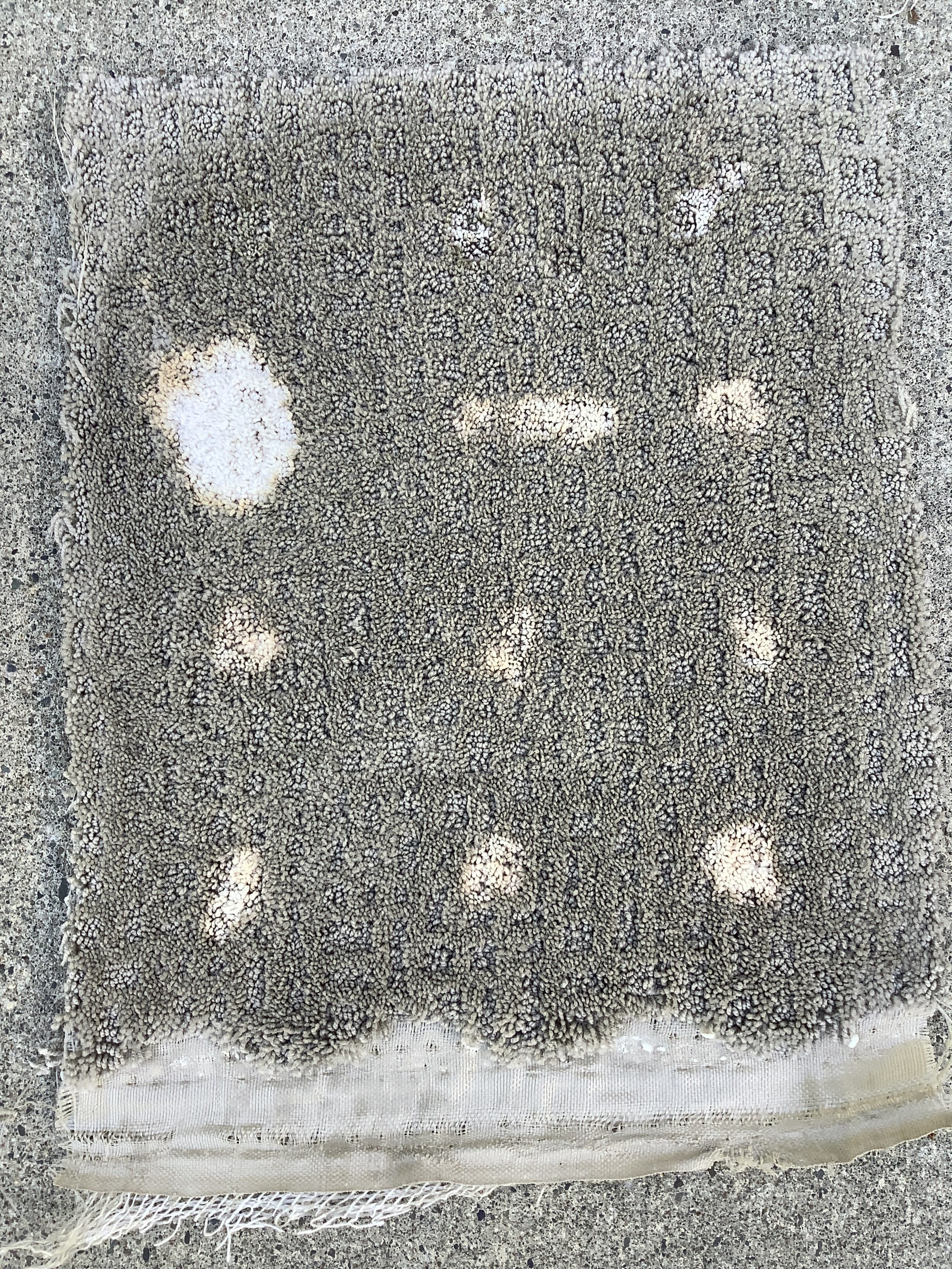

My first practice on my own after taking Chris’ class. It was worth every penny. I have gotten perfect color matches on a dozen spots after this one, including a half dozen real world color repairs.

I've gotten better but I'm still not consistent, I need to practice more
