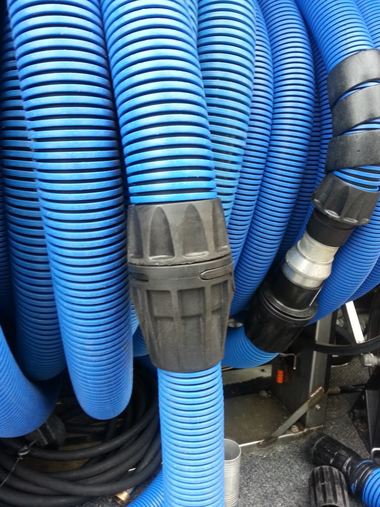

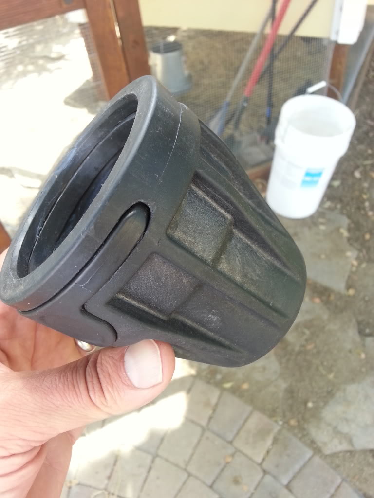

I've had two sets of 2.5 for over a week and aside from some incompatibility issues wiht the old and new design with females staying on 2.5 starters, they are great!
THEY DO NOT COME APART< ARE EASY TO USE<DON'T HAVE ANY LEAKS WORTH NOTING AND DON'T MAKE YOU DEAL WITH A CONTROL FREAK TO PURCHASE.

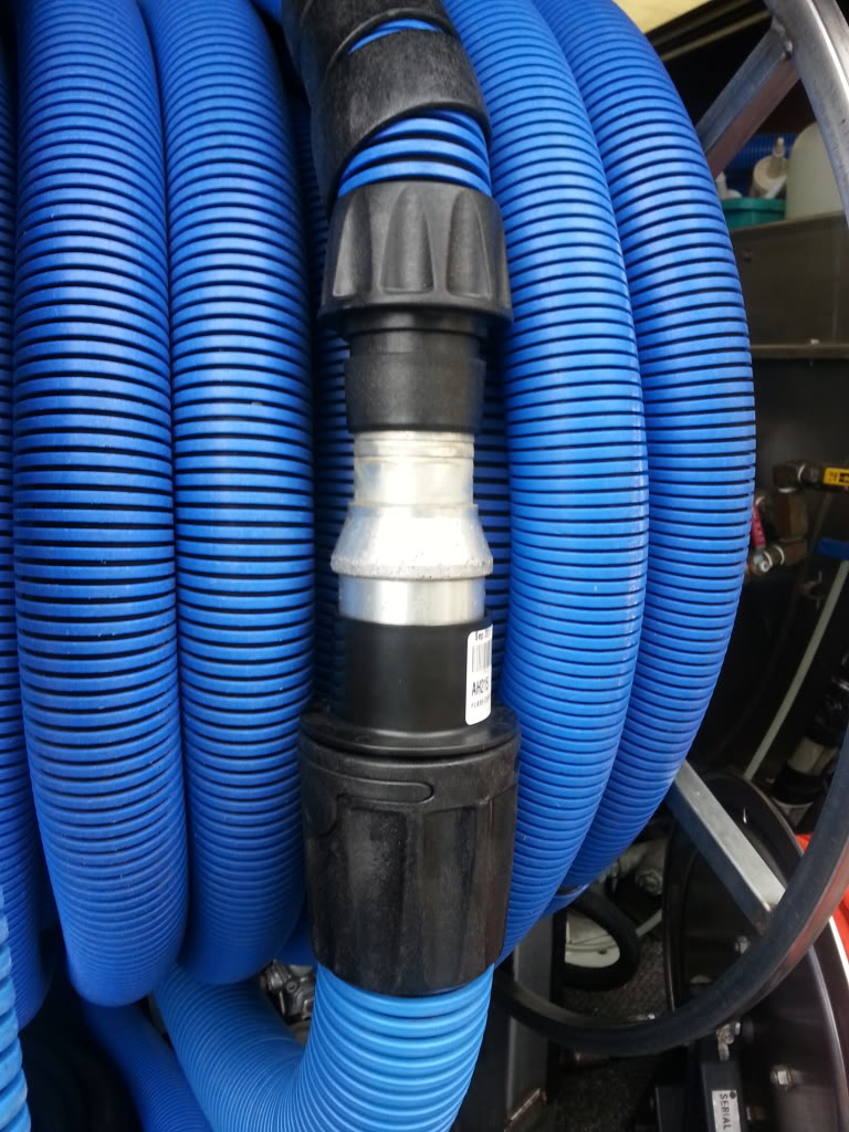

I found the 2.5 to 2" reducer..

so when you get a chance......so me the reducer all hooked up and do they have something that hooks onto filter boxes or the devastator filter to hook your hose into right off the reel..........

OK me......do you have this set up only in the flash cuffs.........
I can hook the 2.5 hose straight to the filter box..or the 2.5 reducer.....

The 2.5 starter cuff is part num.AH215 the reducer is AH217. Superiors site will be updated by or before beginning of next week with the new version of flash cuffs.

The cuffs I got when they first came out, don't fit the ones I ordered a month ago. Can't even get the new ones to screw together.
