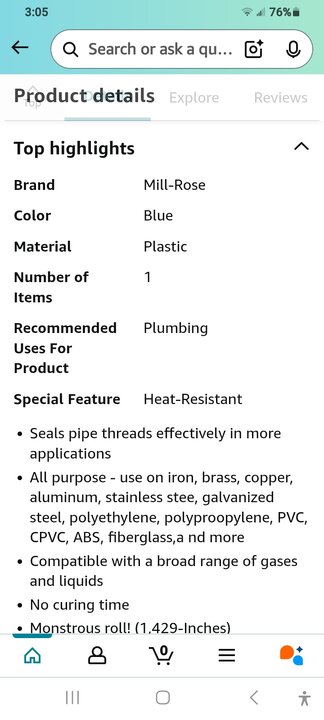

You're welcome, that's one of the things i picked up working around shipboard turbine engines the nickel infused in the tape helps prevent threads from galling. There is other sealant tapes that is supposed to be "stainless compatible" like blue monster tape and are ok when stainless goes to brass or soft steel but for stainless on stainless i only use stainless teflon tape ( blue monster is my go to sealant tape for all other applications)
Screenshot_20250802_150600_Amazon Shopping.jpg Screenshot_20250802_150542_Amazon Shopping.jpg

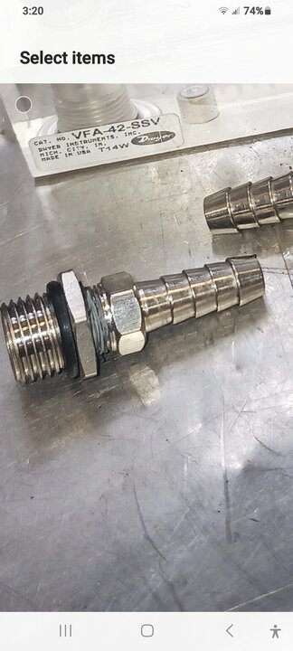

When i install fittings on chemical meters i always first remove the piece from the meter, connect and tighten the 2 pieces then install the assembly into the acrylic that way i have less chance of damaging the meter. (Learned that the hard way)
