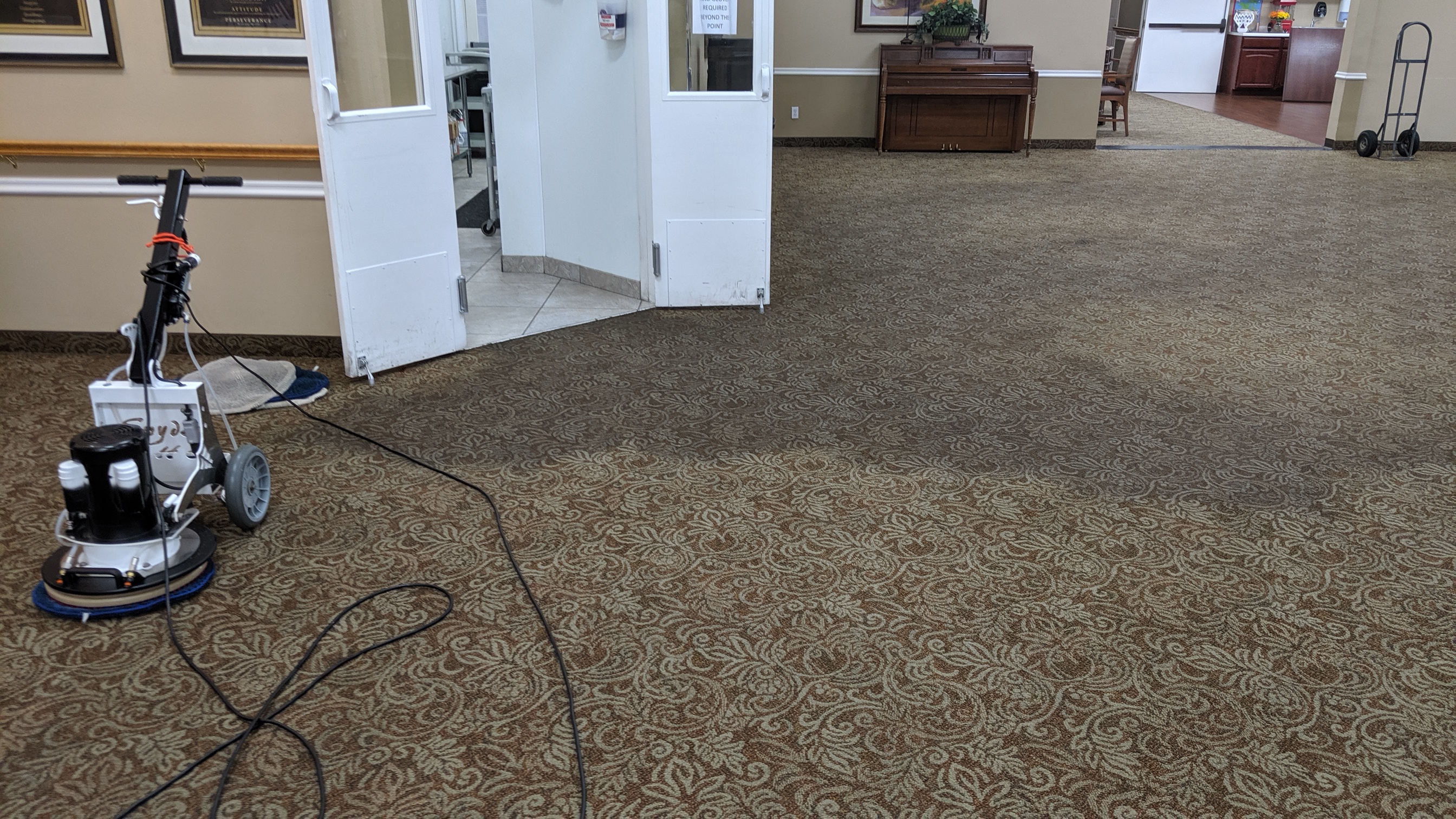

I don't think you want to vacuum afterward. Even if it feels dry, the product hasn't had time to crystallize yet. Let the maintenance people do the vacuuming at least a day after. 12 hallways done by 11am. Started at 9. $720 and I am having lunch. I'll do another 12 hallways today and finish off tomorrow. Couple of amenity rooms to clean as well.

what pixie juice you be using Ronald?
Today I'm using Esteam Crystal Encap. I got a case for free. It seems to do a good job. Dilution rate is 4 oz per gallon but at the end of the day it gives me a headache. The hallways are vented, the odor is ok but the fumes seem a little strong. Overall, the customer is happy. The council president was inspecting my work and pronounced it good. Can't ask for anything more. Did 27 hallways today, tomorrow I have 3 more and the amenities rooms.
