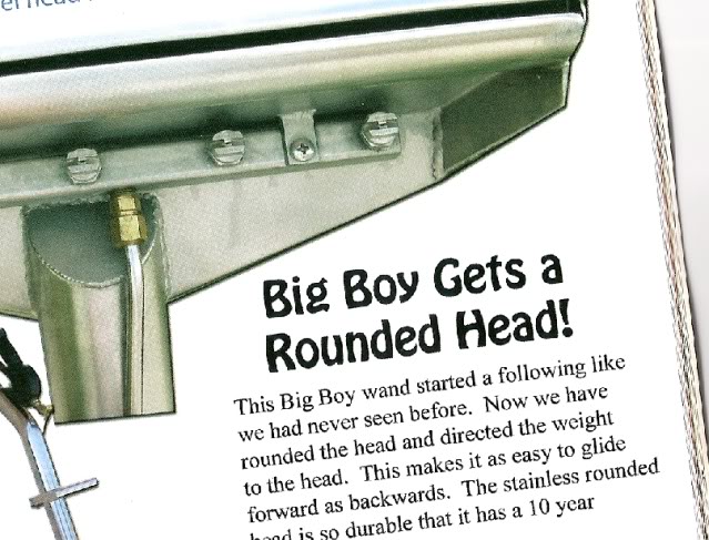

Tell me what's wrong with this wand.

I can't see how you could put a glide on it.
It needs anti drips or jet extensions.
Need to be able to aim the jets more forward.
The flow is comprised by how the tube attaches to the wand head.
The tube hand grip is too narrow.
15,253
Its the edge of the slot.
It will wear and cut into the carpet.
Like my reasoning its all in the rounded edge that makes a wand "Glide".
Not so much in the expensive to replace teflon glides.

Its probably quite heavy with the extra SS.
Some may like the valve on top but I found it very uncomfortable.
It looks like they did something funky where the tube is attached to the head.(May reduce air flow)
Looks like the corners of the vac openning will for sure snag some longer napped carpet.

Solution line going into the manifold isn't centered. I don't know if that will make a problem balancing the flow or not. But it some how doesn't seem right.
There's also a gap at the edge that looks like it'd leak a ton.

looks awesome, send me one!! JK, edges will get sharp and cut carpet.

yadda.yadda.yadda.yadda.yadda.yadda.they ar marketing it as a glide after all the controversey over glide marketing yadda.yadda.yadda.yadda. yadda.
