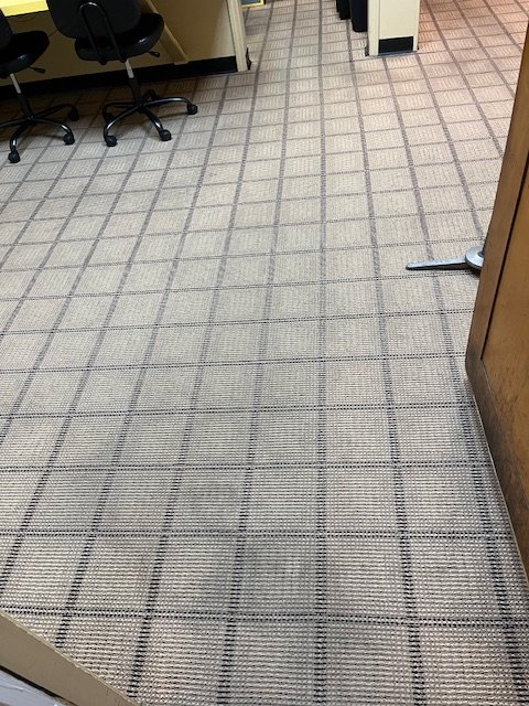

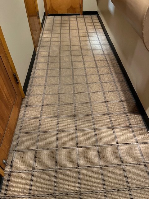

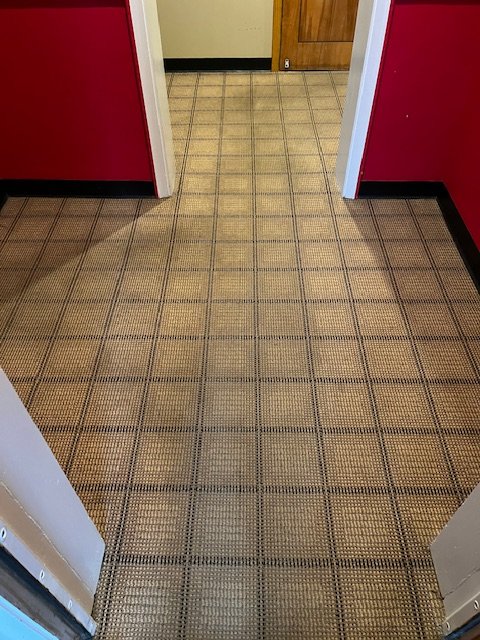

The photos are of a radio station "carpet" that we have cleaned twice already (the color difference from photo to photo is just because of lighting). The reason for the scare quotes (" ") is that it is different than anything I've come across before. The pile is low, hard and kinda corded. I didn't test the fiber but suspect it is either poly-p or poly-e. As you can see, the walking paths are very distinct and have been since before we cleaned it the first time. The color is dingy but there isn't any noticeable pile distortion.
As previously mentioned, we have already cleaned and recleaned it once. Our cleaning process involves application of prespray, CRB agitation, then high-flow rinse using a Steamin Demon. The first time we used Procyon as a prespray, the second time we used LST (after testing LST against full-strength Perky spotter). After two cleanings I would say that the improvement has been about half of what I would be happy with.
Thoughts and suggestions are welcome.

Thanks, Mike. I don't have either machine, only a Multiwash CRB. I believe I still have some release it, but it is several years old, so probably something fresh. My distributor carries Saiger's products.
View attachment 125842 View attachment 125843 View attachment 125844
I am sure you have though of already, BUT, possibly, high quality commercial continuous loop (almost, but not quite berber)
glue down, over a concrete slab , that maybe is not level. High , low spots that prevent your SD machine from extracting efficiently?
AND, Only because you said "we" . When HWEers clean with a scrub wand we can tell / feel when loosing the seal due to the unlevel surfaces. Not sure how much the "we" part plays into it. .

Rather than reply individually to each message, I hope it is OK to post this collective thank you to everyone for the suggestions.
Overall, it's not wicking, although one spot in the doorway of the bottom photo was not that way when we were done, so it almost certainly is (probably due to a little leaking from the Demon). The carpet doesn't look better when we're done, then worse as it dries. Those walkways just ... stay ... dingy! I think I'll try Mike's suggestion and rent a swing machine and use an encap product to bonnet clean it. As is evident by the fact that I don't own a 175, I'm not a bonnet guy. In truth, I don't do much commercial work (happily so).

It appears like one of those pain in the rear carpet that no matter what you throw at it, it ain’t budging.
put away the hwe. Use 175, cotton bonnet and encap of your choice. They all work pretty much the same. Some stink while others have a pleasant scent.
if it remains the same or some what of improvement, it’s one of those carpets that are a pain in the ass and will never look any better.
I could be wrong but I’ve had my share of nice looking commercial carpet that just ain’t changing much in appearance.
