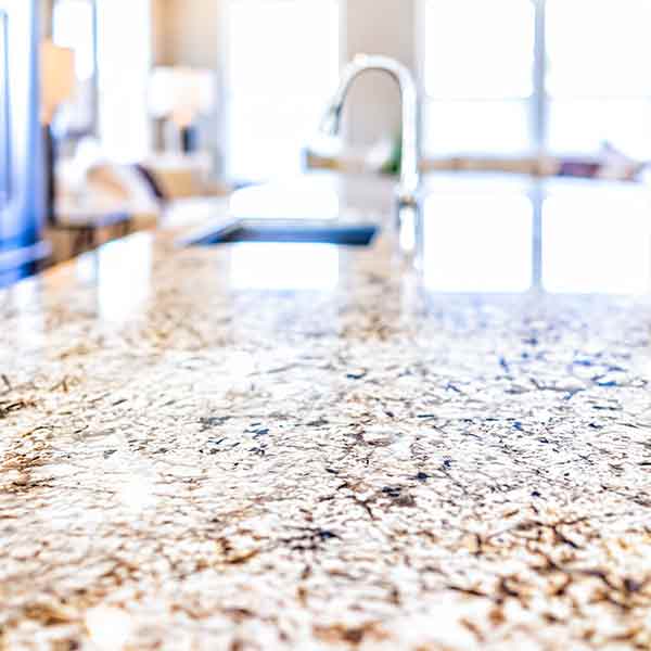

Can you help me identify what this countertop is made of
The countertop in the image appears to be made of granite. Granite is a popular choice for countertops due to its durability and unique natural patterns. The material is characterized by its granular appearance and can come in a wide variety of colors and patterns, including specks, swirls, and veining. The specific variety in the image features a complex pattern with a combination of light and dark colors that suggest a high variation typical of granite. This natural stone is highly durable, resistant to heat, and when sealed properly, resistant to stains and scratches, making it an excellent choice for kitchen and bathroom surfaces.
