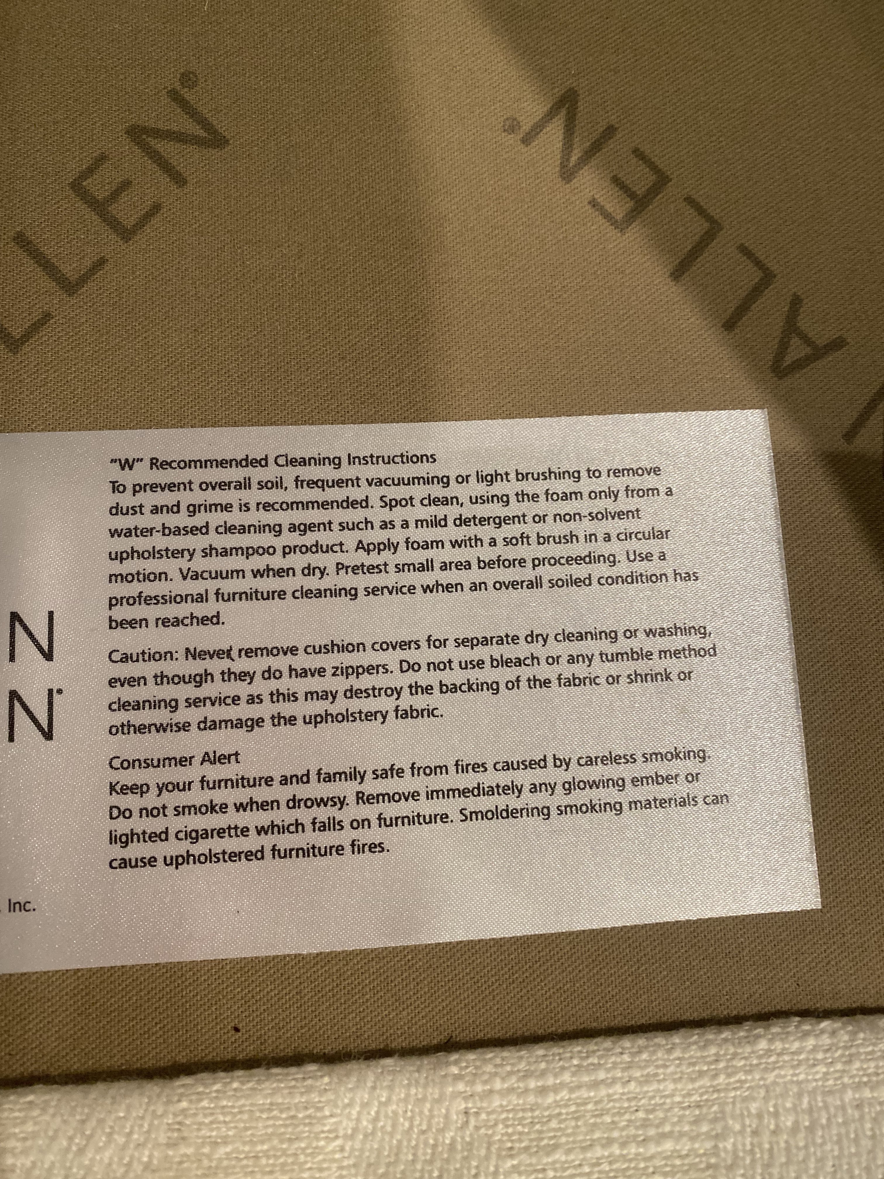

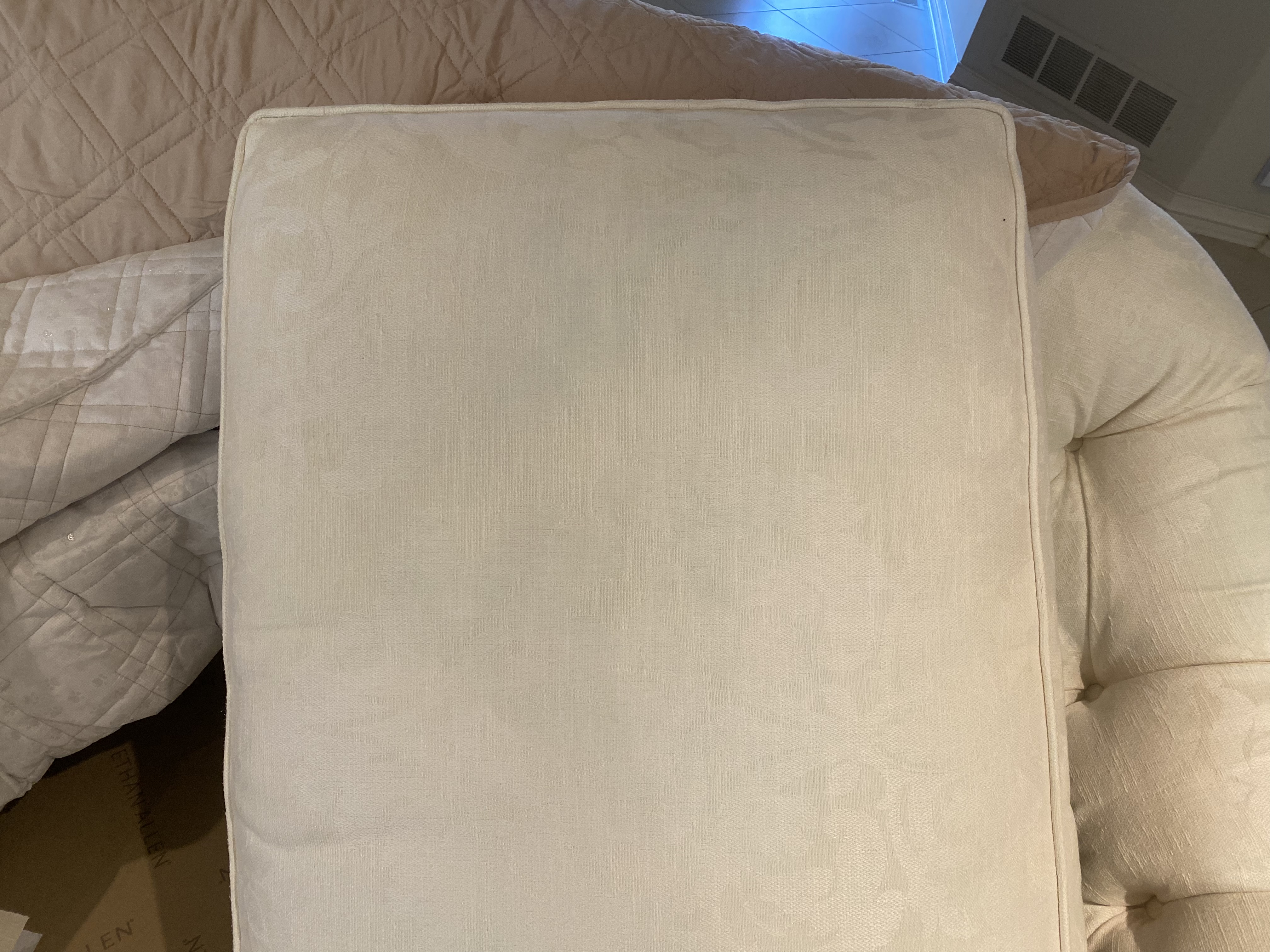

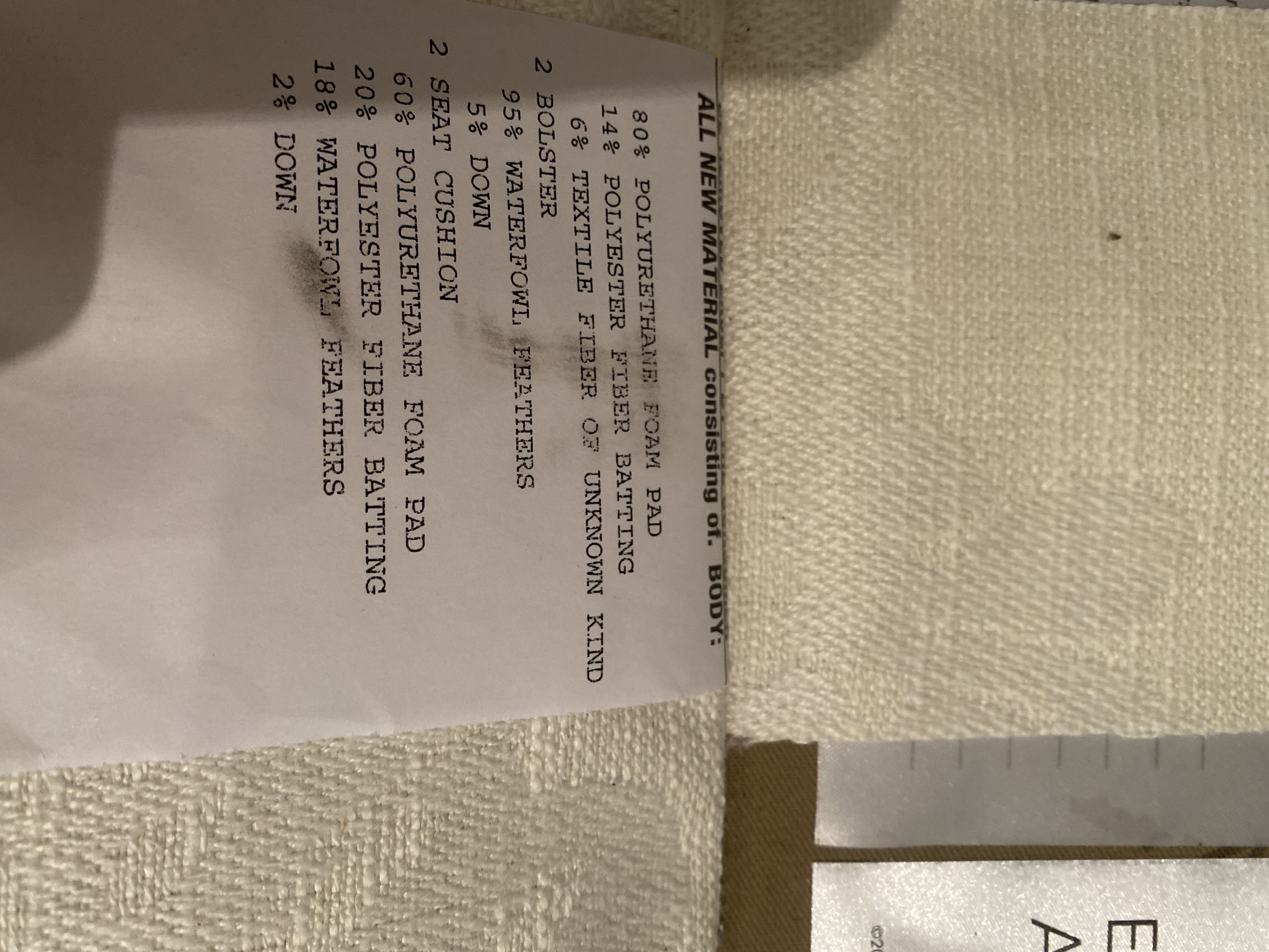

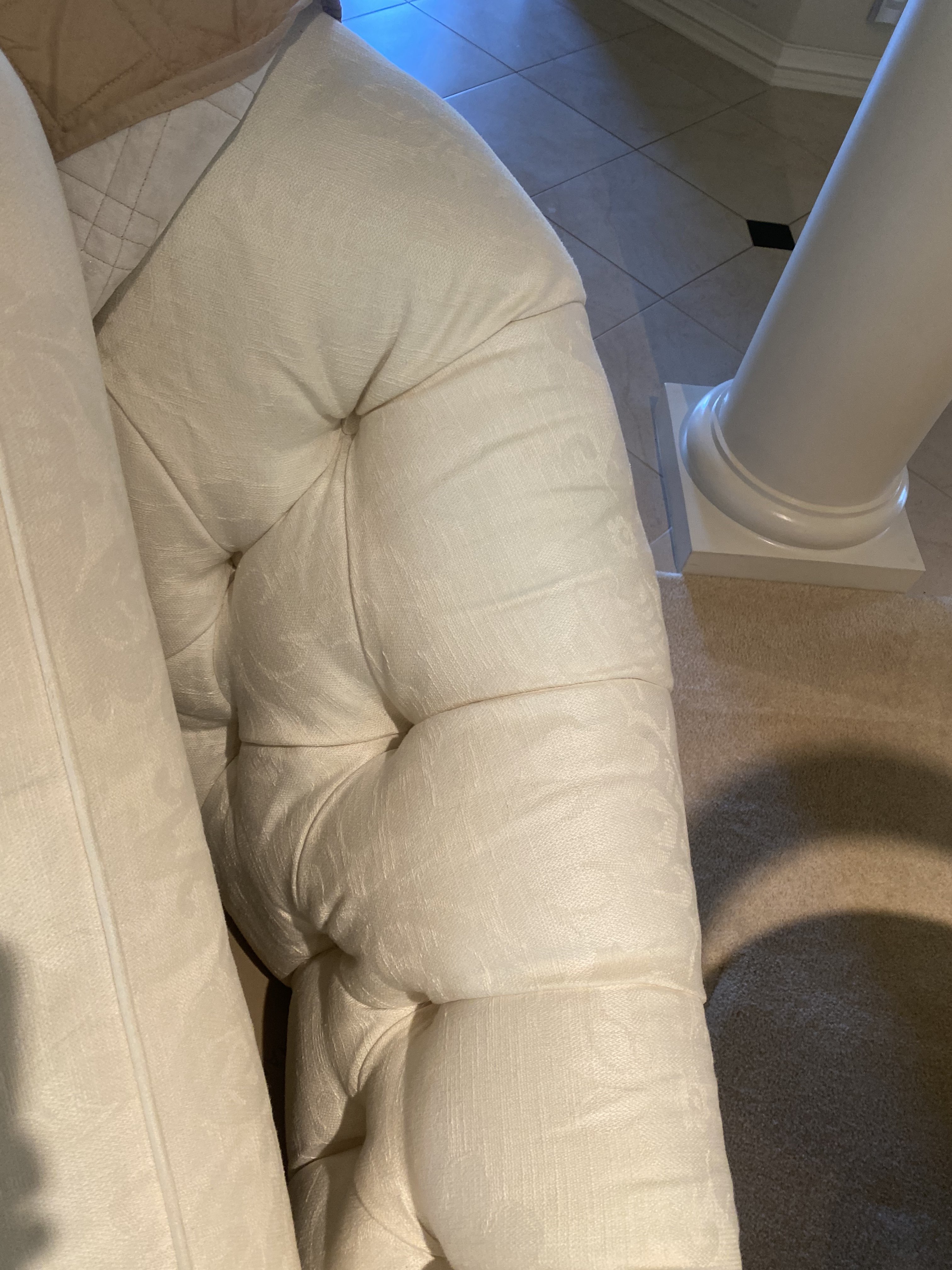

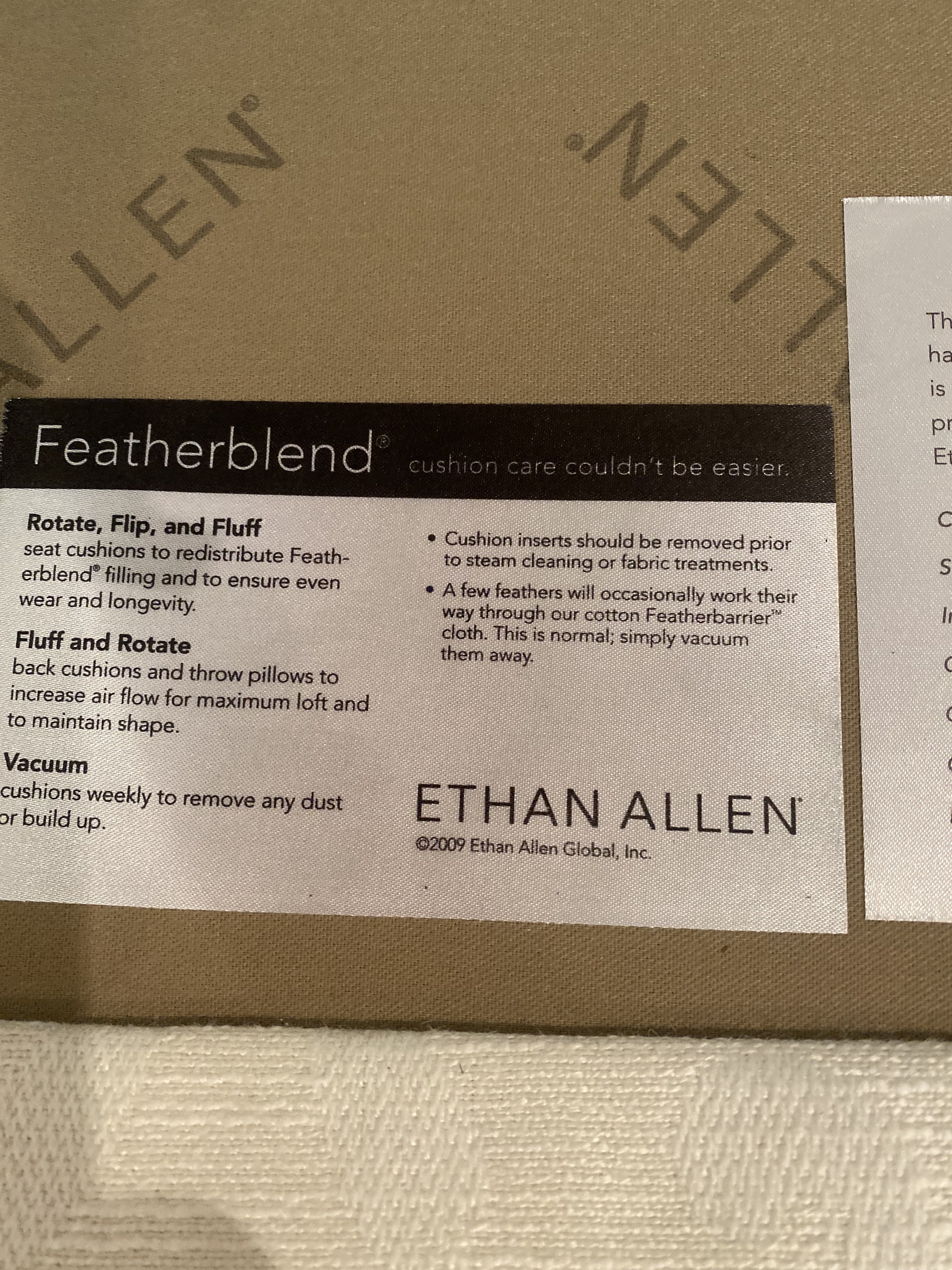

Cleaned an Ethan Allen white sofa with my usual upholstery cleaning shampoo which is about a neutral PH and had a blue color. After cleaning couch was left with a blue Hue (see pictures including fabric tags). Tried thoroughly rinsing to no avail. Any ideas on how to remove blue stains? Thanks in advance!

The tags you showed only tell you the material that is beneath the fabric, not the fabric you cleaned.

But did they sit or lean on the inside back with something dark blue too? It appears it is both on the cushions and the upper inside back from your pictures.

no I know it’s from my cleaner, the sofa was perfectly white prior to my cleaning. I’m going to get a cushion from the Custy to test. Thinking of oxidisers, reducers and hydrogen peroxide. Thoughts?
