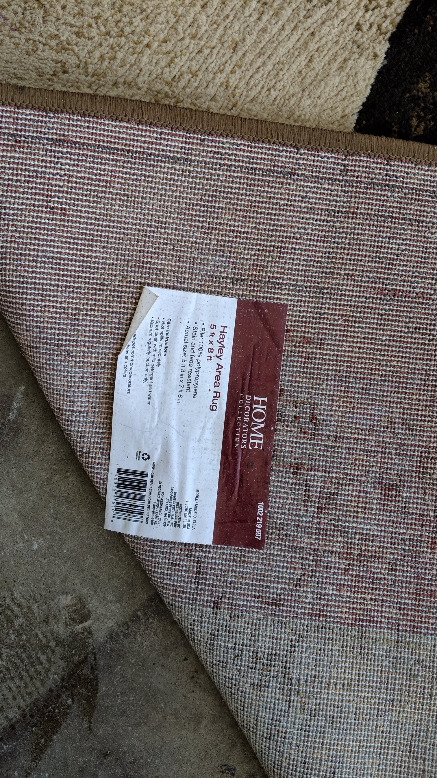

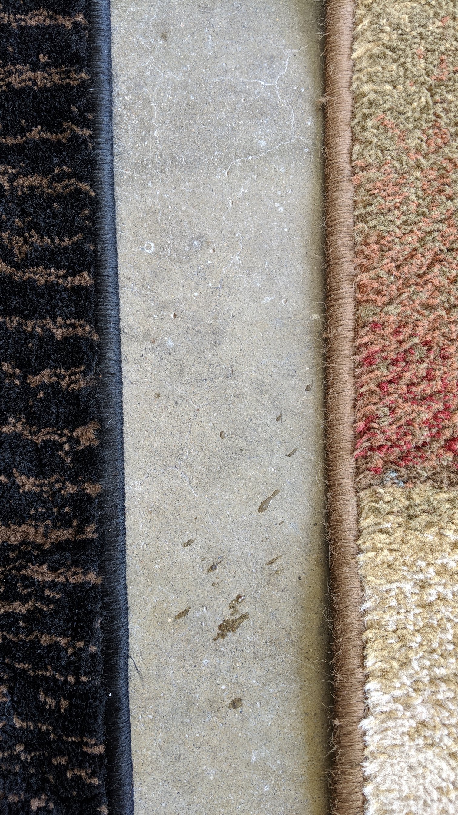

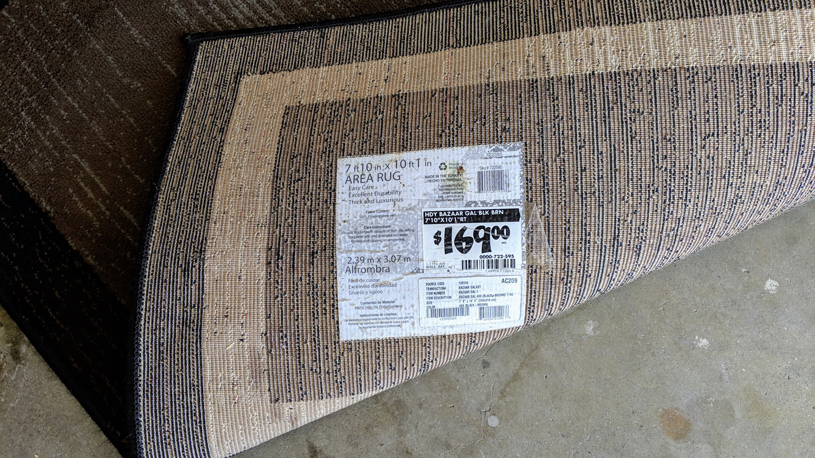

I would charge $200 plus pick up and delivery. I don't think I have ever had an olefin rug ripple like that. Probably because I hang and dry them.
27,863

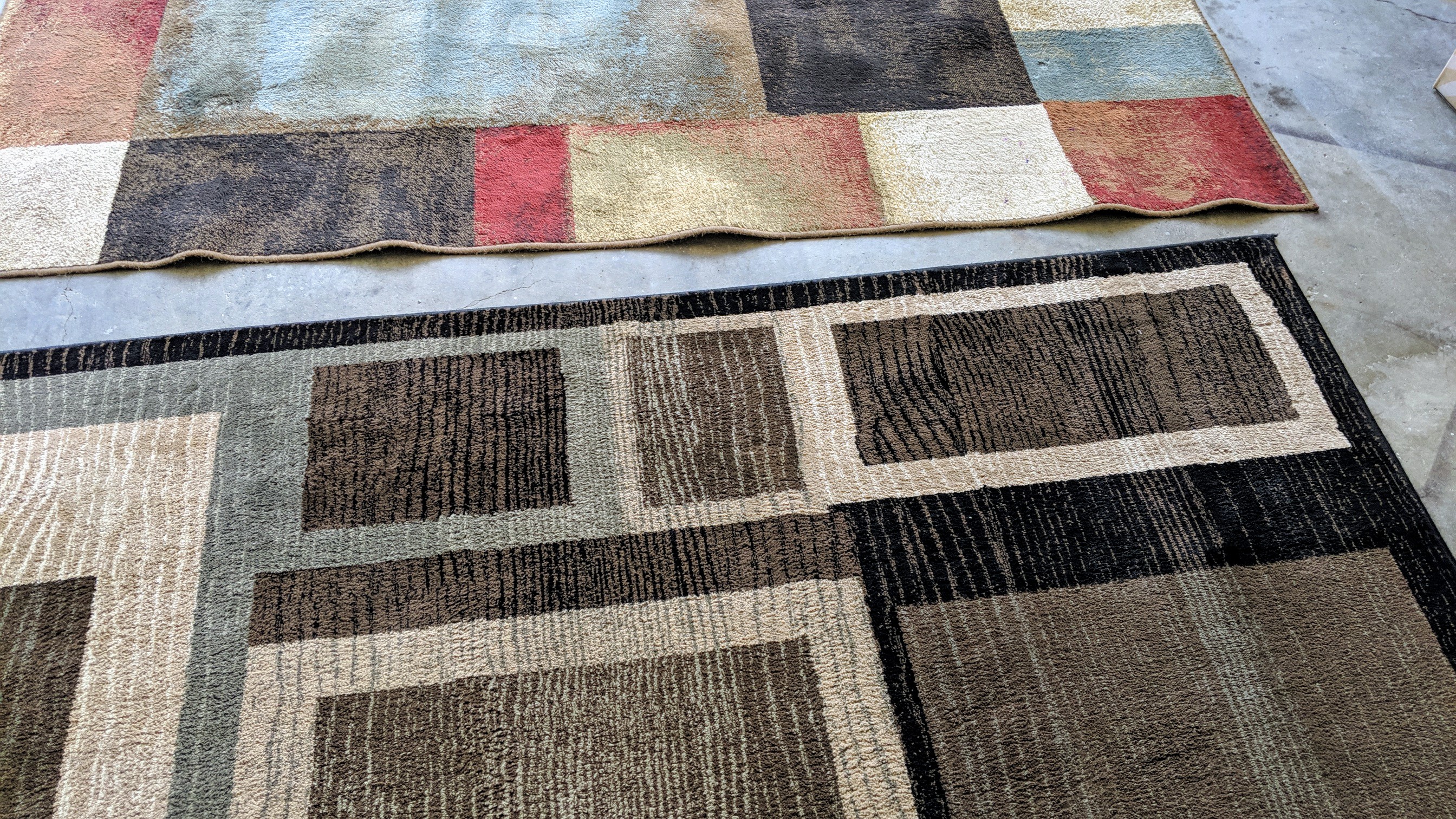

The ripple the second you Prespray them, I can't imagine how you've never seen this before
I have 2 hanging in the shop right now. Both 8x10's. No rippling. Maybe it's just happening on the thinner ones. I don't really notice in the shop. I think by the time they dry, any rippling goes away. Most of the olefin rugs I do have a binding. Unless there is something in the backing to cause shrinkage, it shouldn't ripple.

You may not be getting the rug wet enough. If it ripples when you prespray, it's because the wet part is pulling away from the dry parts. If it is wetted more thoroughly, I think you will have less problems. In the shop, we are usually prespraying, then shampooing with a 175, then rinsing. Even without a washpit, the rug is pretty uniformly wet. Although the yarn is olefin, chances are that there is cotton threads holding everything together. If it's unevenly wet, it will unevenly dry.

This is rarely a concern when properly washing these, when you hack these out using HWE it probably is more common.
I can't remember one not laying flat after washed and completely heat dried.
Maybe this is the proof some of you need to realize steam cleaning these in the driveway is not the best way....regardless if they're machine made synthetics....but that's crazy talk :biggrin:
