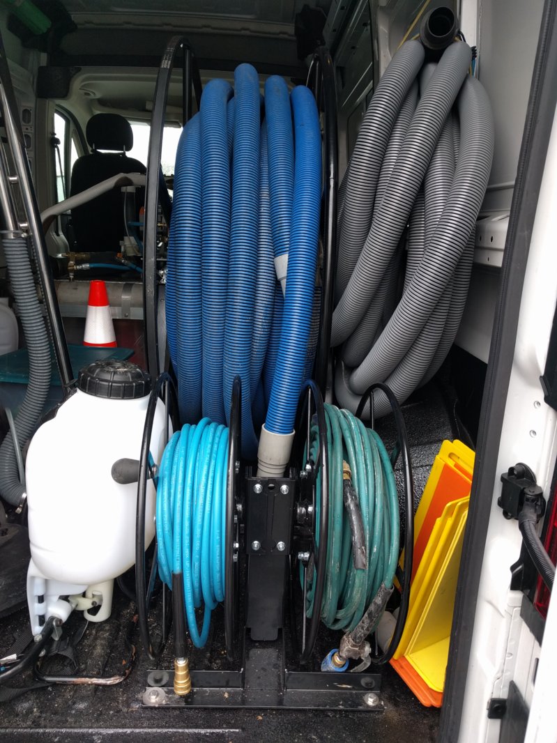

They look to be a better fit for mounting on the floor in front of the vacuum reel. A little wider and lower profile which - I think - would allow the vacuum hose to easily slide up and over the solution reel. The Rokan solution reels are narrower but taller and with the floor mounting bracket looks like it could get in the way when reeling in the vac hose. I have a fresh water tank so real estate is limited. I don't want to put the solution reel on the door so the most convenient place is directly in front of the vac reel. The reason I am moving the solution reel is to make it easier to get the Cimex, BrushPro, 175, etc. in and out of the van.
I really don't like that install, it fits but doesn't work so well in practical use.
Your vacuum hose will on occasion hit your solution hose when rolling up. It will become a pita.
No room to mount to the reel itself? We've modified some and made there own self standing post to mount the solution to. that's worked out pretty well on some installs when we can't mount without it being in the way.

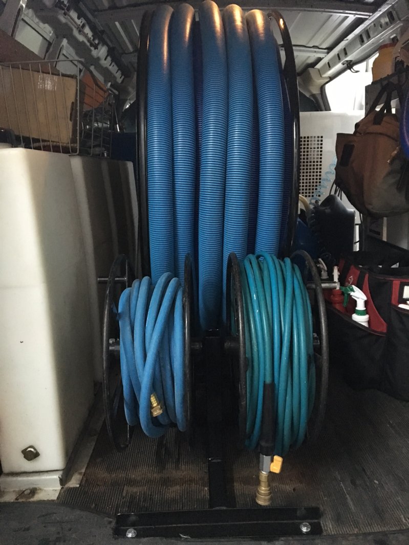

I recently purchased reels from Reel Innovations. They are a bit on the high side, but they are very nice reels. Mine is an electric vac reel and two solution reels mounted on the floor in front of the vac reel.

I did exactly what you want to do with my Rokans.
Do you want a picture?
Absolutely. Thanks.

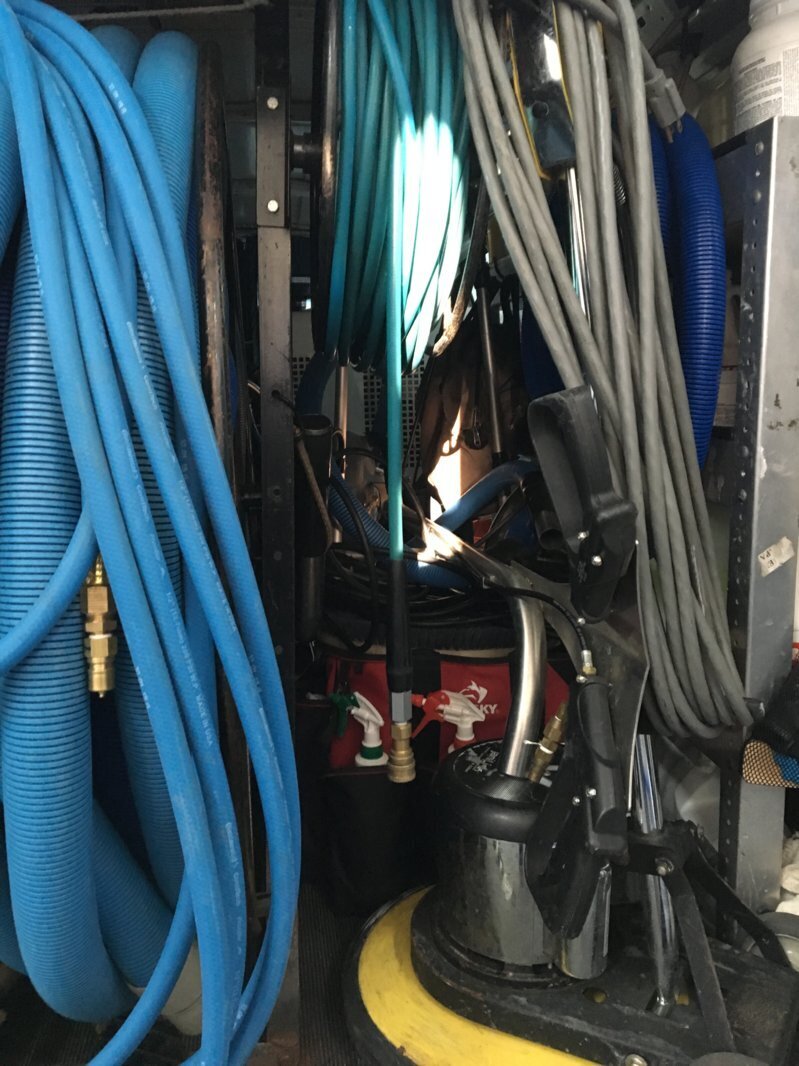

It's on the vac reel now which makes getting some of the floor machines in and out a pain. The water tank was mounted at the rear of the van (that's where it was when I bought it) so it pushes the vac reel over a couple of feet and puts the solution reel directly over the space for the floor machines.

If you mean a picture of the current set up, here it is. Headed to a job with carpet and tile & grout. Back to front, is the 175; carry-in bag with spotters, slides, towels, etc.; and BrushPro with SX-12 and SX-7. You can see how the solution reel gets in the way.
