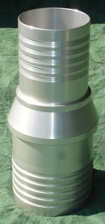

Here is a GG 2.5" Reducer:

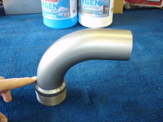

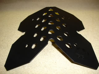

And a few other Butler parts to help with airflow:

Your looking for something like this right?
I haven't seen one made for 2.5" to 2"
Here is what most are using since most people use cool cuffs
Reducer
Then put a Male On that
The you can hook up your 2" hose like normal (running female to male)
Any questions call me and I'll hook you up or call Greenie he has a bunch of that stuff as well.
G
Greenie
One final note for Dale, you don't actually "need" any cuffs, the machined reducer I posted above can be inserted directly into the raw vacuum hose, this applies to both hose diameters, it would be a semi-permanent connection and very secure, it would also be very compact and hardly even visible.

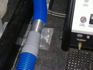

A simple reducer for 2.5 to 2, as per Greenie's instructions.
take Greenies aluminum reducer and jam it into the 2.5 hose
take the 2" coolcuff adaptor and jam it onto the reducer
It ain't coming off!!
Oh, when I say jam, I mean hammer! It took a fair bit of effort to fit it together. But it works great.
