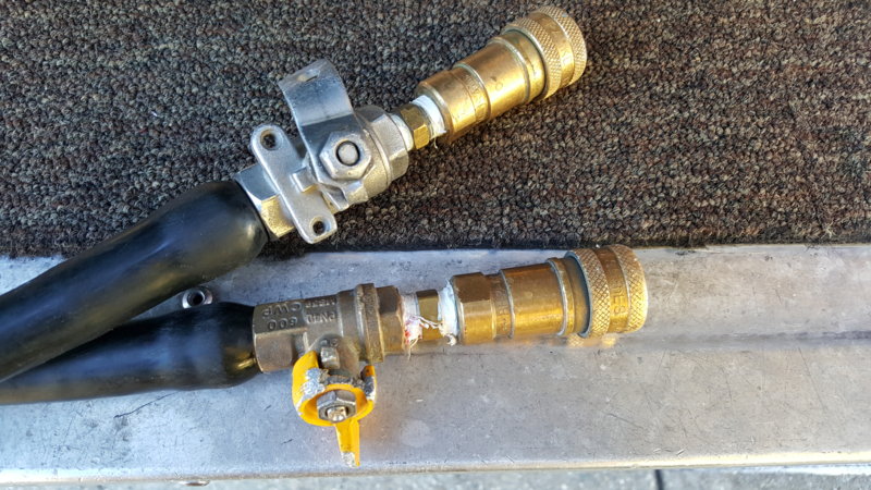

100 foot parker with bend restrictor spring and rubber sleave, Joe valve and female brass with plastic protector.

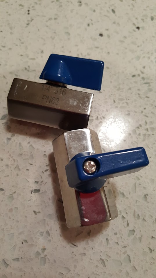

The problem with the red and blue ball valve have is the screw holding the handle comes out in 2-3 weeks and I have to glue it back in. After that they are good until the handle breaks off. The yellow Parker ones the plastic handle grinds down too fast for me.
Sometime I have to take them apart and put some pipe dope in them to keep them from leaking.
