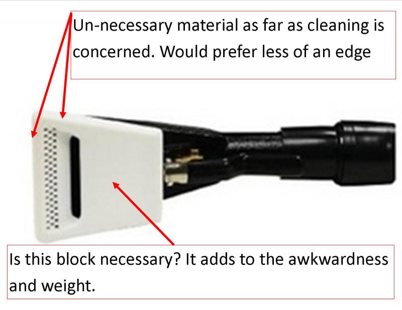

I'd like a plastic hydrokinetic tool. Use the head of either of those tools but put the face of the HK tool on it.
I was less impressed with the Hydrokinetic after seeing it at MF10. It look like it would do great on flat areas but appeared clunky and awkward for curves and edges. Cool tool but we wouldn't use it enough to justify its purchase.
I share Richard's conclusions and I know that the Hydrokinetic has worked well for you Ron.
It is too heavy and cumbersome. Can't reach tight areas & curves, not very maneuverable, very hard on the wrist. And too wide space at the edges that do not have any water going through.
If they could fix these issues it will become a very good tool, as it flushes really well.
Otherwise I would only buy it if I was a volume upholstery cleaner (kind of like a production line). One person will clean all the flat area with the Hydrokinetic (high production) and another person will deal with the harder to reach areas.
Reactions: Desk Jockey
They are close on it but as you mentioned Ofer, too much excess material on the head.
I'd like the head to be smaller and without the excess material. If I had a lot of fabric panels to clean it would be an excellent choice but with the curves and trim on upholstery, I'm afraid it would just sit in my upholstery tool bone yard.

Thanks for the comments on the Hydrokinetic. I will pass them along to our engineer. Redesign will be a future project.
Scott, please don't take them wrong. Its a very cool tool but could be so much better without all the extra width that seems to serve no purpose. I think smaller would also be more convenient while also reducing weight. As I said for flat surfaces like tapestries, fabric wall panels it would work excellent. I even wonder how well it would do with fringe. The curves and trim, I'd switch tools to catch.

Thanks Scott.
Please whisper (lovingly if you will) in the engineers' ears, that it may be highly beneficial to pass it by and talk to cleaners that actually use it on a daily basis.

What Richard says PLUS:
Head is a little too thick.
If you can arrange another jet (maybe on the back or I'm not sure how) that will allow for easy and effective misting that will be totally awesome.
