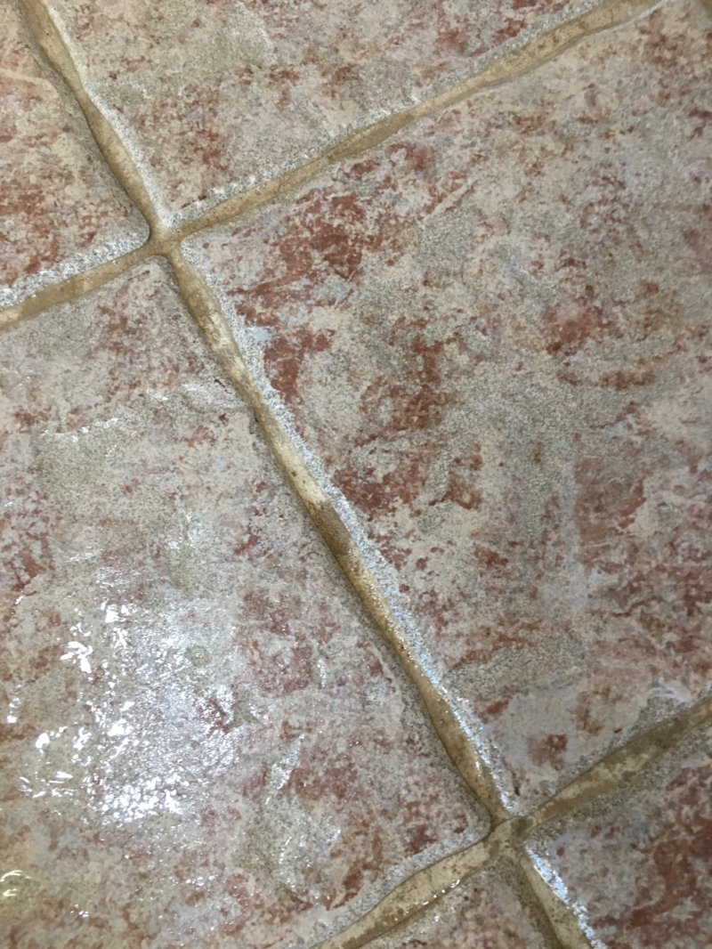

I don't know if it's just the camera angle but the grout looks like it's higher than the tile. And put down by a 3 year old.
116,057
the install is just how it should be. The tile's edges are un even in efforts to give it a stone paver look.
Too many cooks in that kitchen.

Why? because the edge is uneven?
Ok maybe it's just me then? The uneven edges make the job of wiping off the excess color much more difficult compared to a straight sharp edge. If you disagree with that then you must have a better technique than I do. Or a more steady hand? These take me twice as long to color seal.
