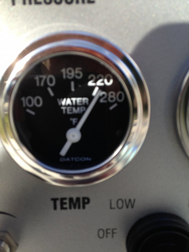

I'm loving it so far. I've only put about 10 hours on it. It's an awesome little machine. I have the APO with it too. It's hard to compare to the Blazer with Propane heat.
I would say the Blazer @75'probably feels like the 370 @150' but the Blazer Still cleaned good up to 150'. The heat has been good staying around 185-220 while cleaning 6 flow Prochem Quad Jet and around 50 degrees outside.

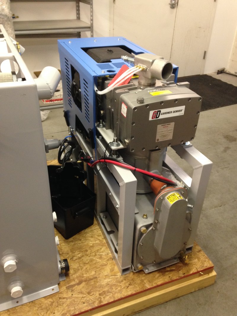

I didn't get a chance to compare them side by side but the 370 vacuum is definitely stronger. The air hollowing through the wand is much louder. I might need to think about ear plugs. the furthest I have ran is 150' so far around the back of the house and downstairs finished basement. The vacuum felt like it was still at full power and fast rise time. The machine sounds awesome too. Plus it sounds like it's running on medium compared to my Blazer. Motor runs 2800 RPM's the blower spins close to 3400 rpm's

The only downside to having the vacuum lube hose ran up high to the blower is that you have to make sure to clear the line or the WD 40 drains down into the lube cup on the front of the machine after you shut the machine off . It doesn't drip down the front of the machine it stays in the lube cup so its not a big deal
I though it was blower oil at first but now I know to clear the line. I didn't think the blower was getting lubed so it was easy to check by spraying WD40 in the lube port and watching it travel through the clear hose up to the blower.

The lube cap has a little rubber seal, but when I wd my blower I like to stick The straw into The small hole pull The trigger for 10 seconds then let off the trigger so the vac pulls the wd threw the fill line so it doesn't drip when you go to lube it again. The rage seems to pull the lube better if you block the vac port while your doing it. I wd at full throttle then idle it down about 5 seconds after letting off the trigger, then I just shut it off. Try to wd40 when the blower is cool, like when You have driven home do It at the end of the day.
After 50-100 hrs get the valves readjusted and do it once or twice a year. Keeps it running smooth.
