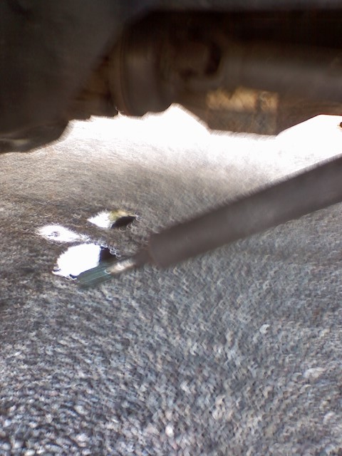

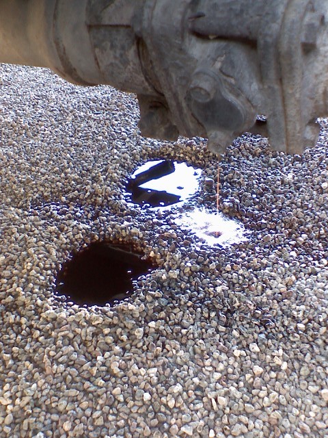

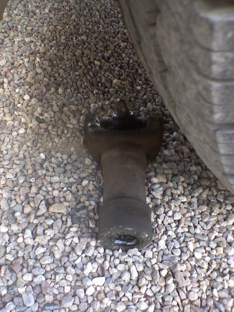

I would rather have a U joint break than a shaft.
shaft....U-joint.....it does not matter...when you have a load on that thing and it lets go...all living hell is going to break loose and you had better bet your not near it.....

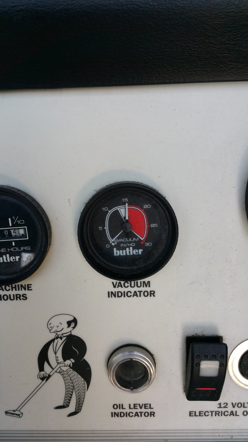

We can crank the valve down to get to 16hg.
But why? To make the wand harder to pull? Better for your body?
How much suction do you need.

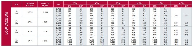

Marty I agree the 13 seems low but running the truck I will say it
and that 14" hg needs 20 brake horse power and the pump needs a cool 4-5 brake horse power at high-pressure cleaning.
so the question is - does that truckmount run a 29 horse power motor at 80 something percent load? i say 80 something as the is a small percentage of loss though transfer of power.
you should be dropping engines every 1500-2500 hours or less at that strain on the motor.
so i don't see why you think 13" is low, more like 13" is good and very safe to ensure long mechanical life and maintenance intervals.
you need to run this thing and try it as it may have the same 570 frame and other goodies but it has way more power being trasnfered to the blower and pump. also there is something special going on with how close the blower is to the waste tank and how it is connected.
you just have to feel it. i was initially impressed would love to actually use one on some jobs.
