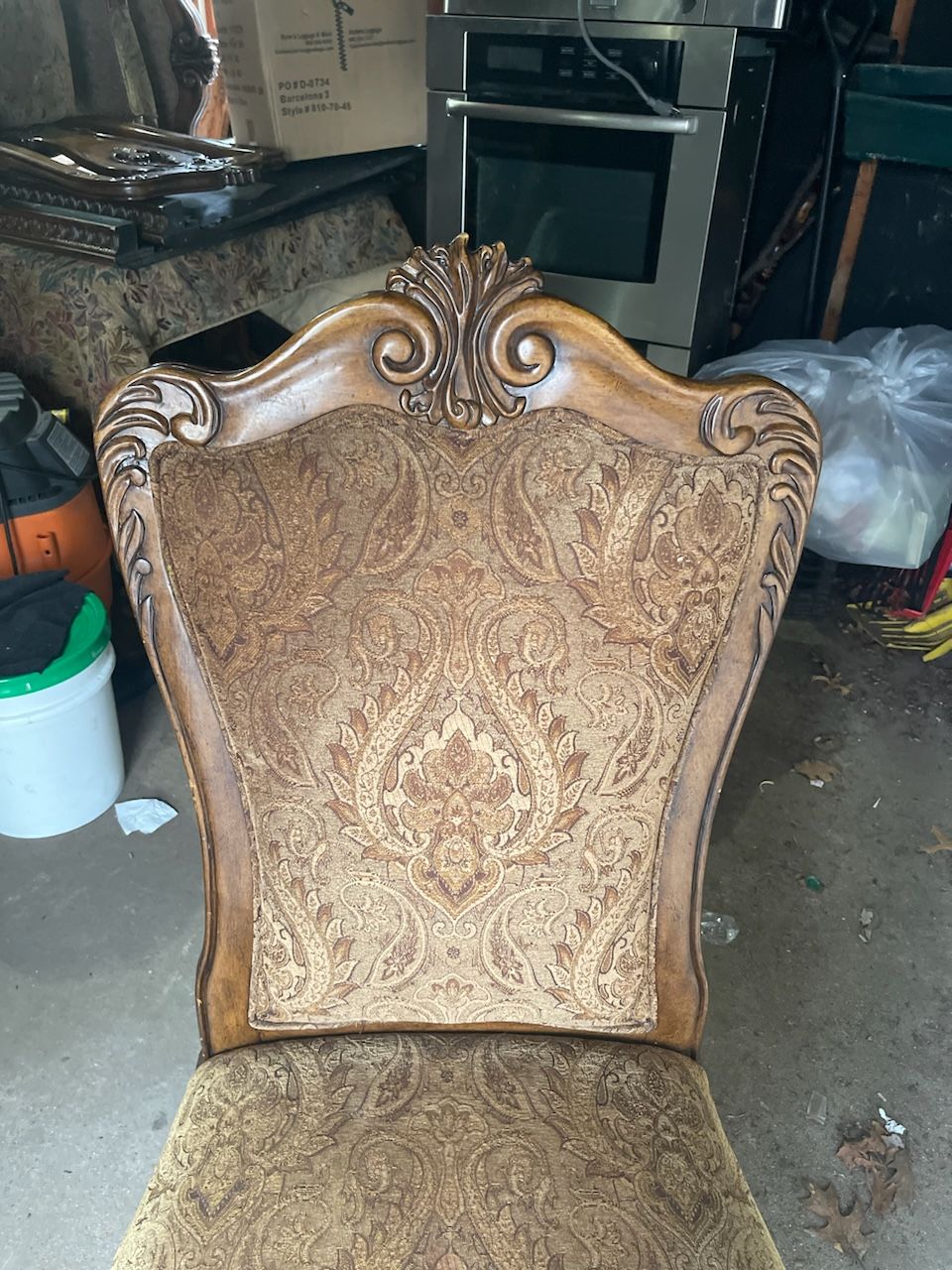

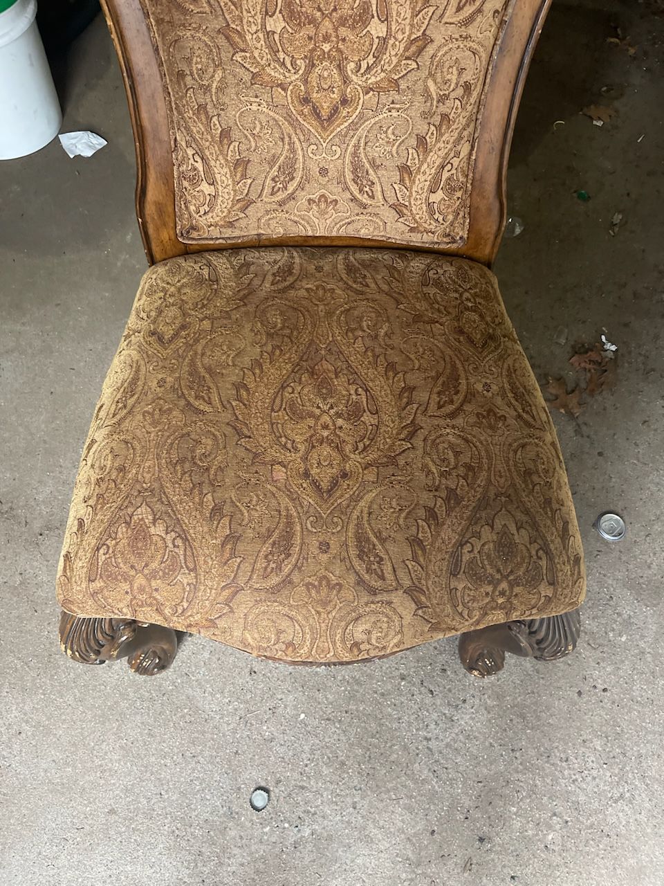

These.
Do those dark regions look like browning or soil? Dampen a cotton rag with an acid rinse and weigh it down on the dark region for a bit to see if it pulls brown to identify the cause of discoloration?

I'm sure it's unlikely, but are you able to get a piece of fiber from an inconspicuous area?
Do you know if the customer ever attempted to clean them?

Its hard to tell from the pics, but it looks like something hungover the back of the chair and it sat like that for a period or time. Possibly could even be some UV damage.
You're more than likely going to need to treat the fibers as a natural fiber. I wouldn't worry about trying to do any type of PH test on the dark areas.
If it were me, I would hit them with a VLM approach to start with. I would start with Encapuclean Green DS and a hand buffing tool if you think the fiber is strong enough to handle it. If it does seem weak or brittle than carefully horsehair and hand towel. The PH is almost neutral in this product and should help correct any ph shifting and help limit any bleeding.(I don't think bleeding will be an issue, but you can always DyeLock) It will also help limit reactivating anything stinky in the cushion.
If you think you will need to HWE these chairs, I highly recommend the Avenge products from Bridgepoint or Prochem Upholstery products and rinse ( The liquid versions).
Air movers to speed dry on either process.
