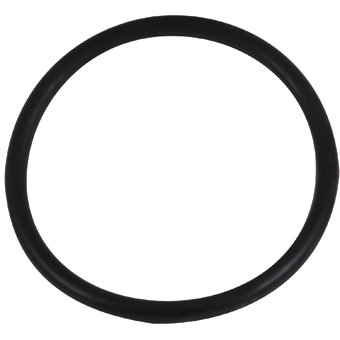

If you are talking about these things, they suck. The belt and where you put it is round/smooth.
So when it stretches a little bit it has nothing to grab onto and slips.
