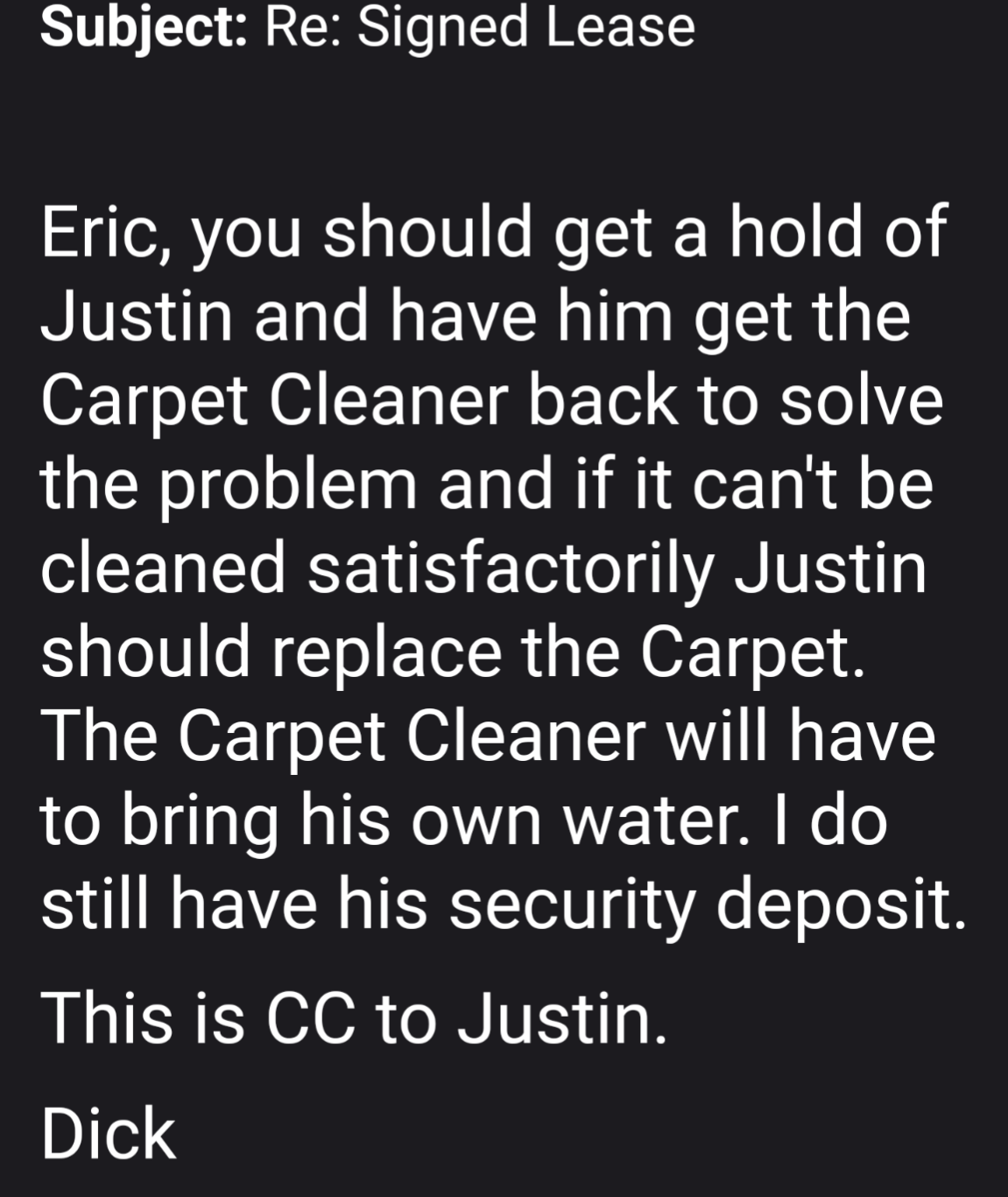

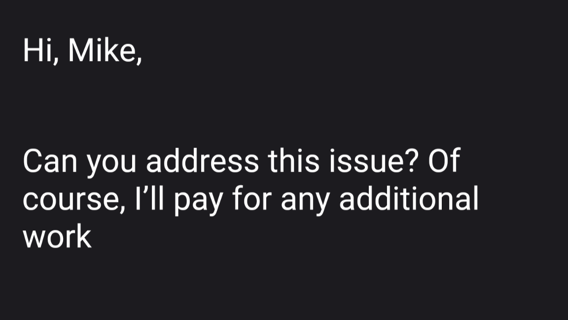

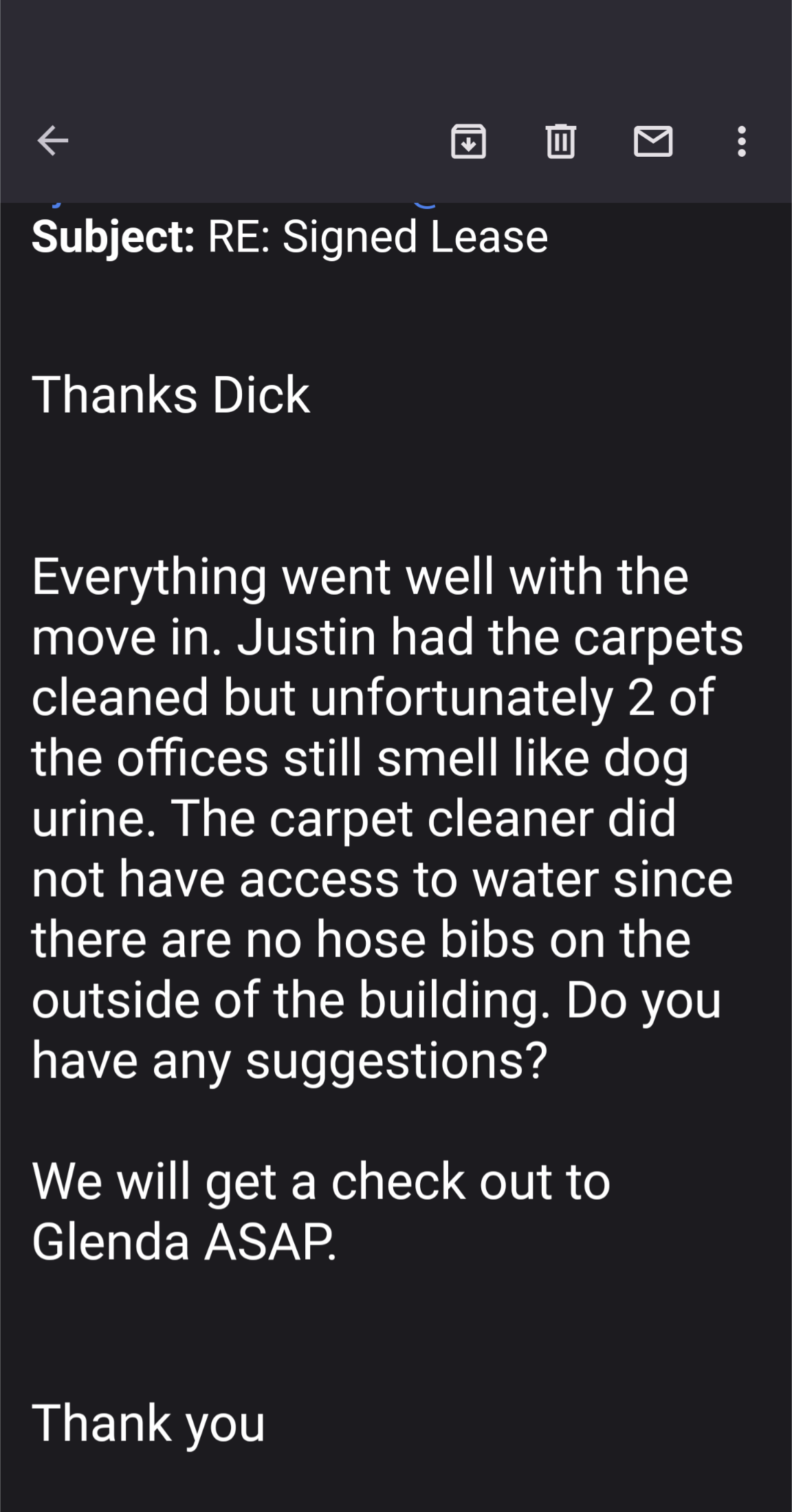

Two banana sized sos showed up under UV inspection.
I couldn't smell anything.
Padded as normal.
What would you do on the return visit?
12,661
I'm unclear on a few things:
"Two of the offices still smell like dog urine"....Urine in an office carpet? If this isn't a veternarian, WTH is a dog doing in there? (Besides urinating)
Glue down or stretched over pad?
I know how you feel about urine decontamination, so I guess it is also a question of what you want to do versus what you can do.

I'm still trying to wrap my head around dog urine on the carpet in a lawyer's office.
Are you sure it isn't human urine from when they get the bill for their services?
That much urine (banana sized) on a glue down carpet is going to need a sufficient amount of product applied, pushed down into the backing with your wand with no vacuum hose attached, then extraction after it has had time to work (however the product of your choice works).
If you just want to do what you've already done, and they seem open to replacing it, you have your answer.

Jesus carries one of these
if water is on and there's a bathroom or sink, the above fits 95% of faucets.
There's one other thread adapter for the above that fits the other 4.299% of faucets (occasionally found in com/med offices)
Jesus might have those in his pocket, but he walks on water, remember 🤷🏼‍♂️ No prob for him, but for the rest of us, it’s why we carry water. Another option.

Well it turns out it wasn't their carpet that was stinking but rather the office that is sublease that I did not clean but fortunately had a glass door and when we inspected it with the pp 5000 nearly the whole room was...
