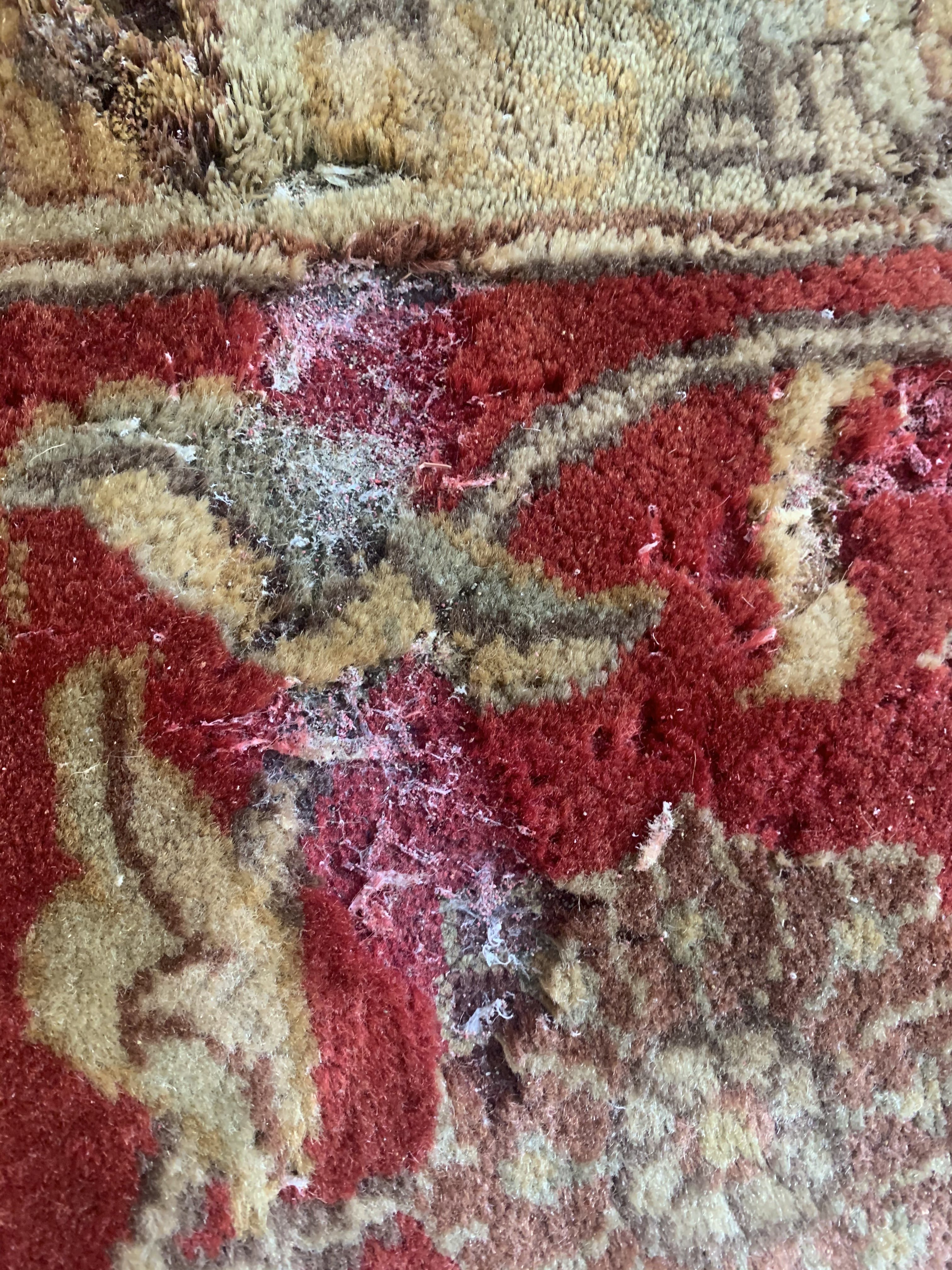

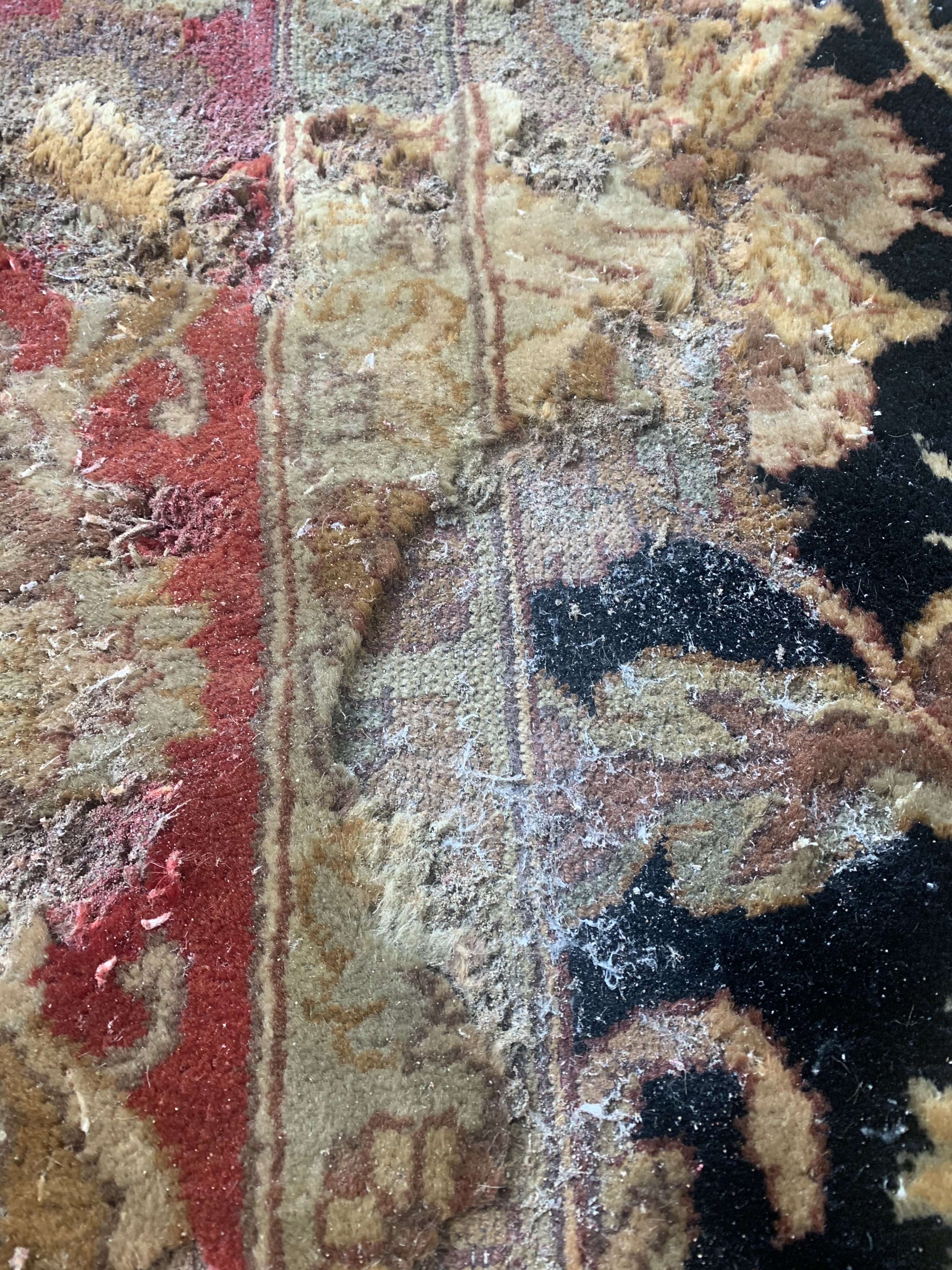

I got a 12x12 wool rug coming in. Its loaded with moth larvae or bugs that are eating it. I’m going to throw it in my big chest freezer for a week. Any suggestions on a chemical this should be treated with? Also the guy wants to knownif I can repair it. @Brian H , want to work something out and I’ll ship it to you if he wants to make it happen?

Sure, we can do it. We will need to see pictures to see if it's even worth it or not though.
And just freeze the moth larvae for a week. Take it outside, let it warm up, vacuum it and put it back in for a week.
I'll get more pics loaded once I get it. Not sure if you saw the pics I loaded in my OP. I loaded them later.
