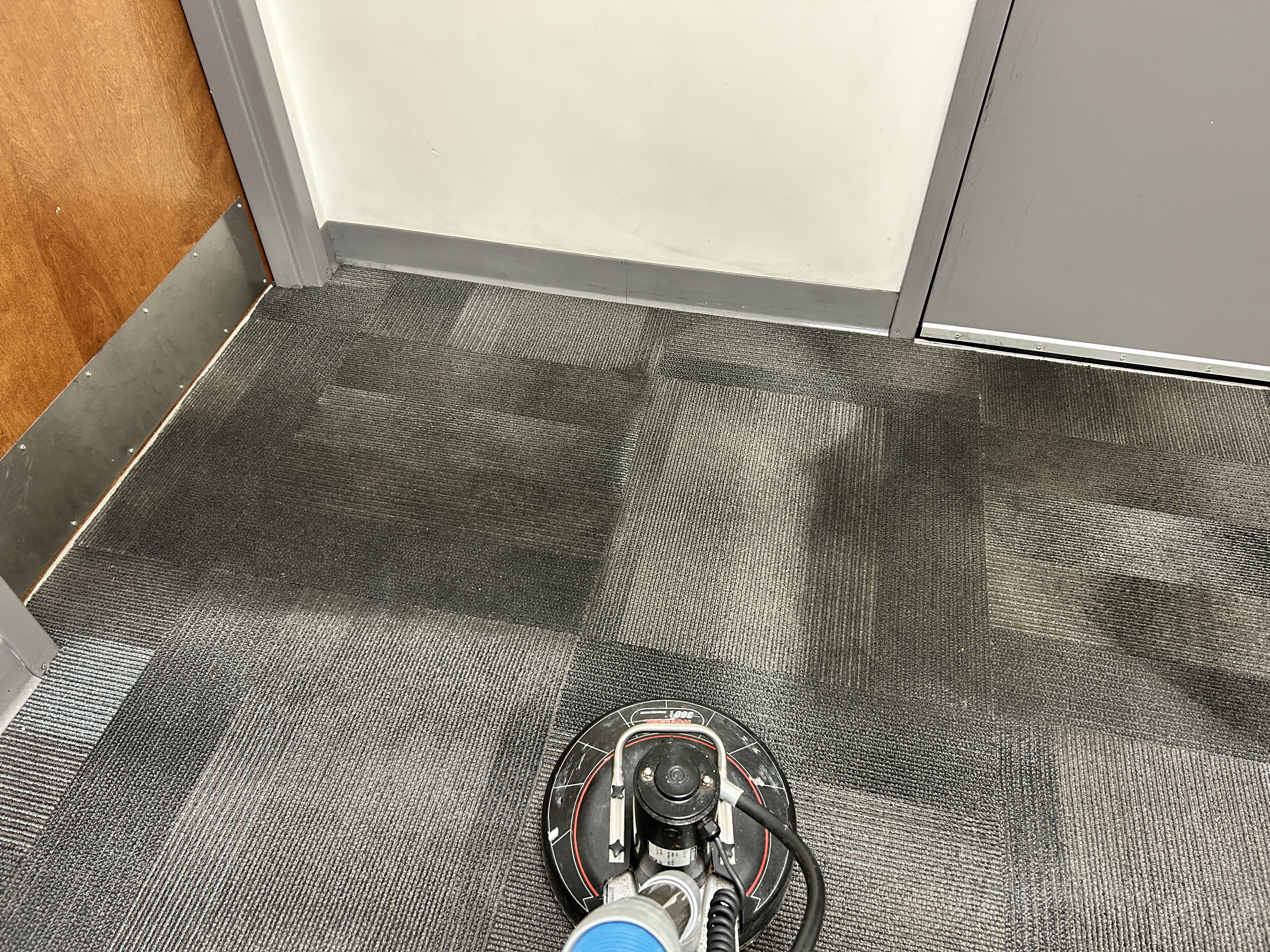

I dual'd my UPS store.
Vac'd
Sprayed UPE
Scrubed with a blue 3M and the PHX
AW/ afr rinse
Post pad with Glads.
Left fans.
Looked better than expected the next day.

I can have commercial carpet dry in >4hrs usually with 600 psi and the zipper
I would like to post bonnet that would be interesting
You can always get a pad dirty. You can pad your life away in the same spot and the pad will always be dirty. I’m not knocking the idea. It’s just not for me. Not anymore that is. I understand.

That is pretty dirty. The pad will remove a little more soiling. I doubt it would affect the dry time much. Best thing for dry time reduction would fans. The pad would work best after it dries.

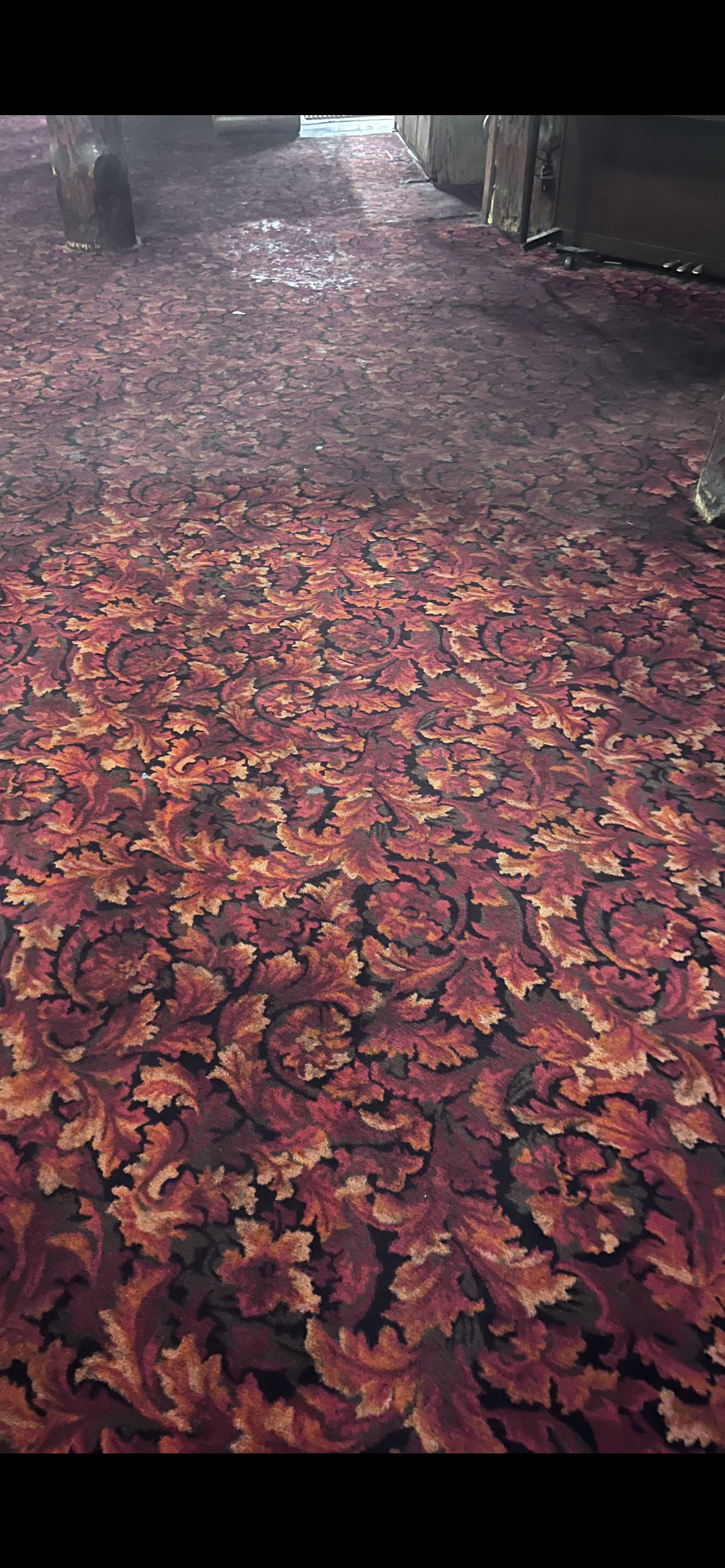

It looks like a casino I did tuesday at 6am same type of carpet all the black was from spilled drinks when they get excited when they win. I could only pad clean it they open at 9am . They were very happy I would love to truckmount it but no drying time .Sorry I dont know how to show pictures.

Ya the picture I showed was just zippered in front of where it’s clean at 600psi once I hit grease I have to slow down and repeated wet passes ect
