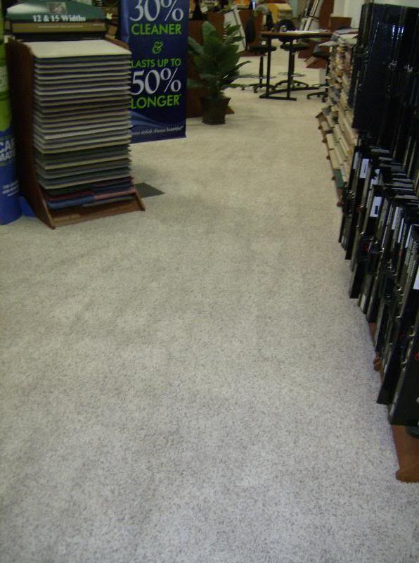

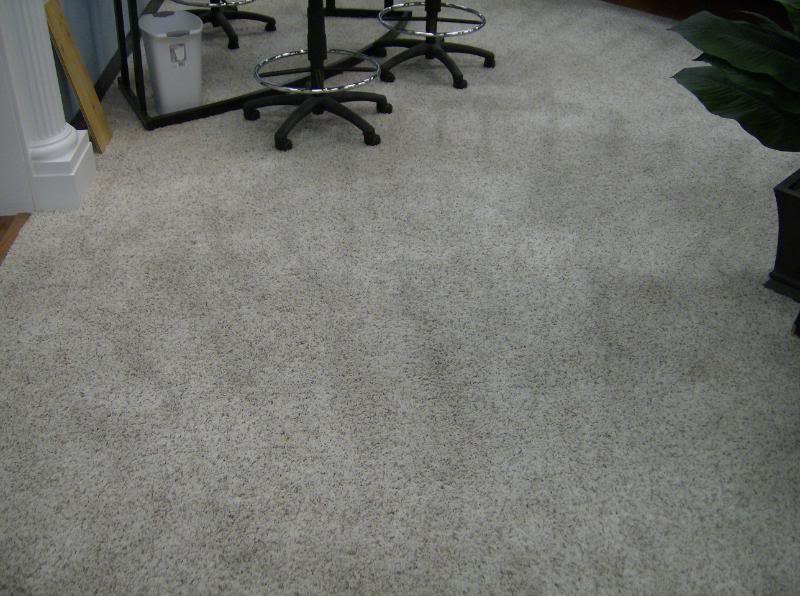

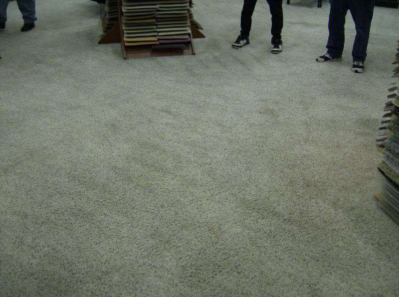

Either no over lap with a Rotovac origional and or no grooming leaving the pile shifted in another direction. And if the job was done with emulsifier only in the origional (if it was some other company that did the job) and probably did it that way as fast as possible to get the price down for a cheap customer. It may of just needed grooming even if it wasn't over lapped. But it's hard to really tell from the picture...a white towel test would of told the tale.

it was vacuumed 5 or more times, grooming would not have helped at all..when he first called me about it i brought in a general spotter and a terry towel gave it a squirt and rub and it was really dirty with no effort at all.
you can look at the pics closely and see the missed dirt lines..no amount of grooming would have fixed this or even made a difference.
he was doing it for free so i am sure he rushed through it, i dont think he takes and pride in what he does..i would smash the shit out of one of my guys for doing anything like that..it is best effort or nothing here, we have no in between it is all about pride in doing honest quality work and doing the best you can no matter what the situation.
that's why I said the white towel test would tell the tale. That would of a been a good compliment to the pictures to show us how dirty it really was.
