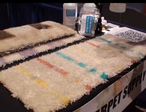

We use several of them for removing Dye Stains:
Nothing more effective on any synthetic or disperse dye spot . . .
with an experienced technician . . .
Video Link : http://bcove.me/j2bzbqag

Exactly, all the steps are not required .
The video in post #2 above showed removal of three aged food color dye stains
in about 40 seconds.

Another couple questions:
#4 under Usage says when stain is 80% removed; extract and rinse with warm water.
WHY 80%
#6 says due to limited shelf life, we are including enough reactivation powder for several reactivations
but no powder included nor any instructions on when it is necessary to reactivate.
#4 We say when the stain is 80% removed to start the rinsing process. The reducing action will continue to remove the last 20% of the stain.
#6 Currently, we recommend activation when you 1st use the product. Then every week or whenever the results are less than expected.
We do not recommend heat with normal spotting.
and acids DO NOT accelerate this reducer.
Note: We also have this strong reducing agent in a powder from with less odor.
