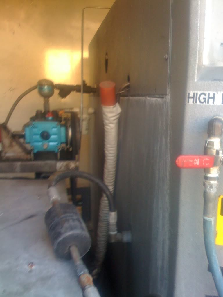

This is what i have to start with, if you get nautious easliy you will not want to look at the pictures on this thread. VIEWER DISCRESSION ADVISED!

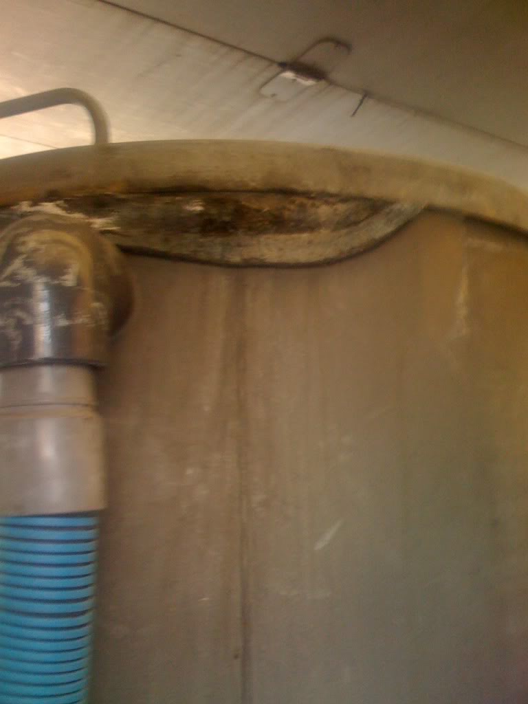

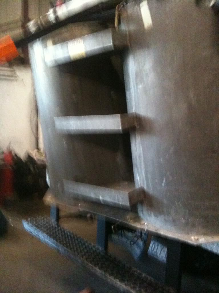

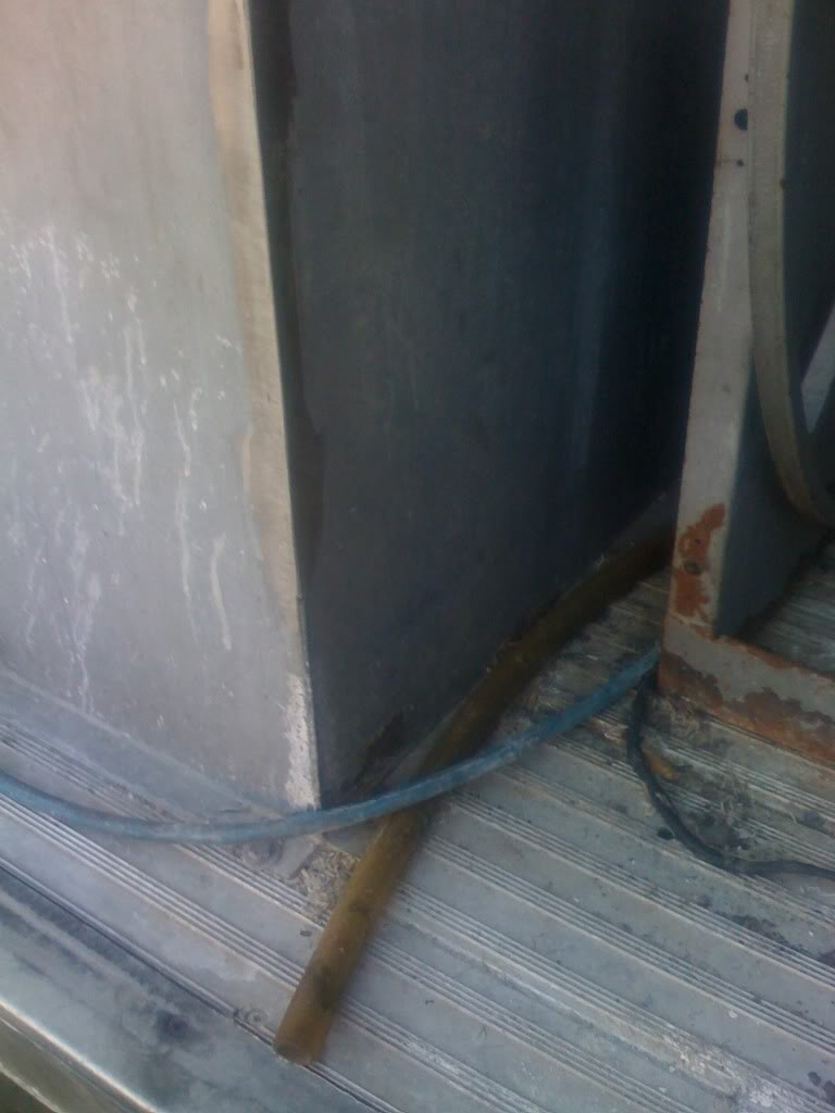

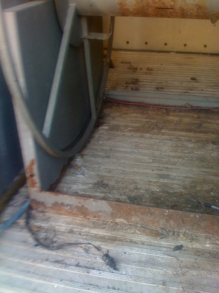

first thing i usaually do is pull the waste tanks. just removes the bolts around the base of te tanks. if you have a venturi unit these bolts might have to be cut off, as they replaced them with non stainless in two of my trucks. also remove waste tank lids to take some of the wieght of the tanks. remove blower plumbing coming into waste tank and remove or unplug the wiring for the highlevel shut off.

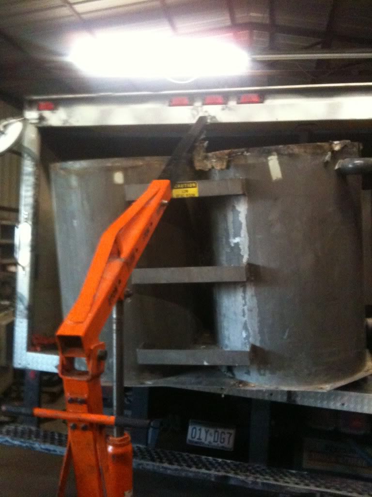

i use an engine lift to pull mine as i found it easy to do and could do it by my self. on the round tanks i just used a chain to straddle the connecting tube at the top of the two tanks as my lift point.

Use 1/2" black heater core hose, in the rim of the lids. Works great!!
