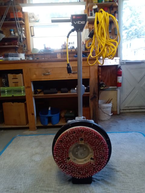

I have a chance to get a few large VLM jobs. Having done HWE on medium sized commercial jobs has worked so far but will not work for this property. Walked one of them today and its not possible to use my truck mount. Ive read pretty good reviews here about the Orbot Vibe and I may be able to pick up a used one locally for decent price. A few questions. Still a good enough machine? How many sq ft per hour should I expect to be able to clean? No offices or stuff to move. Mainly hallways and open rooms. Light to medium soil level. How many pads should I expect to use per 8 hr day? What pad should I be looking at getting? I never expected to go to the dark side, yet here I am. The money would be very hard to pass up on this.

You should easily be able to do 2000 sqft per hour. I would use microfiber pads. I prefer an oxy encap for most of my work but bring a solvent based spotter for greasy spots. Conversely, you could use a high pH encap and bring an oxy spotter for coffee or beverage stains.

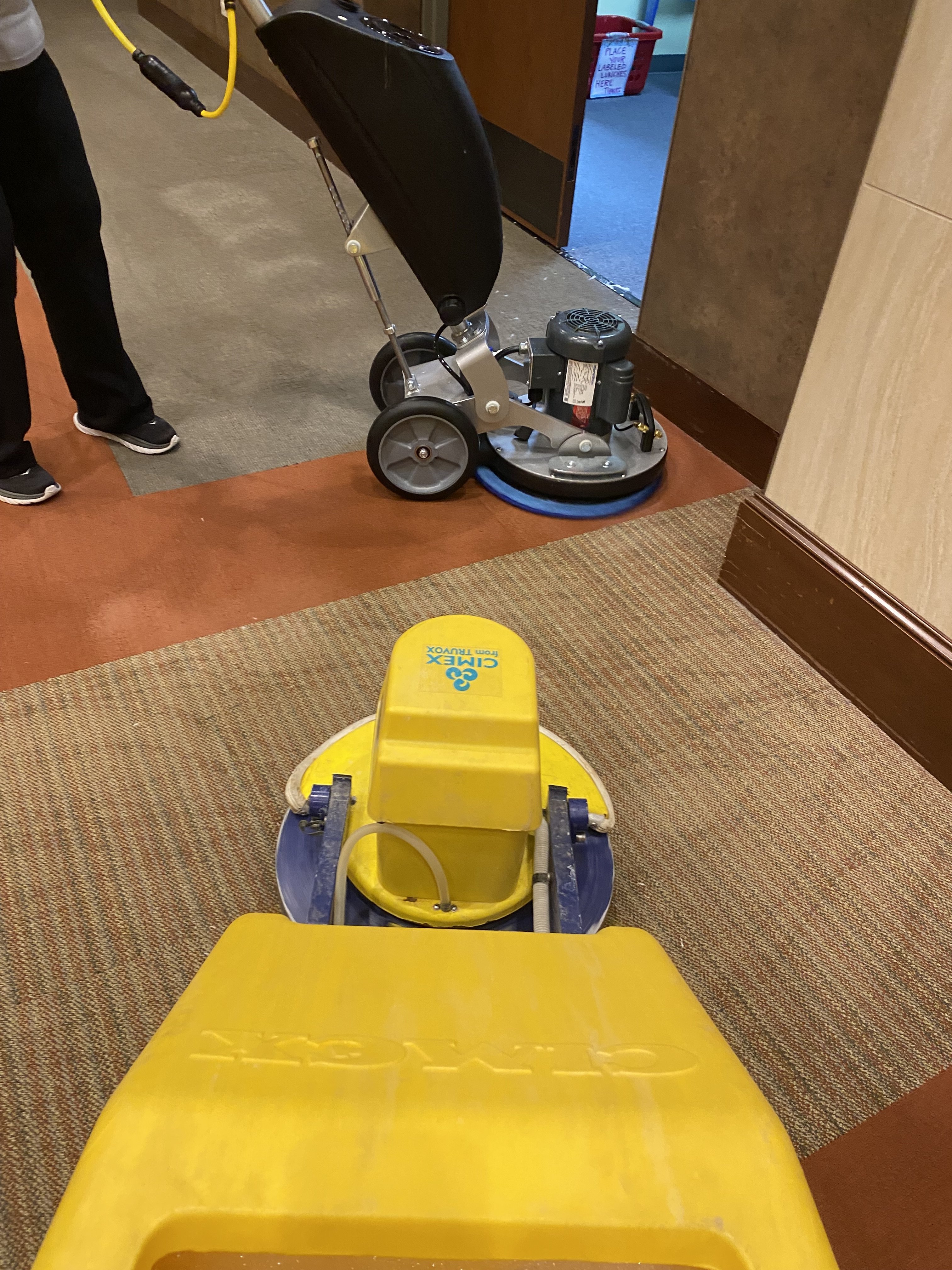

Cimex is a great scrubber but that's it. It doesn't remove any soil unless you post vacuum
I bought a new Cimex about 12-13 years ago used it once and sold it. All the coffee stains came back because it put down too much solution. It wet the carpet too much. I don't consider a Cimex low moisture cleaning. It uses too much solution. Of course I would have gotten better and learned how to use it better if I used it more but I didn't like it. Plus it's TOO big and TOO heavy
9,250
Yukon, Oklahoma
That’s too bad for you. Too bad someone didn’t show you how to use it. You can control the solution output like a foot pedal on a car. Who said anything about not pre vacuuming. The Vibe can be used for post padding if you have both. It’s certainly not misinformation.

Trio is definitely VERY LOW MOISTURE cleaning. It puts down a fine mist in front of 3 brushes with 75 pounds sitting on top of the 3 brushes. 15-30 minute dry times. It's a excellent scrubber

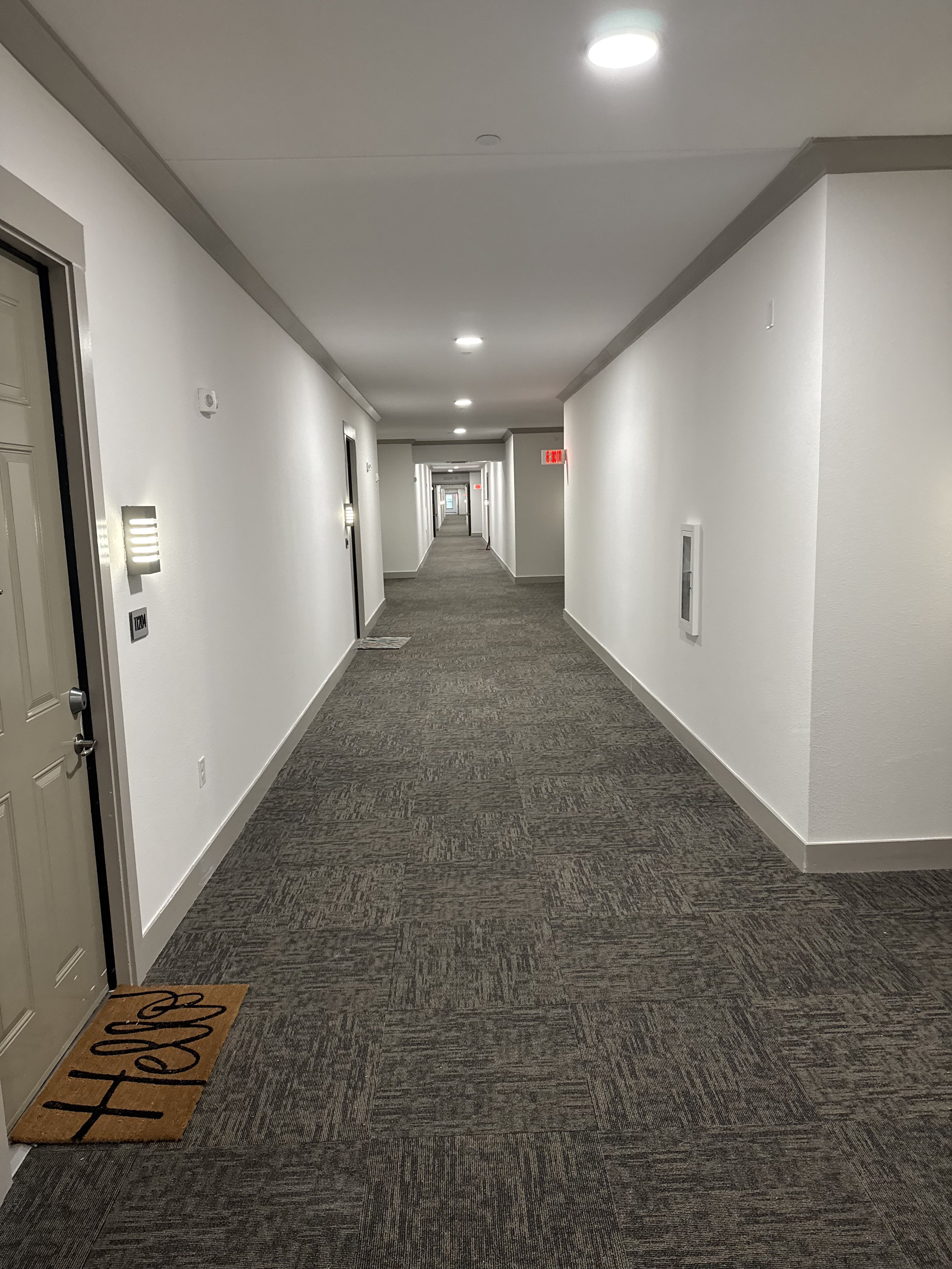

If it's all in that condition...
You can buy these from me or Rick but Direct Mop Sales is the imposter..
500 sf per side on that floor.
19"

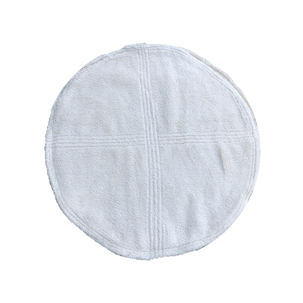

If there are worse areas you'll want to pre scrub it when a brown 3M Fiber Pad, use the microfiber than follow up with a Glad Pad, which is a cotton blend that absorbs that gunk that the MF won't...
Both are here in 21"

I would start with the 19 inch microfiber pads. On light to medium soil, you can get 400-700 sqft. You can use both sides of the pads when new or newish. Once they get too floppy from repeated use and washing, I usually only use 1 side.
